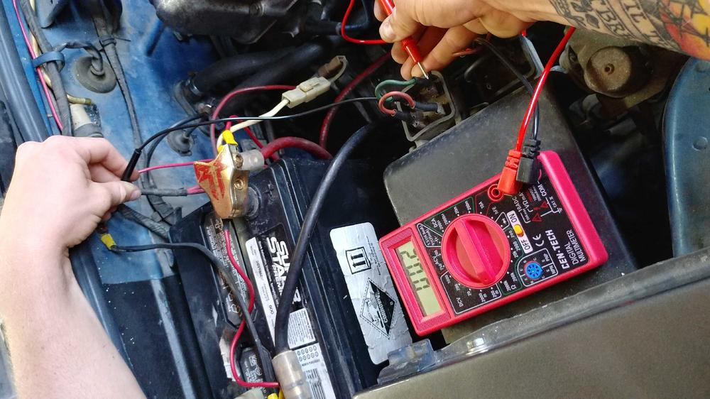

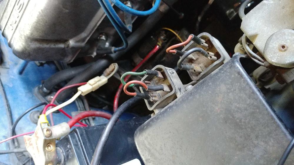

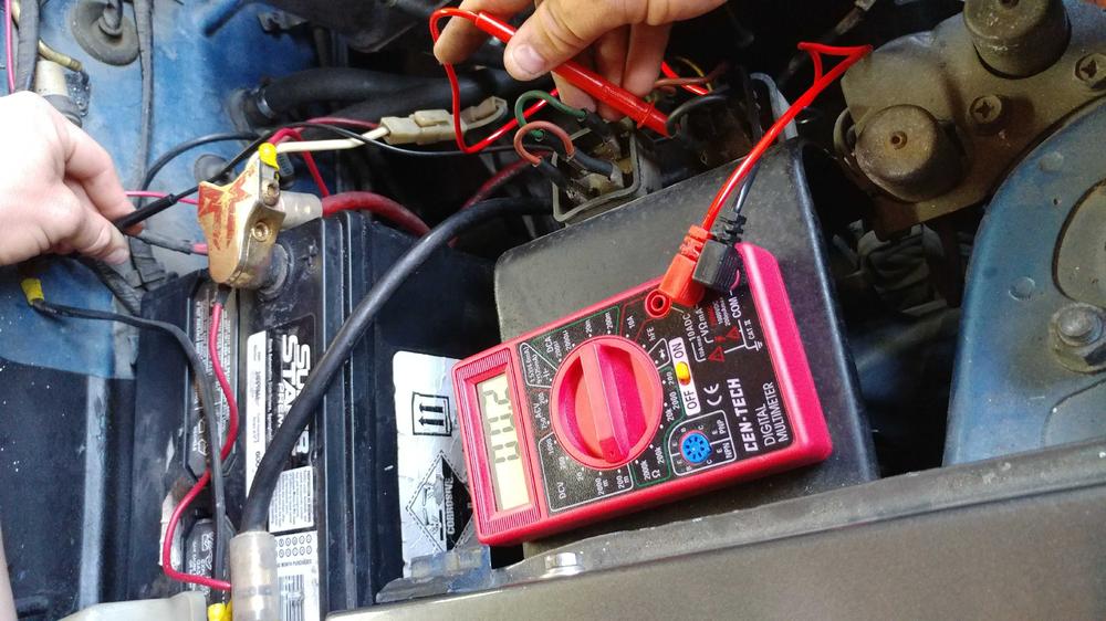

confirm you are comparing the chassis (negative) to all the fuse link connections under the plastic housing under the hood. NONE show 12v? is there TWO fuse link boxes or just one, I know my early 75 only has one box.
you should post of a pic of what you are doing.

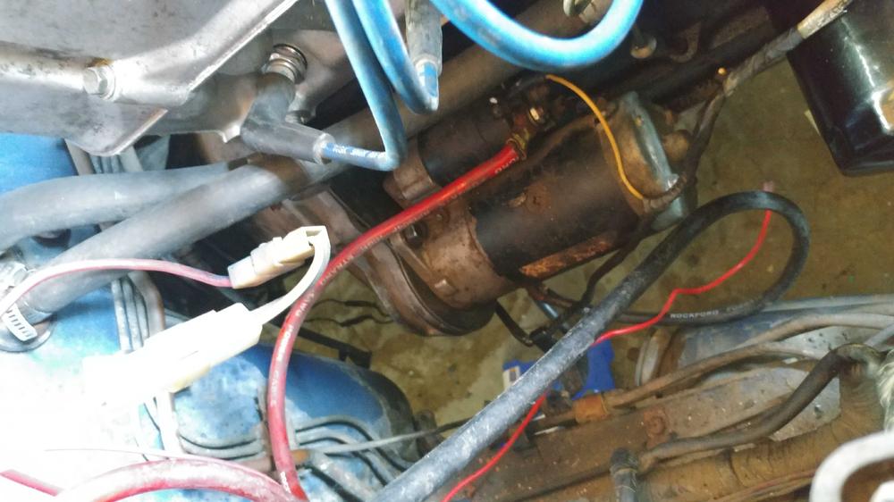

you should have a large neg battery cable terminated at the starter mount bolt.
you should have a large Pos battery cable terminated at the starter solenoid. that same junction should have a medium sized (guessing here maybe 5 to 6 gauge) wire that go back in to the wire harness (and ends up a one of the fuse link boxes).
of course you should have a spade connector that plugs into the solenoid to activate the starter (I can see that).
