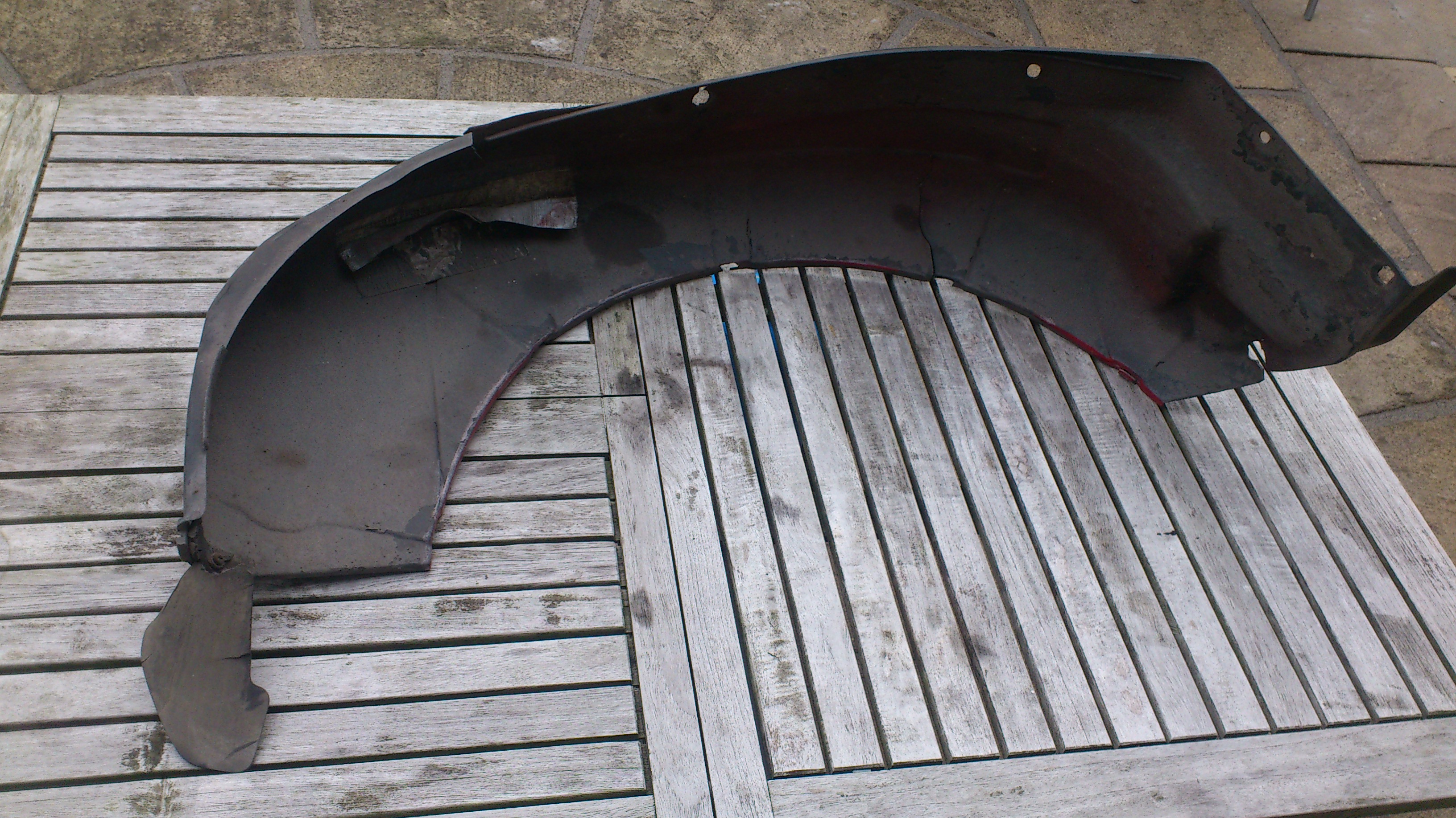

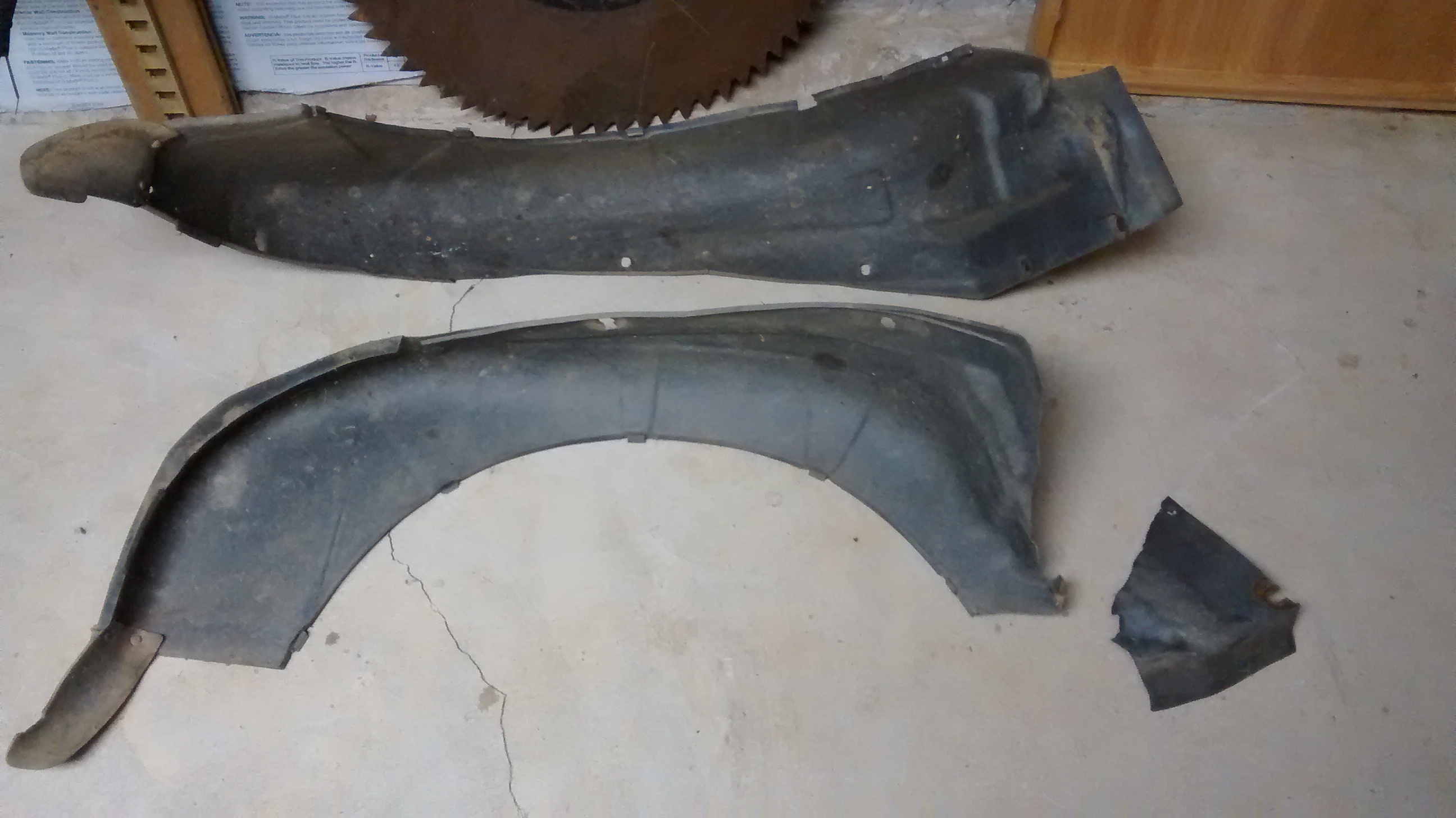

This is what they look like. Different to the 240Z version.

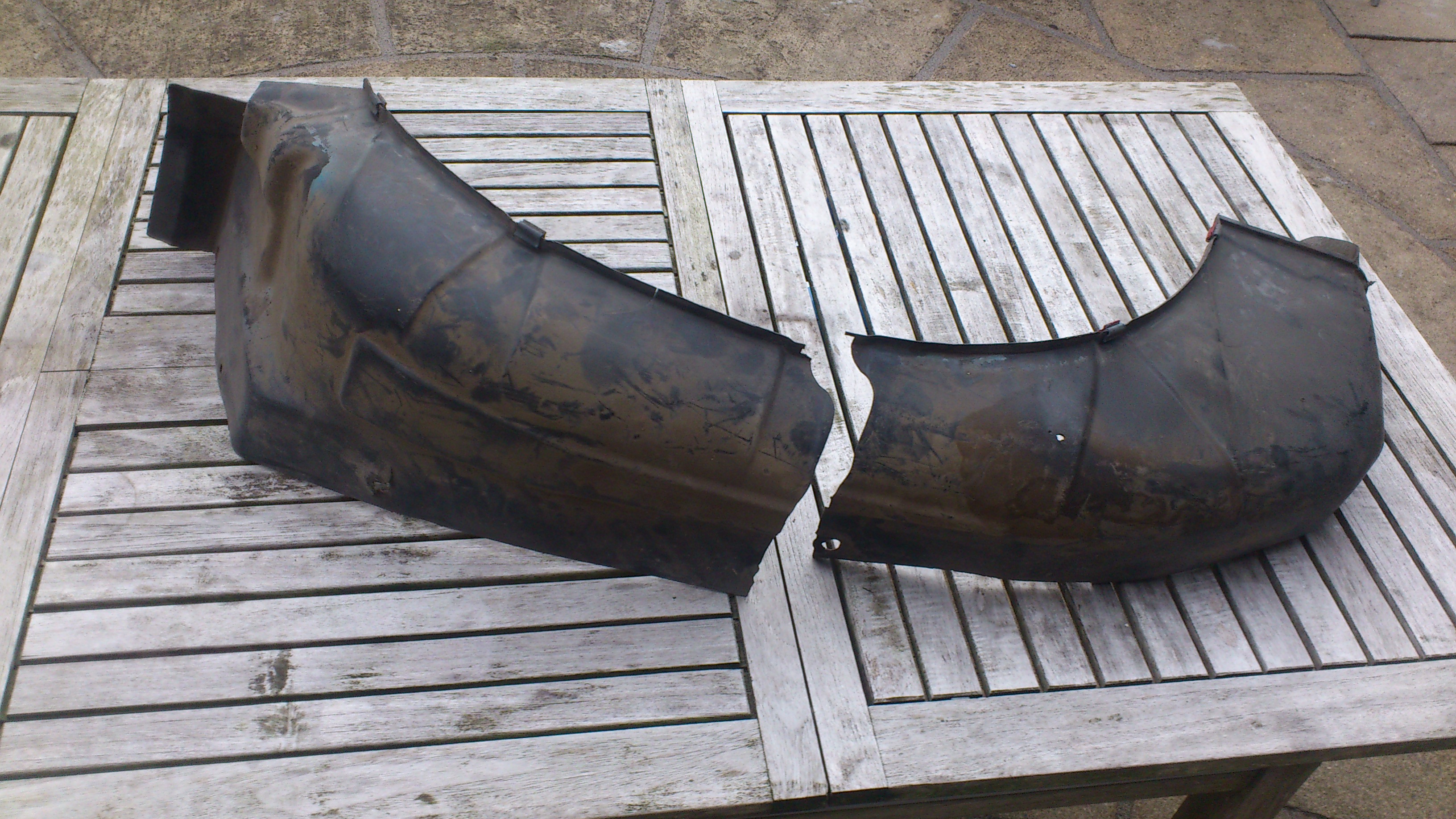

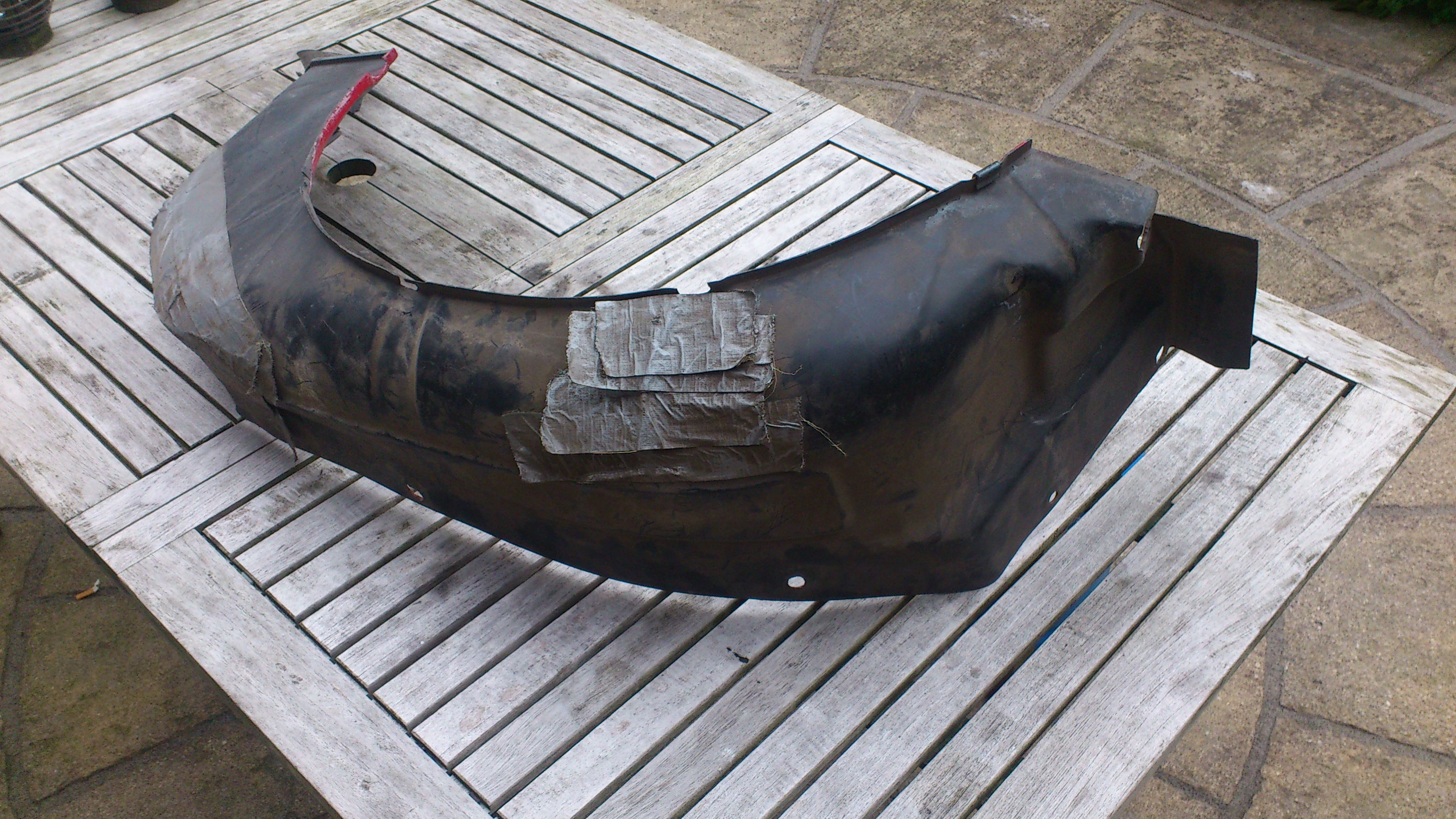

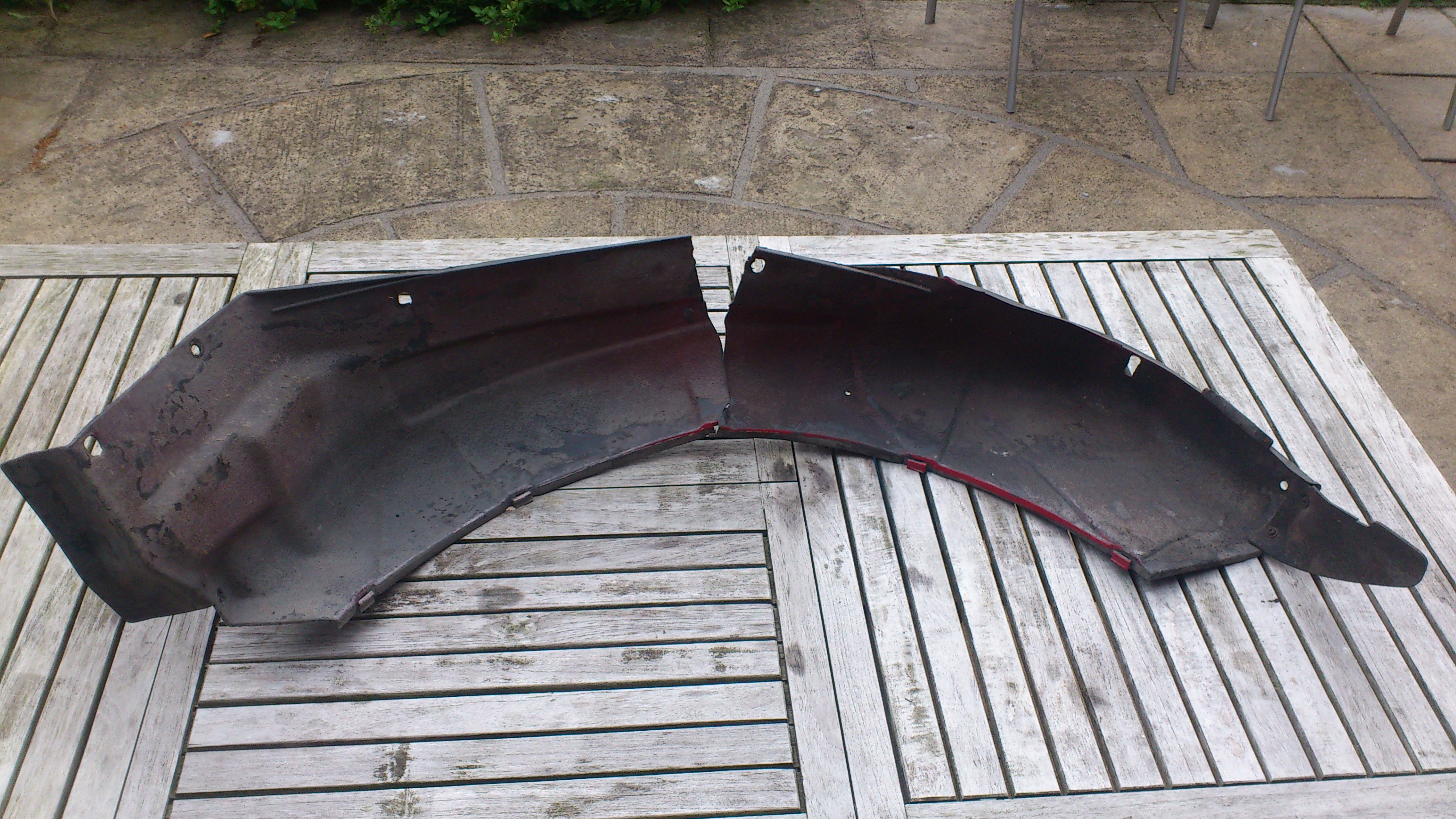

Im debating repairing these so I could make a mold and then make a new set out of fibreglass. It's way down on my "to do list".
Finding a set in good condition will be hard.
Heads up: fiberglass and ABS cement is not a great repair here. I just tried it a couple weeks ago when I pulled the fenders. Whatever plastic Nissan used to make those liners isn't ABS. Solvents like acetone and MEK won't touch it. I suspect it's probably polyethylene or something similar, which is notoriously hard to bond to. Regular polyester fiberglass resin would probably be better: it won't bond chemically, but if you scuff it up first might grip well enough to hold it together.
