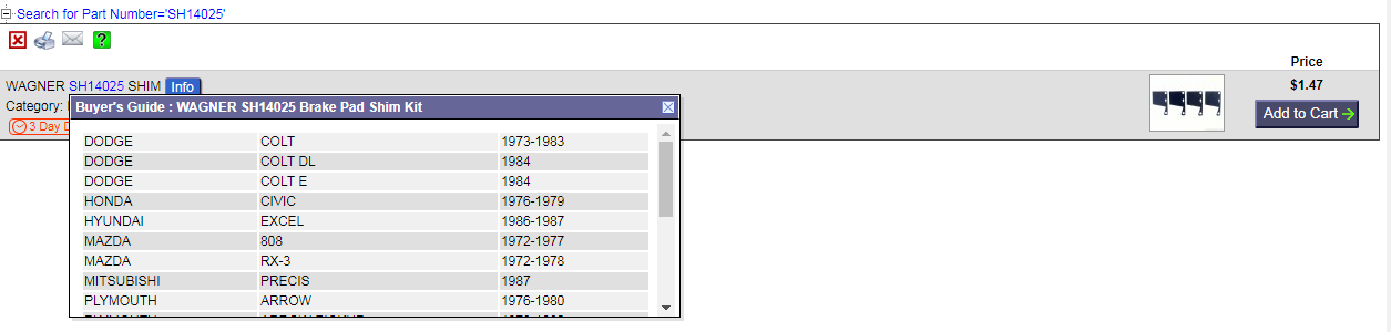

For the energetic experimenter, there may be options. A little digging turned up what some people consider replacements for the factory shim. And cross referencing has turned up a couple part numbers. There may be others as well, but I didn't dig too deep. Here's some numbers to start with:
Beck/Arnley 084-2008
WAGNER SH14025
The look a little different than stock, but the differences appear to be in areas that shouldn't really matter. Mainly... They are cut straight across the piston instead of having a circular cut out in the middle. Since the piston doesn't contact there anyway, I'm thinking it shouldn't matter. And I don't know if the coating would help or hurt, but I think they would be worth a try if you're desperate.
Here's a pic:
And here's a couple pages with more info:
http://www.rockauto.com/en/moreinfo.php?pk=156573&cc=1274745&jsn=10619
http://www.ebay.com/itm/Disc-Brake-Pad-Shim-Front-Beck-Arnley-084-2008-/232361458677?epid=75309807&hash=item3619d27bf5:g:sA4AAOSwhvFZNeBE&vxp=mtr

Just ordered a set from Rockauto.  $4.46 shipped, USPS.  Noticed that it's a wholesaler closeout though, with a 3 day delay, and that they don't look anything at all like the other shims for the other cars they're supposed to fit.  Hope they're not made of cardboard.  Wagner is a reputable brand though.
