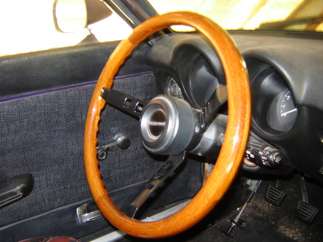

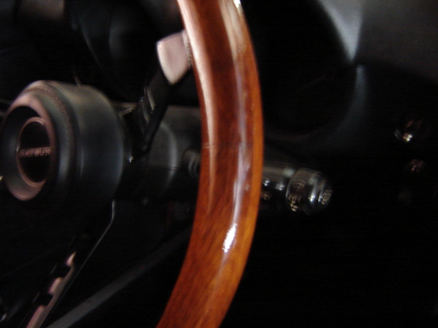

Hello Z dreams,  something like in my car? :beer:  The inner metal of the steering wheel is about 6,35 mm (1/4 inch!) thick.  I took 6 pieces of mahogany on the front with a 1/4 inch groove in it and 6 pieces on the back (massiv). Made them with a hand milling machine. And the fingergroove with a powerfile..  It was about 30 hours of work haha..  This wheel is glued on with 2 comp. glue and between the wood waterproof wood glue..  I think the result for a electronics guy is very good.. I'm using it now for 10 years and i'm realy happy with it!  (With my big hands and no power steering it's fantastic.)  (It has 7 or 8 layers of lacquer ....:Bang2:zx7.jpgfoto's2007 009.jpgfoto's2007 011.jpg

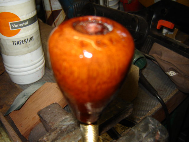

About the gearknob, I've got one made on a wood lathe..  neede also a lot of coats of lacquer..
I destroyed a good wheel ten years ago.. The "wood"  comes of in a vise, by clamping  and a wood chisel comes in handy. The woody stuff is a mix of sawdust and polyester.  Beware it can have very sharp edges!  I've got a spare wheel.. original to my car..  ;-)
