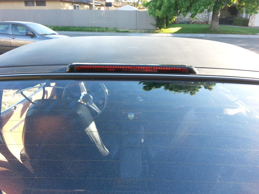

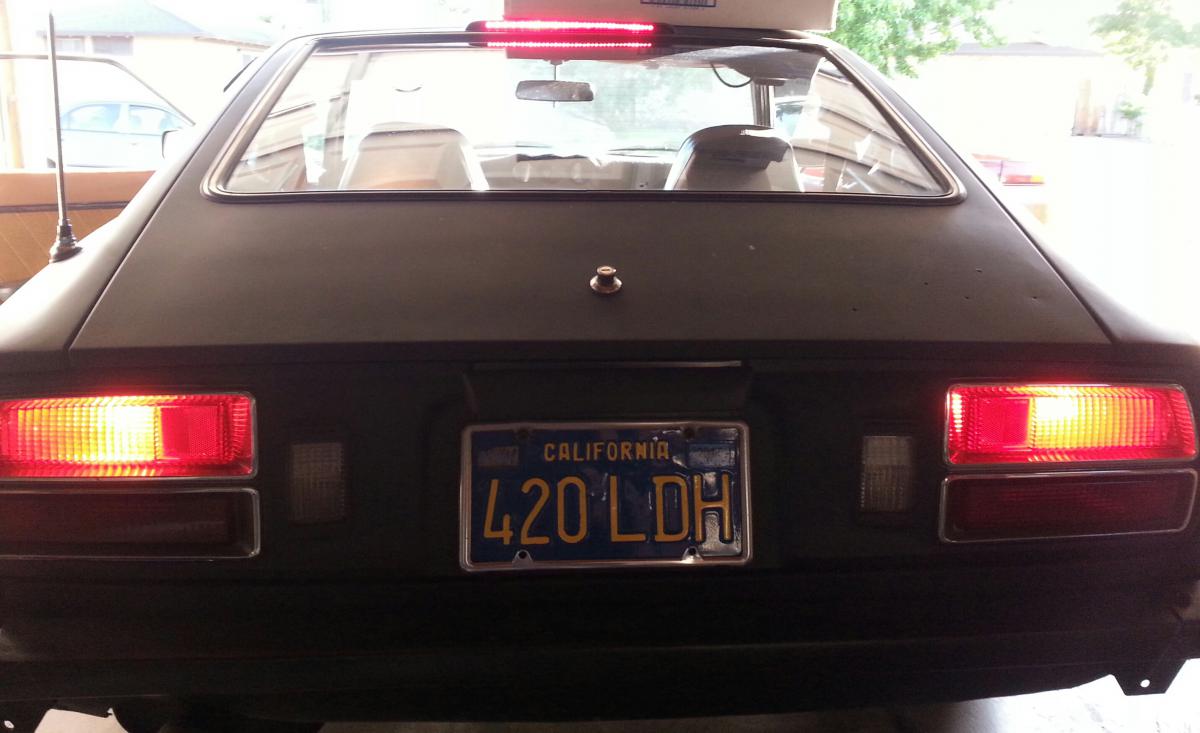

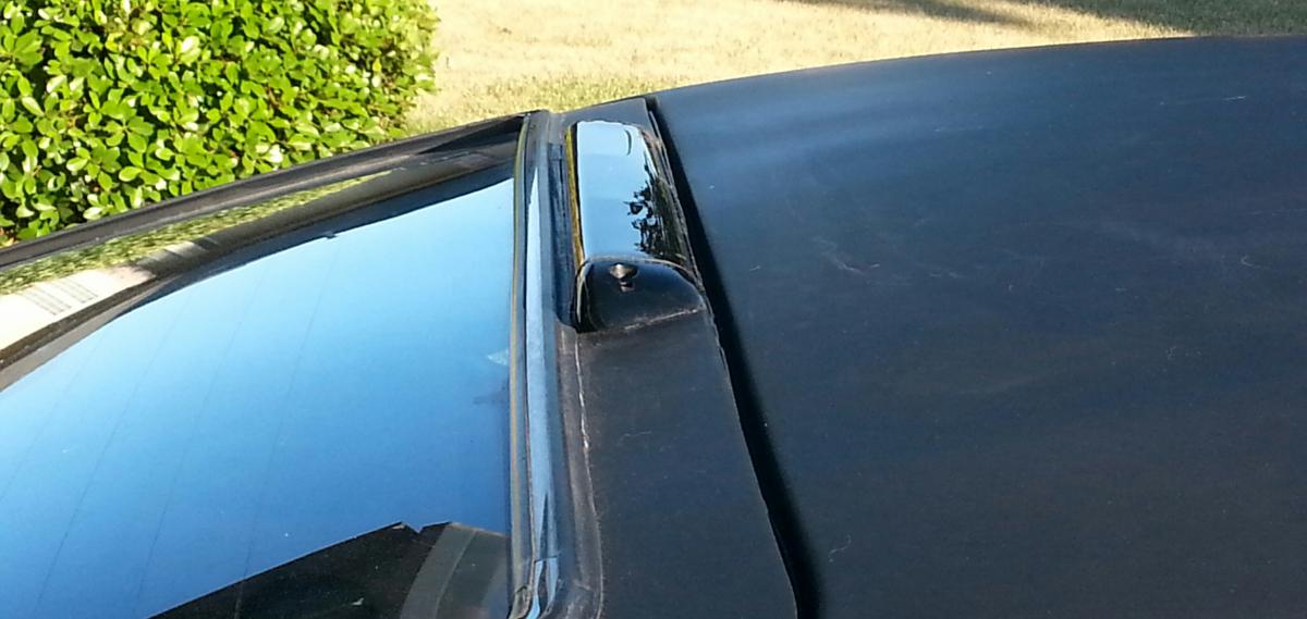

Any opinions or experience with this?  Since I already have a louver, I don't think it would be too visible to be ugly.  If I had no louver, like in the pics below, I think I'd mount it inside the hatch.

I added a third brake light to mine with a $10 Ebay light and wired to to my existing brake lights.  Mine is kind of short but it is pretty bright. You could probably find one longer if you wanted.  3M adhesive tape  mounted it to the inside glass and has held up well over the summer.  It's very visible through the louvers to normal kinds of vehicles and SUV's behind me when on the road,  but probably not to any high lift trucks, say, at a stop light.  This is the only pic I have at the moment.
