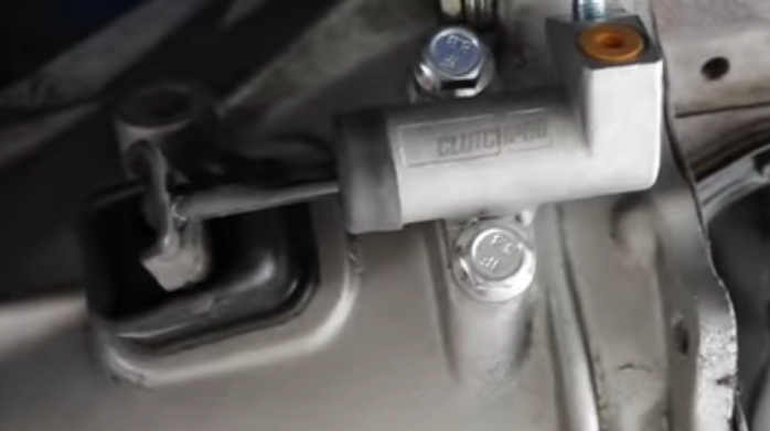

Jeff, hate to keep harping on the transmission slave cylinder, clutch fork, collar, and throw-out bearing... BUT... ...
In it's current configuration I believe you may well have trouble with the collar moving too far forward and slipping off the tube that it should glide back and forth on.  If it does that while driving you'll be in trouble...
Good ingenuity.  The other potential problem is the fork hitting the back of the hole before full release.  Doesn't look centered, and looks like more than 6 cm.  Might want to test it while the trans is easy to get out.  The clutch system is super easy to bleed and doesn't take much fluid.
