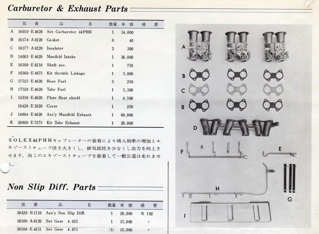

@Patcon@240260280  Have you never seen the factory triple-outlet fuel pipe before?
17520-E4620 was offered as a Nissan Sports/Race Option part pretty much from the beginning, and is still available today.
Here's an example from 1971:

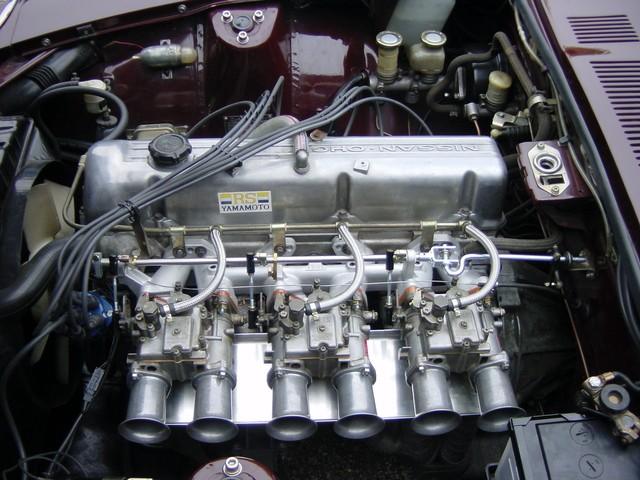

This is an older photo of my kit that came with the same fuel pipe. The copper tubing is grafted to the end of this pipe and goes to the fuel return line.
In my case the triple pipe is flipped to be fed from the rear as my tank line is routed to the firewall instead of the stock front location.

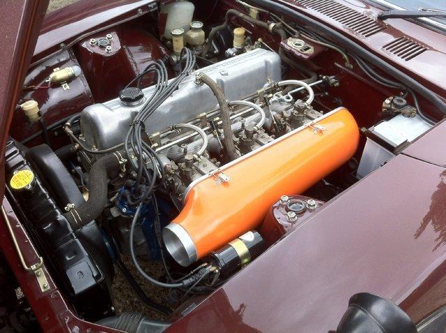

Is there a Mikuni-optimized fuel rail?  The one below seems to have the 3 ports aligned with the Weber inlets (trailing throat) rather than the Mikuni (leading port)?
Since Mikuni-Solex PHH carbs came in top-inlet, right hand side-inlet and left hand side-inlet form depending on exact model, the factory E4620 triple carb fuel supply tube might be considered universal...
The 40PHH carbs in the above photo (that's my G.P. Maroon Fairlady 240ZG) were originally part of a period Sanyo Kiki 'Sanyo Sports Kit',  and I simply added curved soft fuel lines to join up with the triple carb rail. Works perfectly well.
