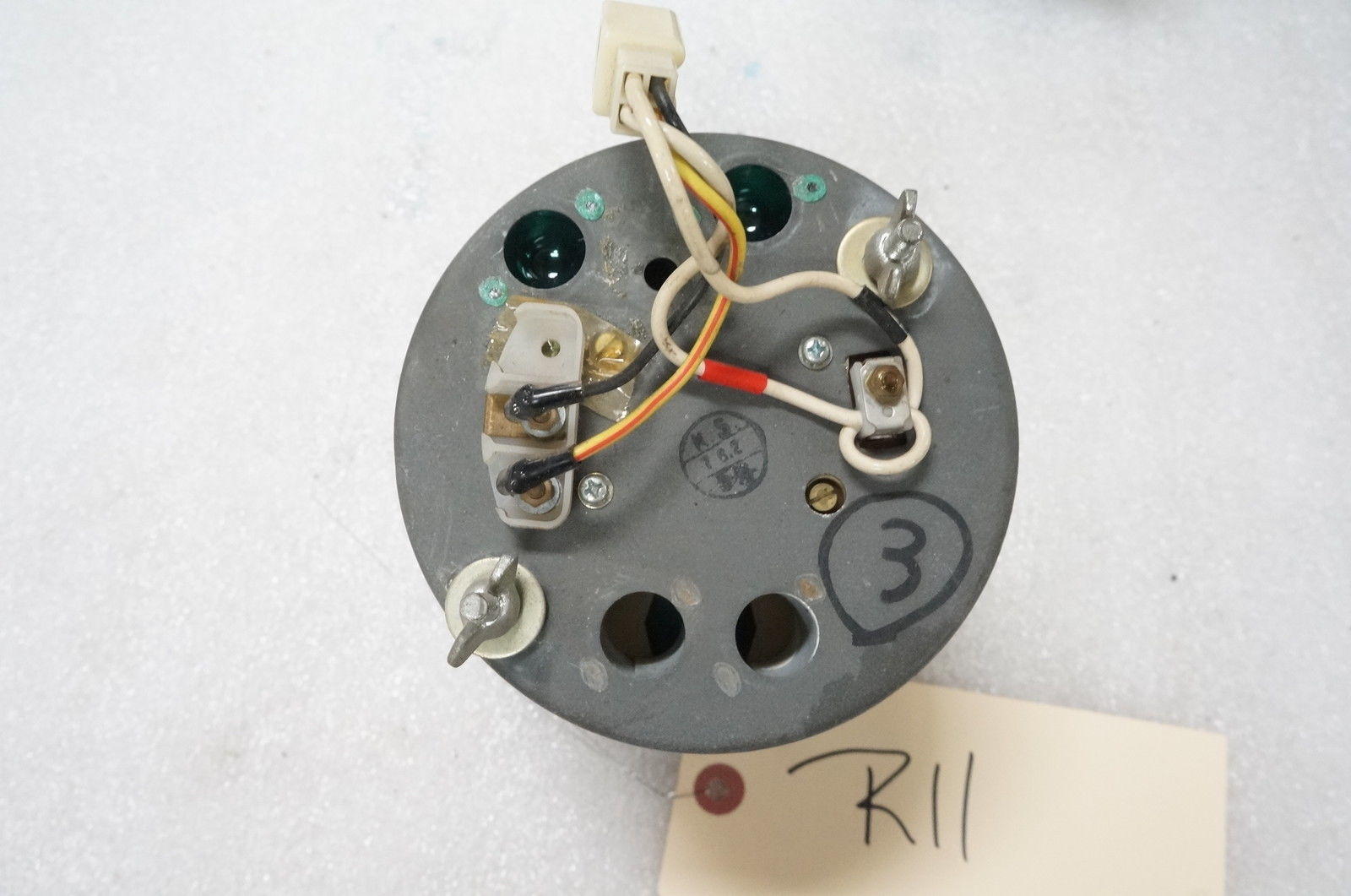

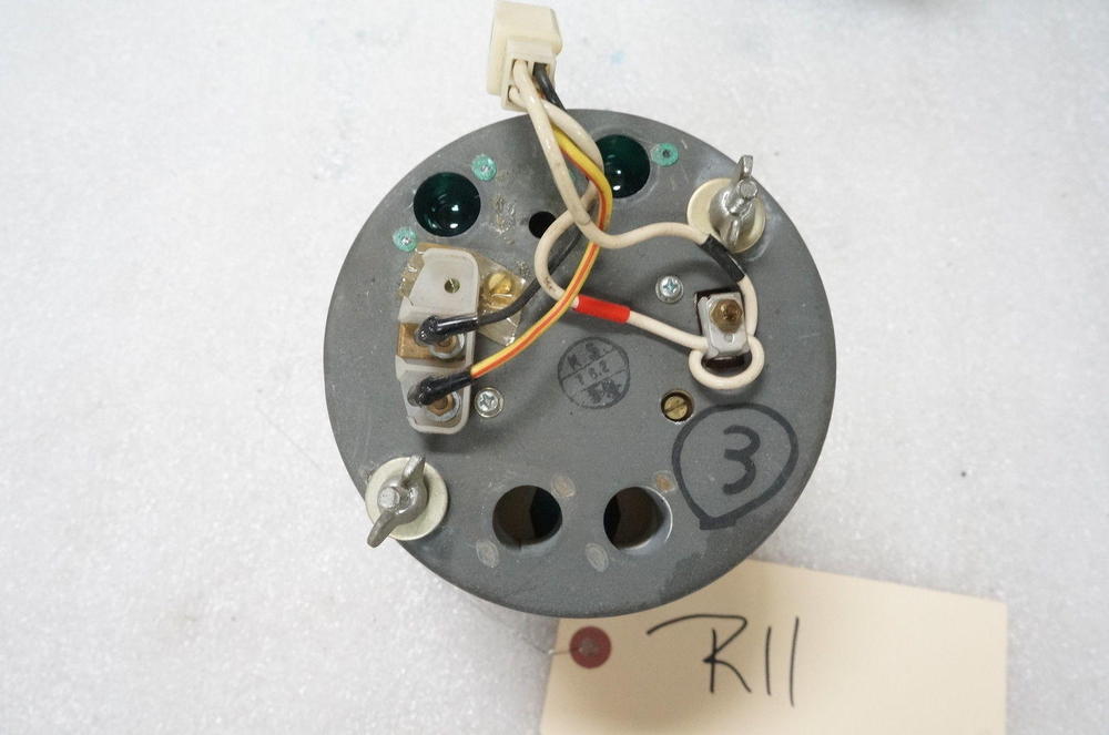

I'm assuming we're talking about an early style inductive pickup style tacho? Back side looks like this, right?:
If that's the case, then you really only need to make connection to two wires (not four). Just to get the engine to run, the only two you need to connect to are the two white wires.
The one with the red tape should come from the ignition switch, and the one with the black stripe should go to the (+) side of the coil.
If you don't connect the other two wires (Y/R and B), the tacho itself won't work, but that shouldn't keep the engine from running. Will just keep the tach at 0.
Perfect. That is exactly what I am looking for. So currently I have power to the yellow/red wire but nothing coming in from the white/red, so that will be my task today to find out why that doesn't have power.
