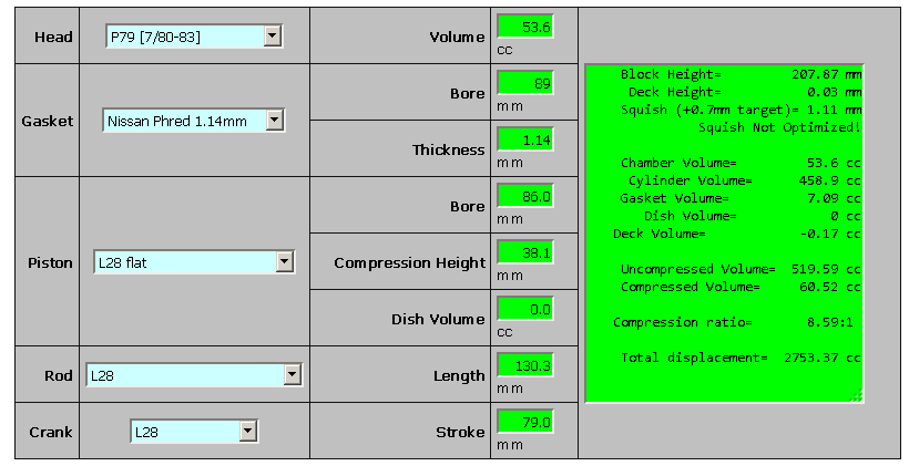

Attached is a tool for engine planning. Below is your basic config entered. The 53.6cc chamber volume can be edited to 53.5 to match yours.
As mentioned above, a good 0.080" shave (cc's at 46) will bring up the compression to ~ 9.7 which these engines seem to enjoy.
S30 Engine Modeller V3 Beta 3.zip
I shaved 1mm off the head and I actually stuffed up the calculation, as I didn't add the combustion chamber volume to the swept volume, so it is more like 9.57:1.
459 + 53.5 = 512.5
512.5 / 53.5 = 9.57
