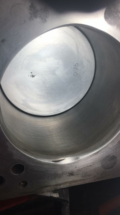

I opened my engine that had that combo 2.4 block with N42 head, but there were no notches and no scratches, the bore isn't 83 mm though it is ~83.9 mm +/- 0.05 mm, at least that's what I got, is that 0.9 mm oversize good enough for clearance, because like I said there are no indications on the valves touching. Nick
Edit: Upon closer inspection only cylinder #6 has a little scratch where the exhaust valve goes, but that is the only one and it is nothing compared to the one you showed earlier. it is about 4 mm wide.
Edited by footballnick17
If you've ran that combo and it didn't make any ticking noise then whatever overbore you have is adequate I guess? Mine is 83mm and the vales were hitting. Once I had the block notched I put the bigger vales N47 back on there and the valves would fall through the cylinder without any interference.  I had to use clothes pins to hold them up but as I released those the valves dropped right out the bottom.
