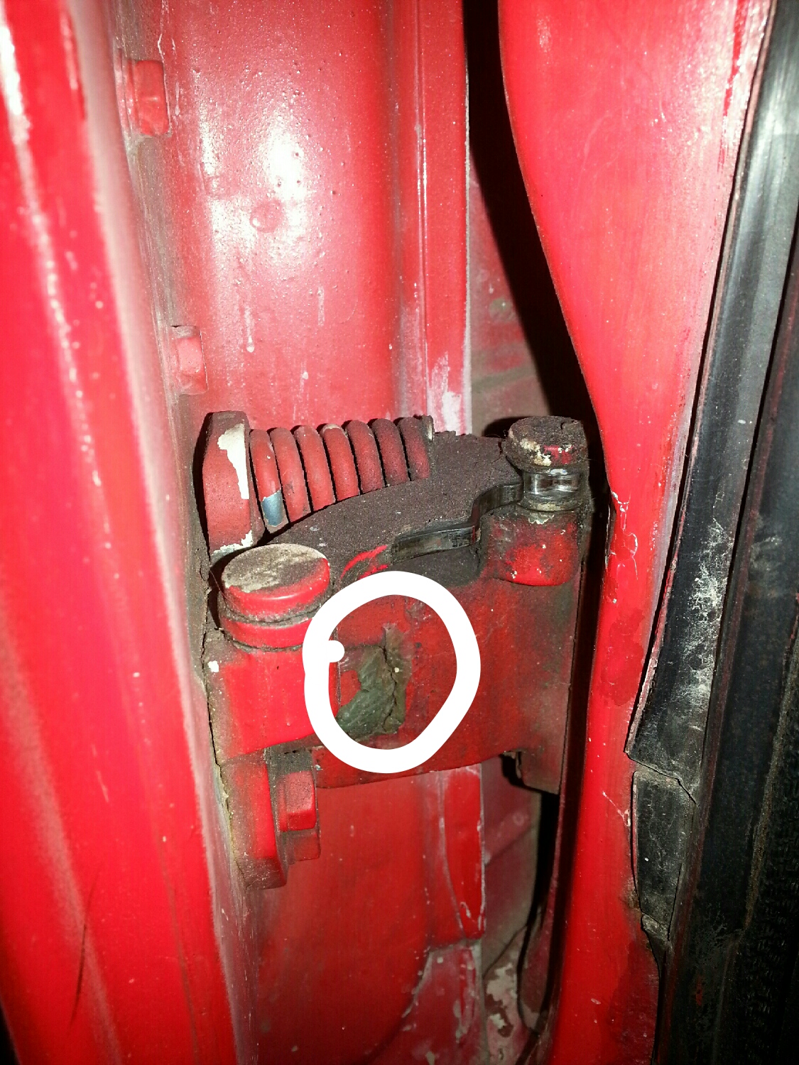

Upon enlarging the door hinge, it looks like it may maybe coming apart.  See what you all think of this photo with the area circled.

 I think you may be correct. looks like a broken hinge. Try lifting the door as described by Dave WM above and see if the rusty gap in the hinge closes up. It may be easier to lift the door using the window frame with the window down. Also the door will likely close if you can lift it while closing it. Anyone out there have one?

Now as to the hinge possibly breaking.  Does it look inside the white circle that perhaps someone welded it, maybe a lousy fix for a cracked hinge?  Is that weld marks?   Again I don't know, maybe my thoughts are off.   I do know that when RedBird was prepared for sale, before I bought her, whomever it was used the cheapest methods possible.  I have found lousy work on her, that I don't think the original owner would have done.  The good parts on her are really well cared for good.
