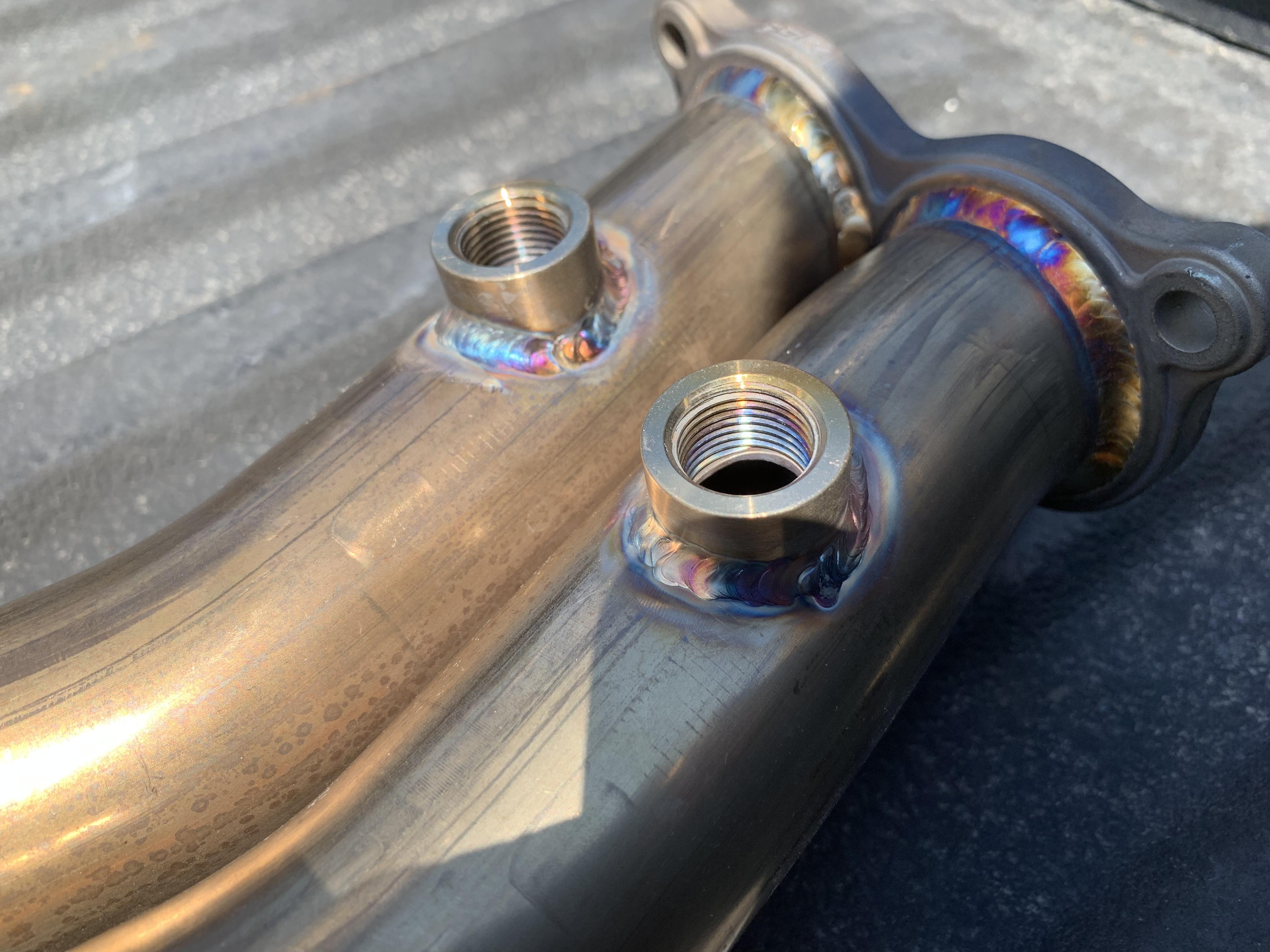

I got o2 bungs installed.  So far so good.

Where did the flange and down pipe material come from?
I like your TIG welds too!

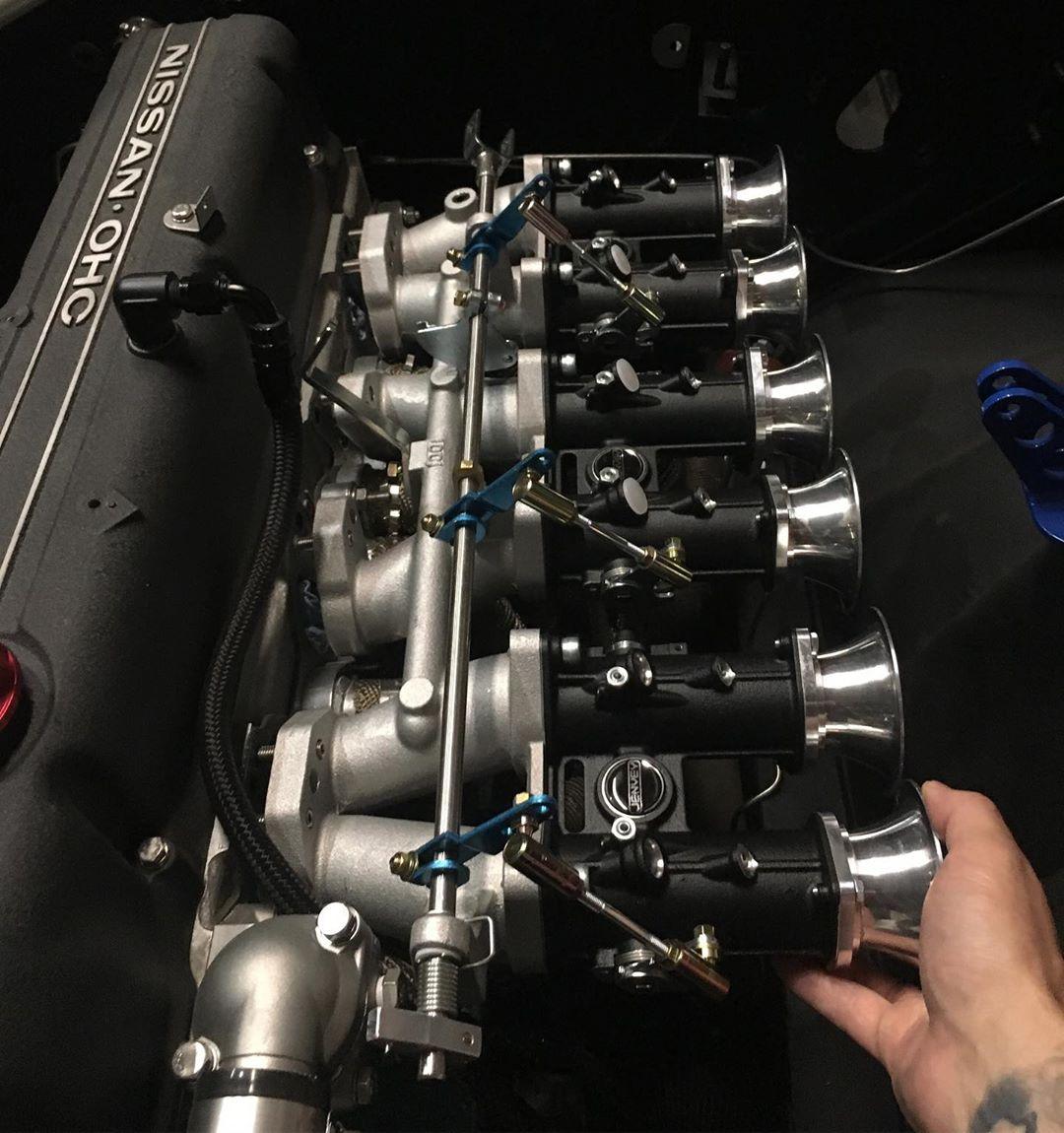

Well I have decided on ITB for my build.  Carbs sound cool, but the smell of gas in my garage is driving me nuts.  My HVAC unit is right next to my car in my garage and the fumes seem to move into the whole house.  I also think the mikuni 44s are a bit much for a stock 2.4L.
I bought the jenvy 45s, injectors etc.. from Datsun Spirit.  I will probably do a haltech elite 750 ecu.  I got a hoke trigger kit for my stock 240z pulley and will do some sort of cam sensor from the dizzy spot.  Goal is to look basically period but be EFI.  I will re use my SK intake.

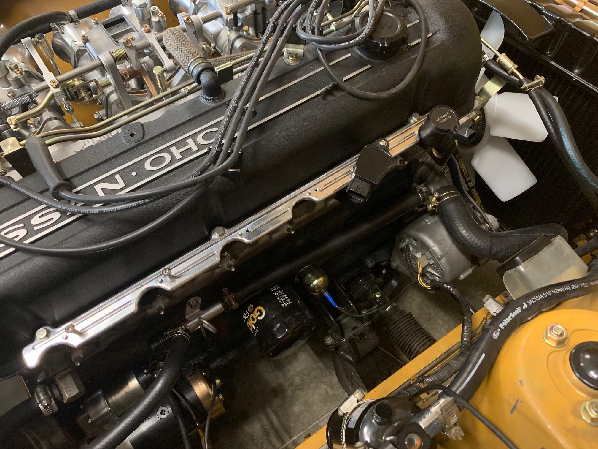

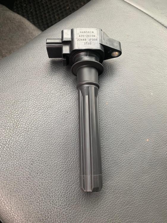

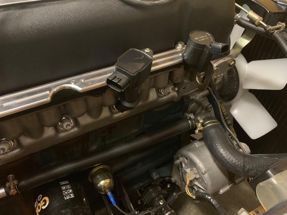

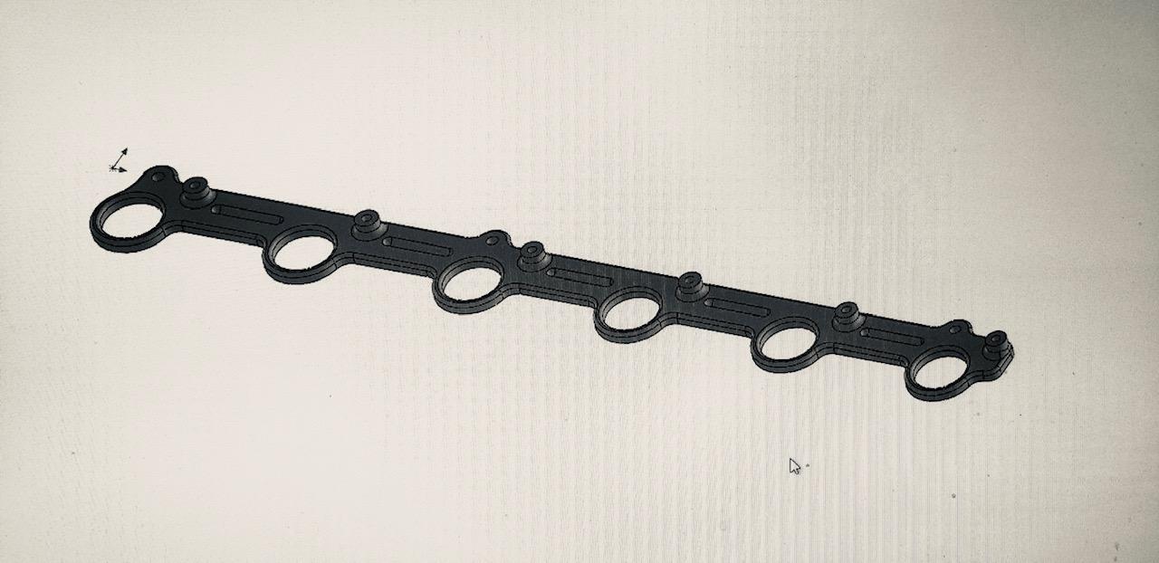

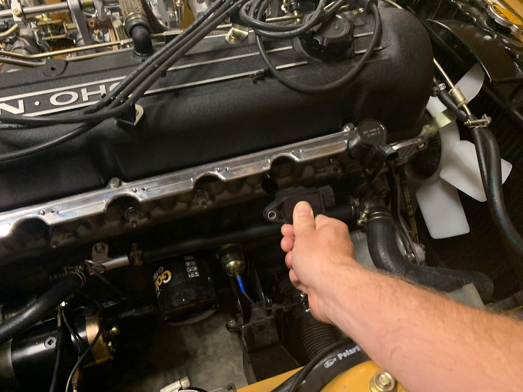

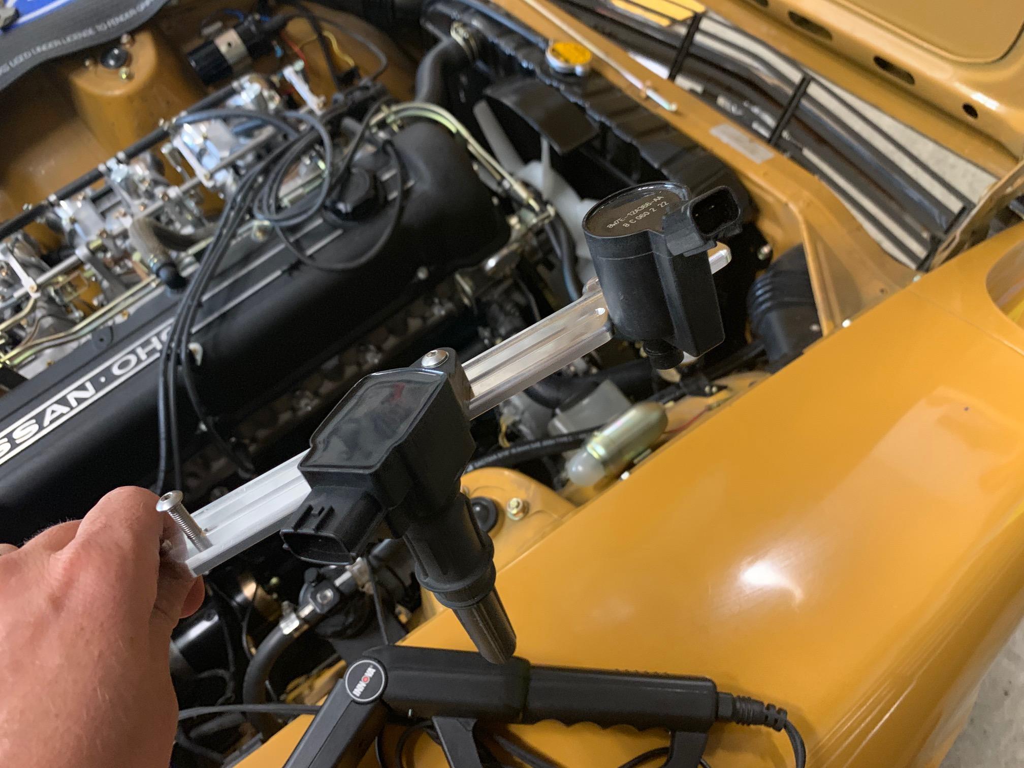

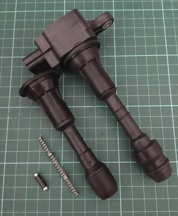

I am designing up a coil bracket like the Blake one but uses nissan RB coils.   This uses 2006 350z coils heads (Hitachi IGC0003 Ignition Coil) and spring.  Then a boot from a 2005 Chrysler 300.  They fit perfect.
