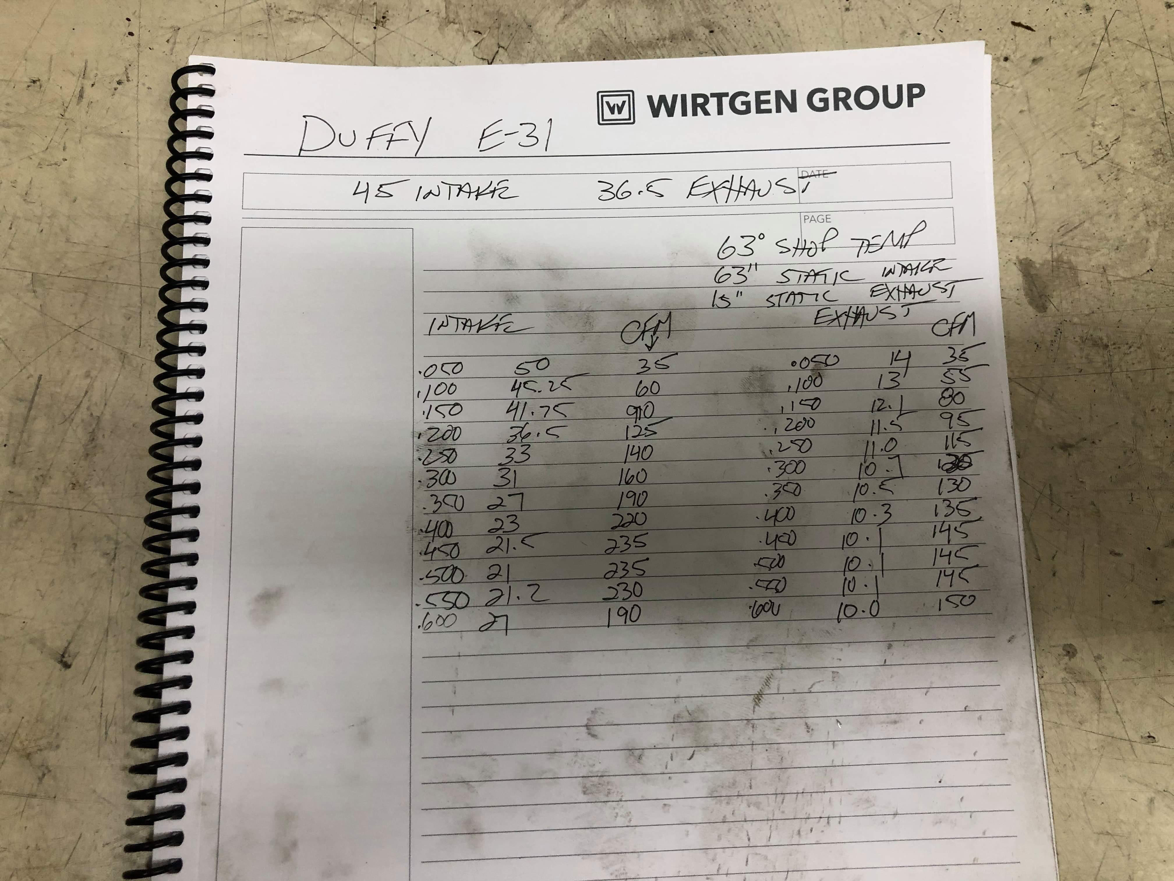

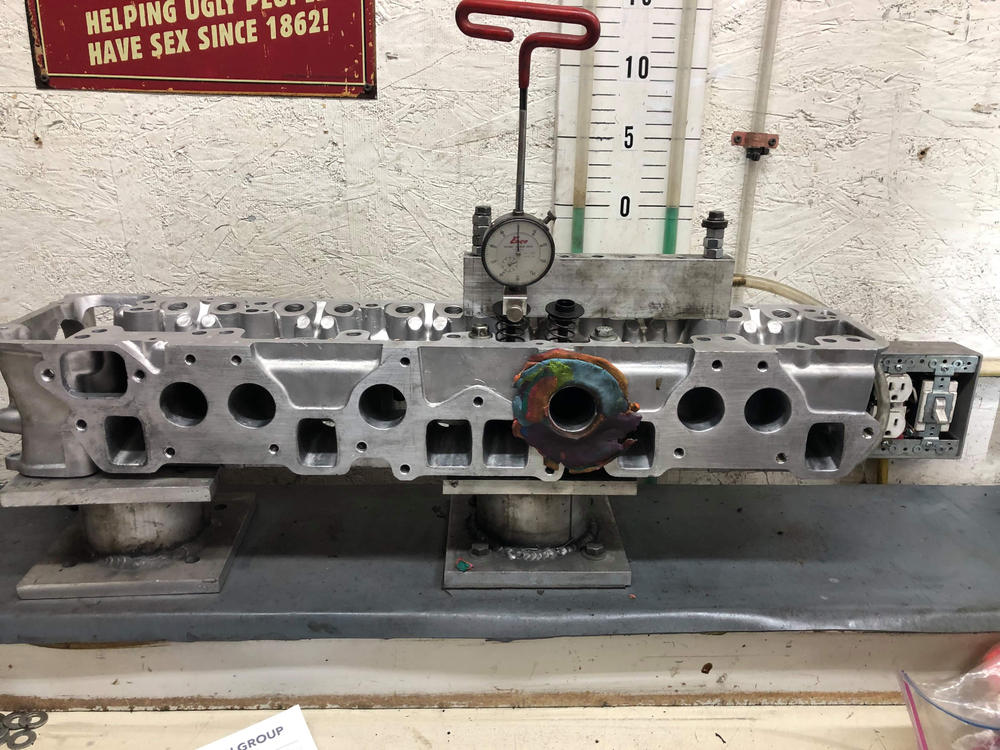

Here is my flow testing data
Datsun Flow Testing Data.xlsx
Duffys E31 Flow Testing 63" Static       15" Static
63 Degree Shop 45 Intake Valves       36.5Exhaust Valves
DSI Big Valves                                                                                LIFT       Manometer           CFM                          LIFT   Manometer          CFM
Porting By Andrew Kazanis of Mad Greek 0.05 50 35   0.05 14 35
Date: 2/22/2020 0.1 45.25 60   0.1 13 55
  0.15 41.75 90   0.15 12.1 80
  0.2 36.5 125   0.2 11.5 95
  0.25 33 140   0.25 11 115
  0.3 31 160   0.3 10.7 125
  0.35 27 190   0.35 10.5 130
  0.4 23 220   0.4 10.3 135
  0.45 21.5 235   0.45 10.1 145
  0.5 21 235   0.5 10.1 145
  0.55 21.2 230   0.55 10.1 145
  0.6 27 190   0.6 10 150

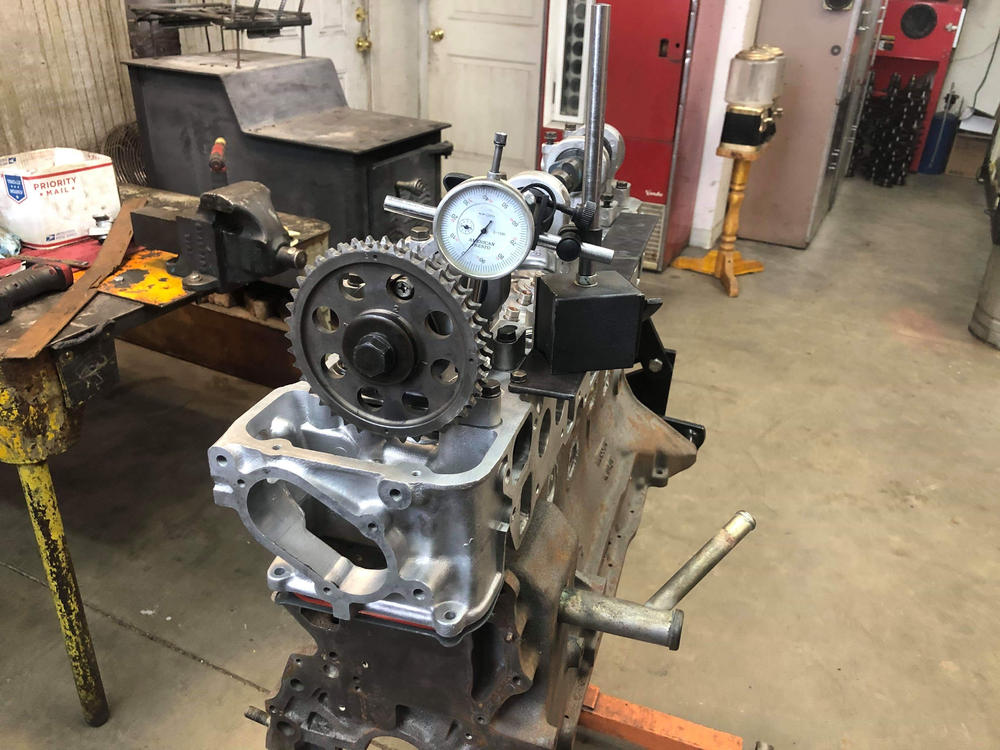

1 minute ago, Patcon said:
Cool
Interesting shop, wood heater with some sort of shelf, cranks, blasting cabinet etc.
He is a Z enthusiast.  Plus a racer, plus a engine builder, plus hobby guy.  Super nice.
