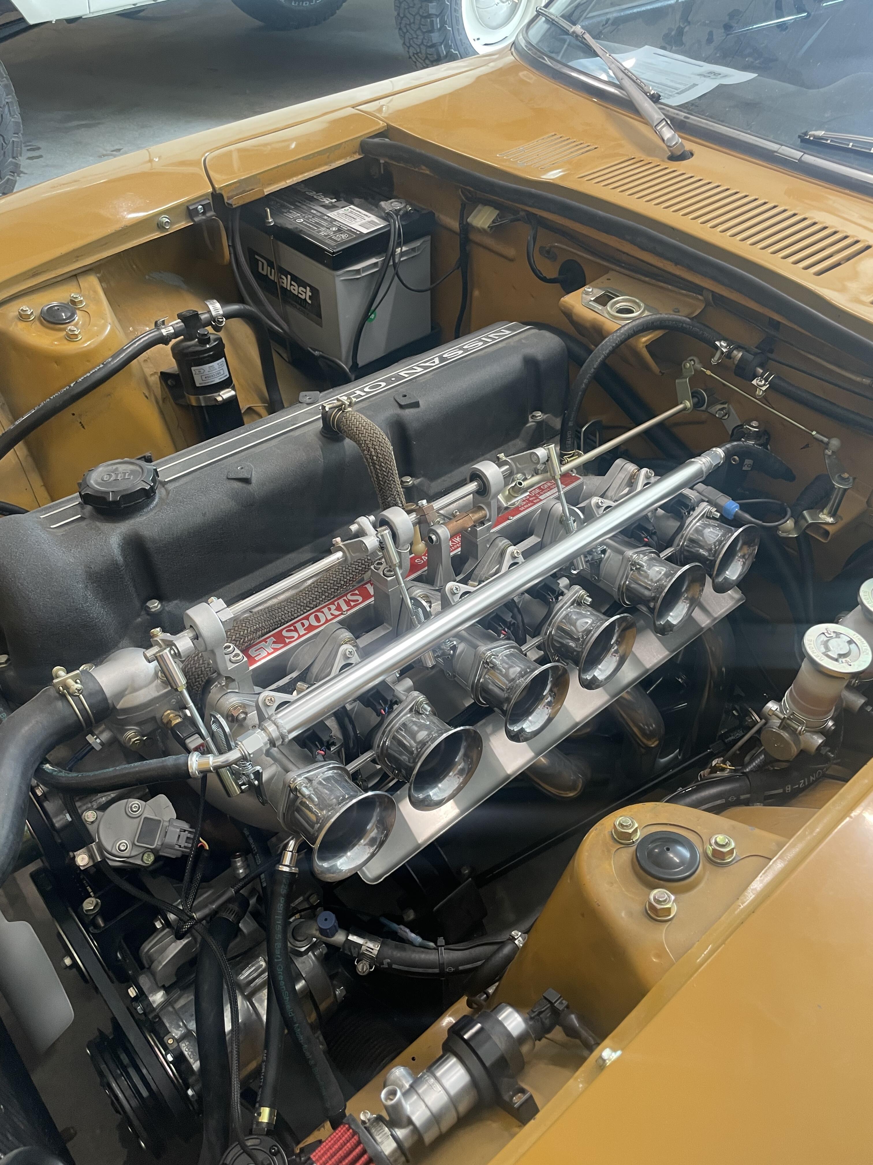

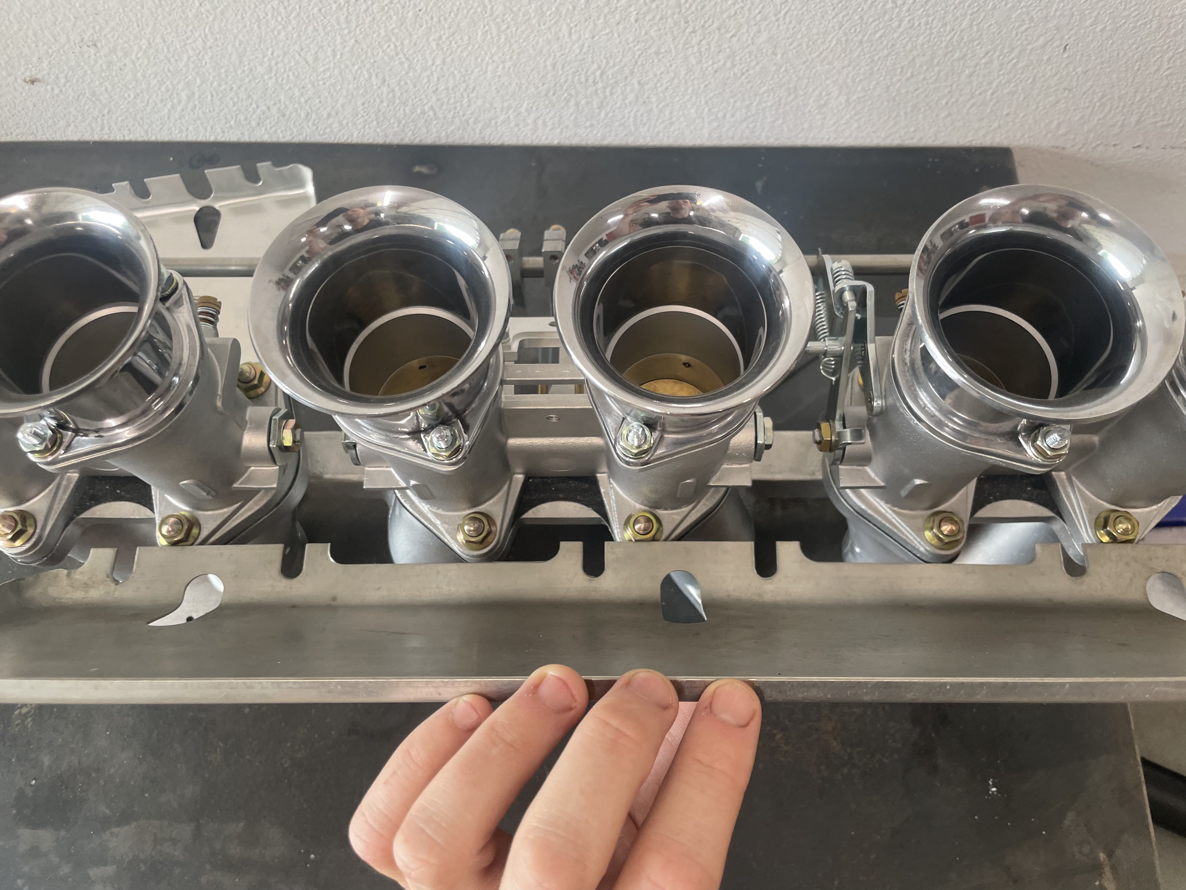

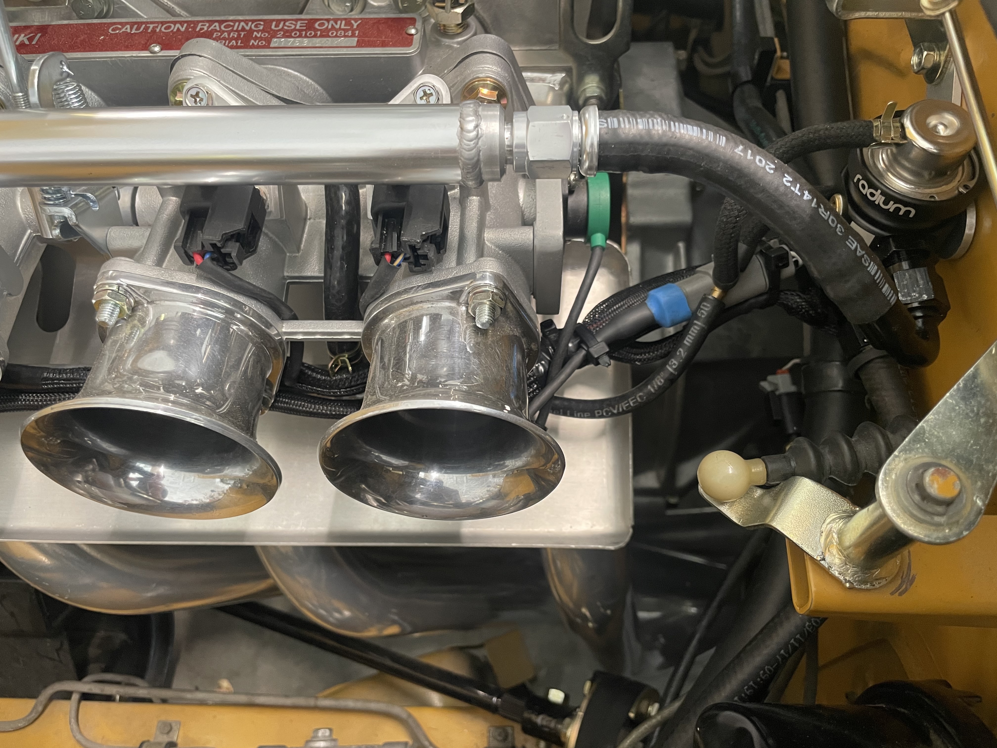

Well the day has finally come to use a heat shield. This is the one that came with my vintage SK ITB setup. How it installs originally didn’t protect my wiring to the firewall enough. So I shifted it down 2” and then slotted it. I hate the look of sheilds, but it was time.

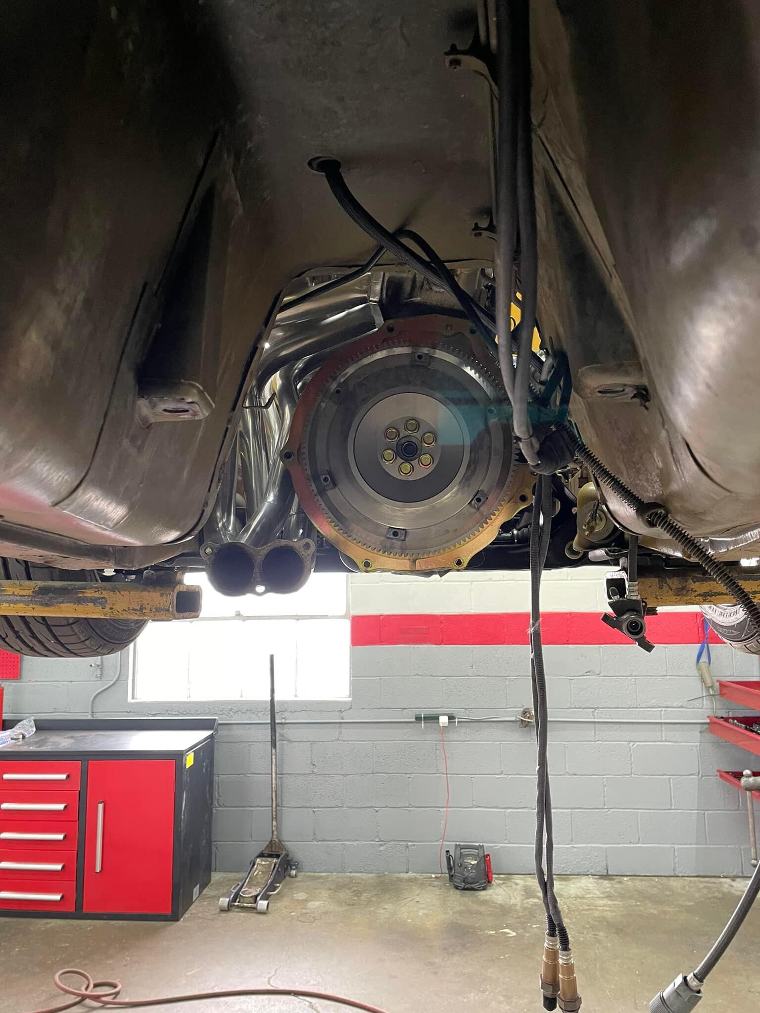

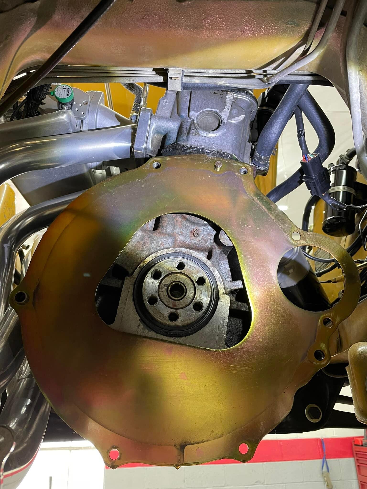

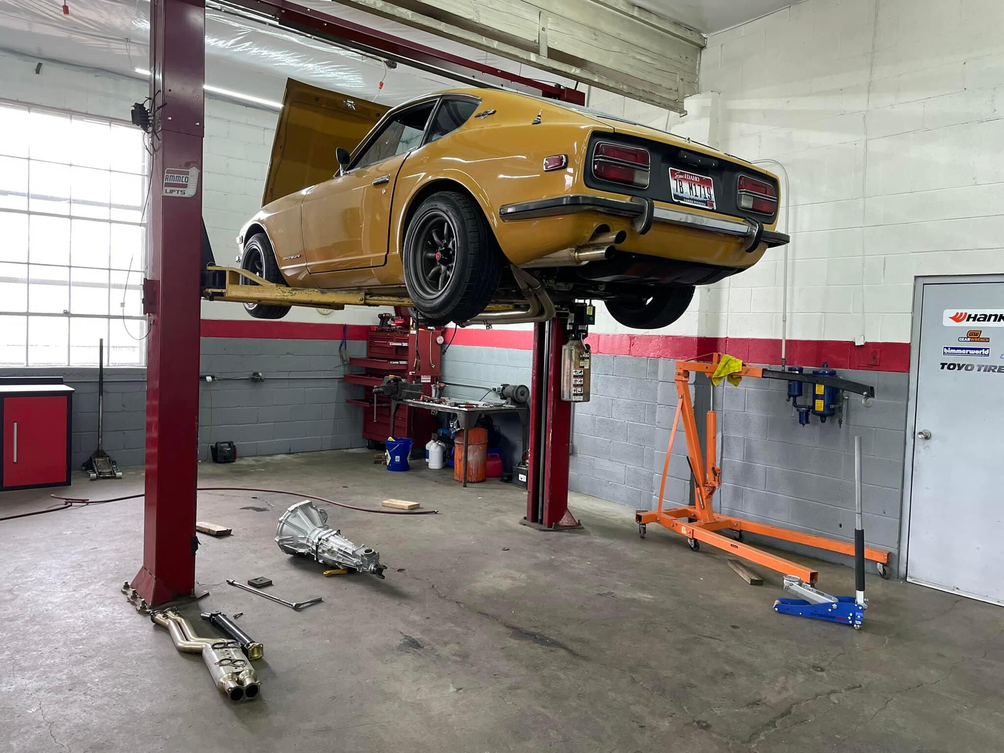

Well finally got my osgiken clutch out and went with a stage 1 from exedy with a lightened steel flywheel.  The osgiken was way too hard for me to street drive and my wife hated it.  It was poorly installed by me and it's a pretty racey clutch.
I sent to Z car off to a guru.  Andrew Kazanis, he swapped the clutch, found my clunk (exhaust hitting during load) and change my rear main seal.  Then his buddy Matt finally fixed my passenger regulator.  Which hasn't worked in years.  I went with a repopped one.  Matt thinks my rear end is a little noisy, but Andrew can't hear it.  I cannot thank Andrew enough for all his help.  He is a friend and just an all around great guy.

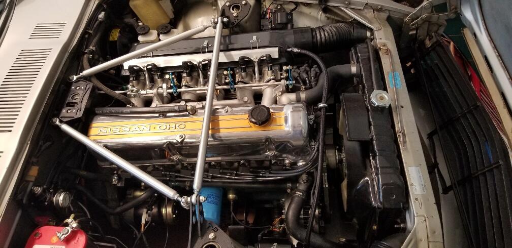

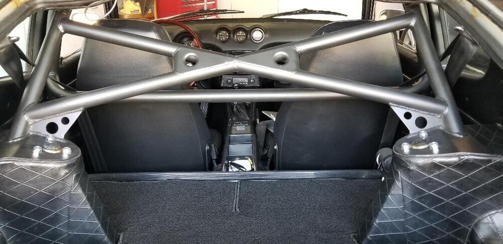

Don't want to highjack your thread but you we're instrumental in my conversion. Couple of pics attached. Building a sleeper but no hiding the roll bar.  Running a CAN display in the clock position on the dash. She's running but as you mentioned doing load tuning.
