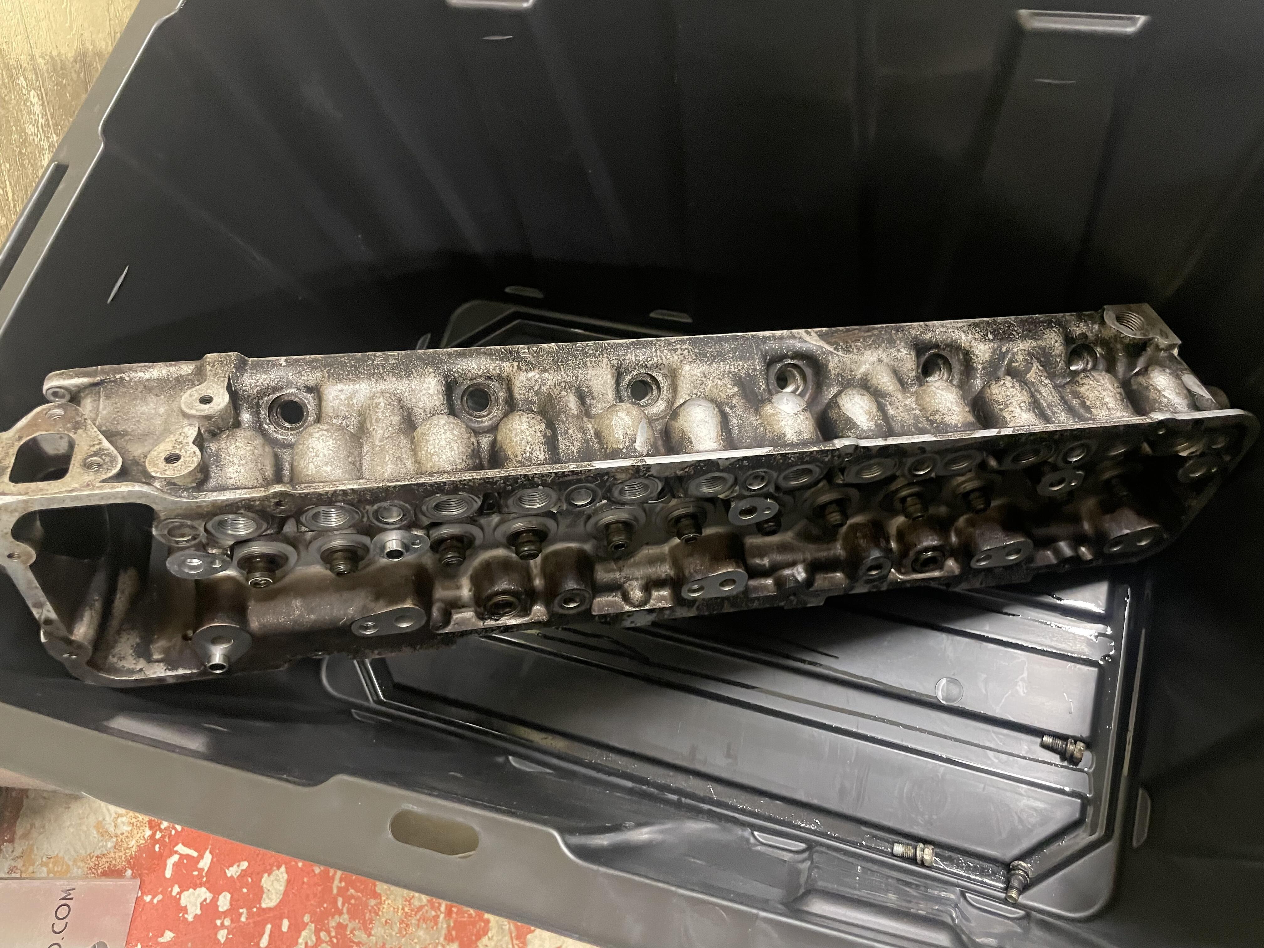

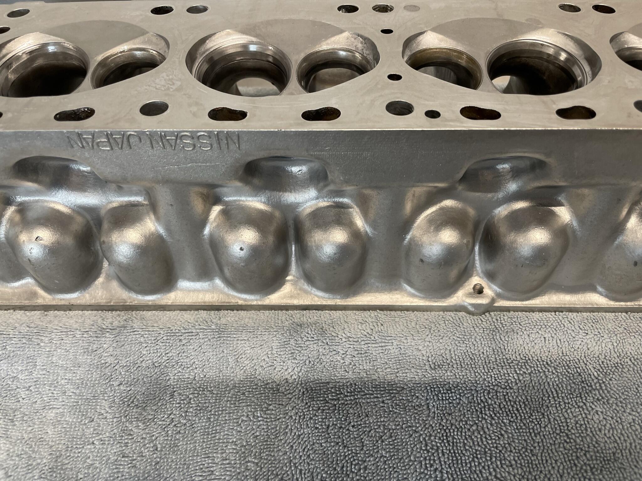

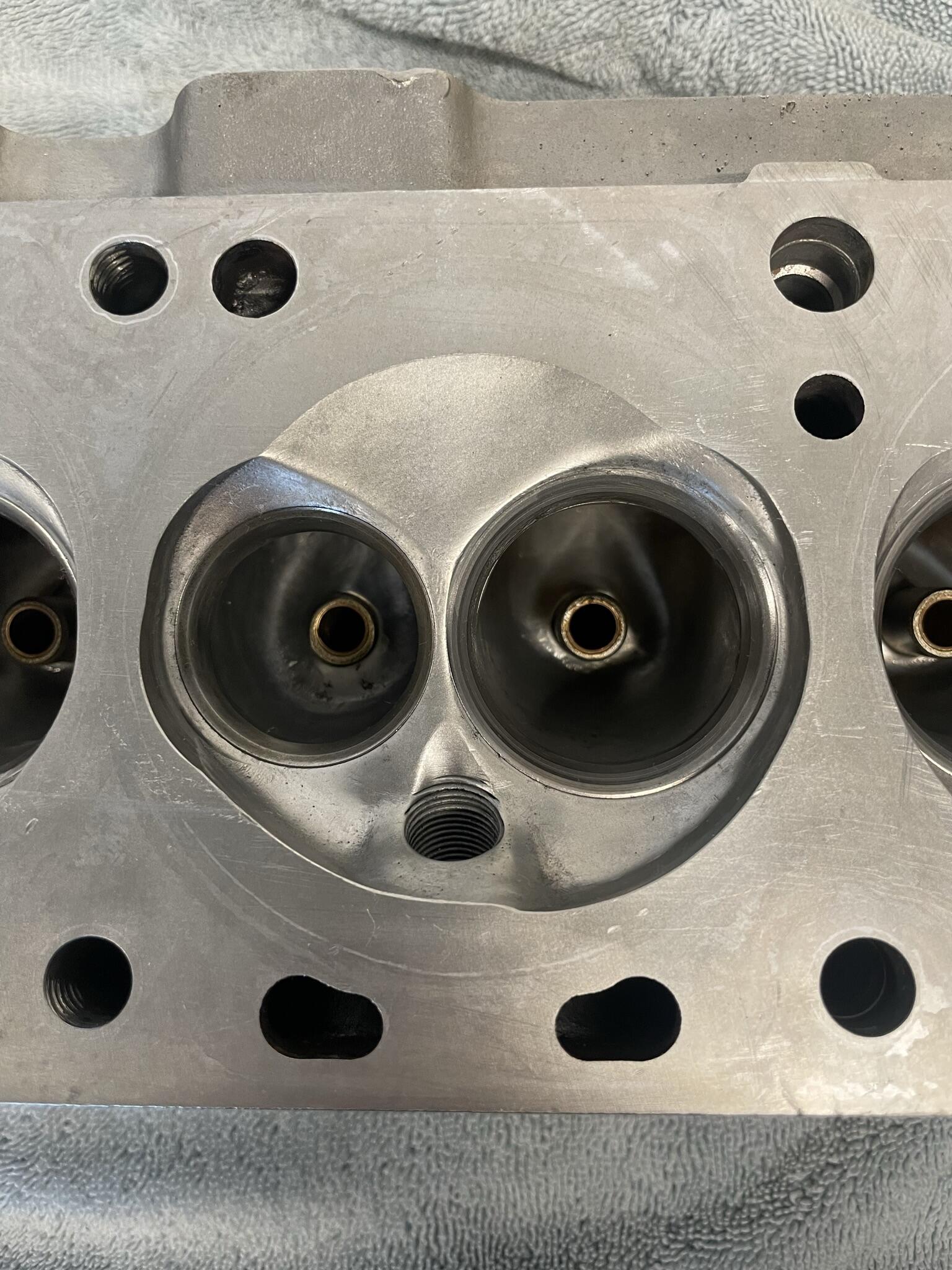

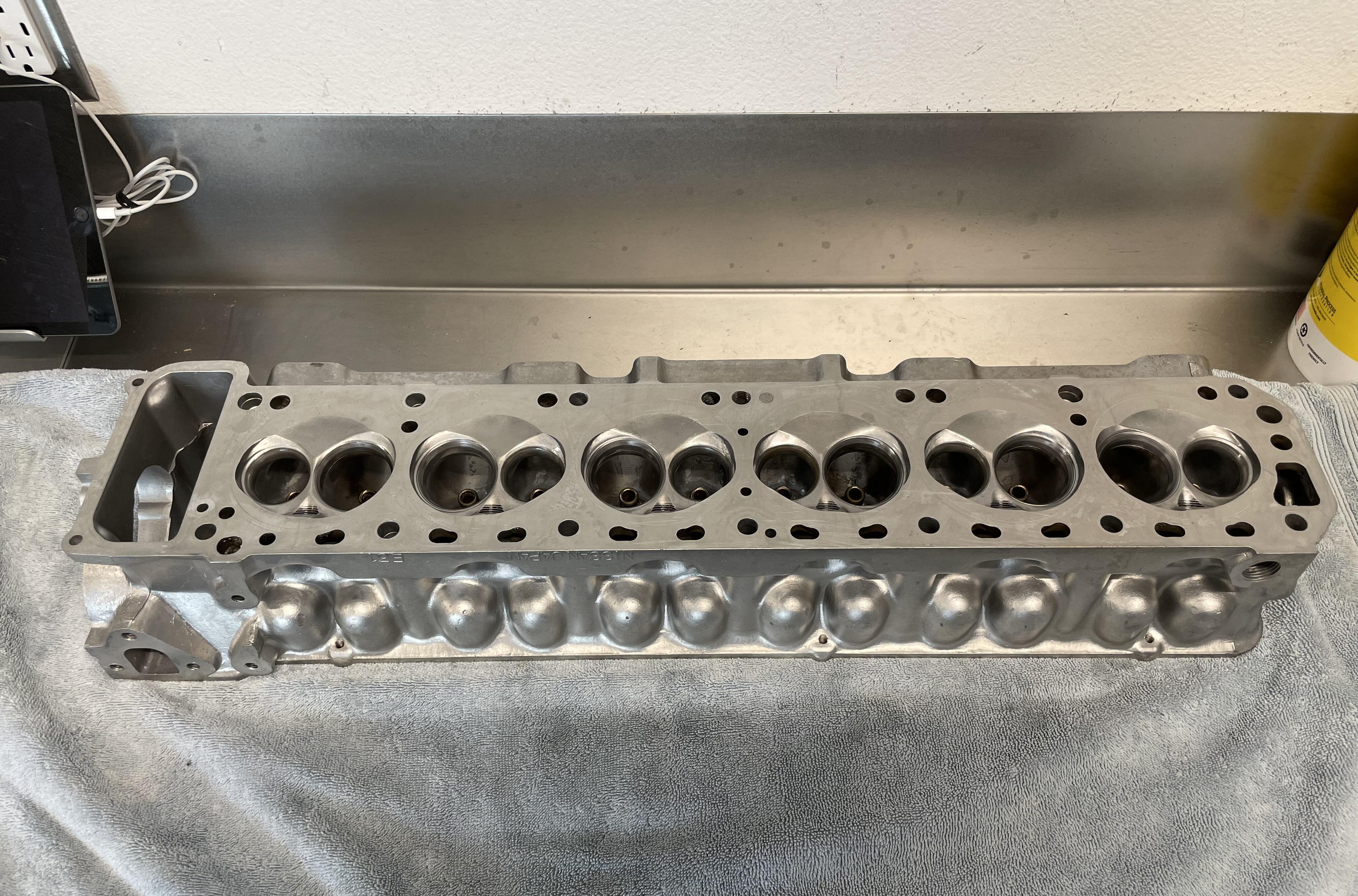

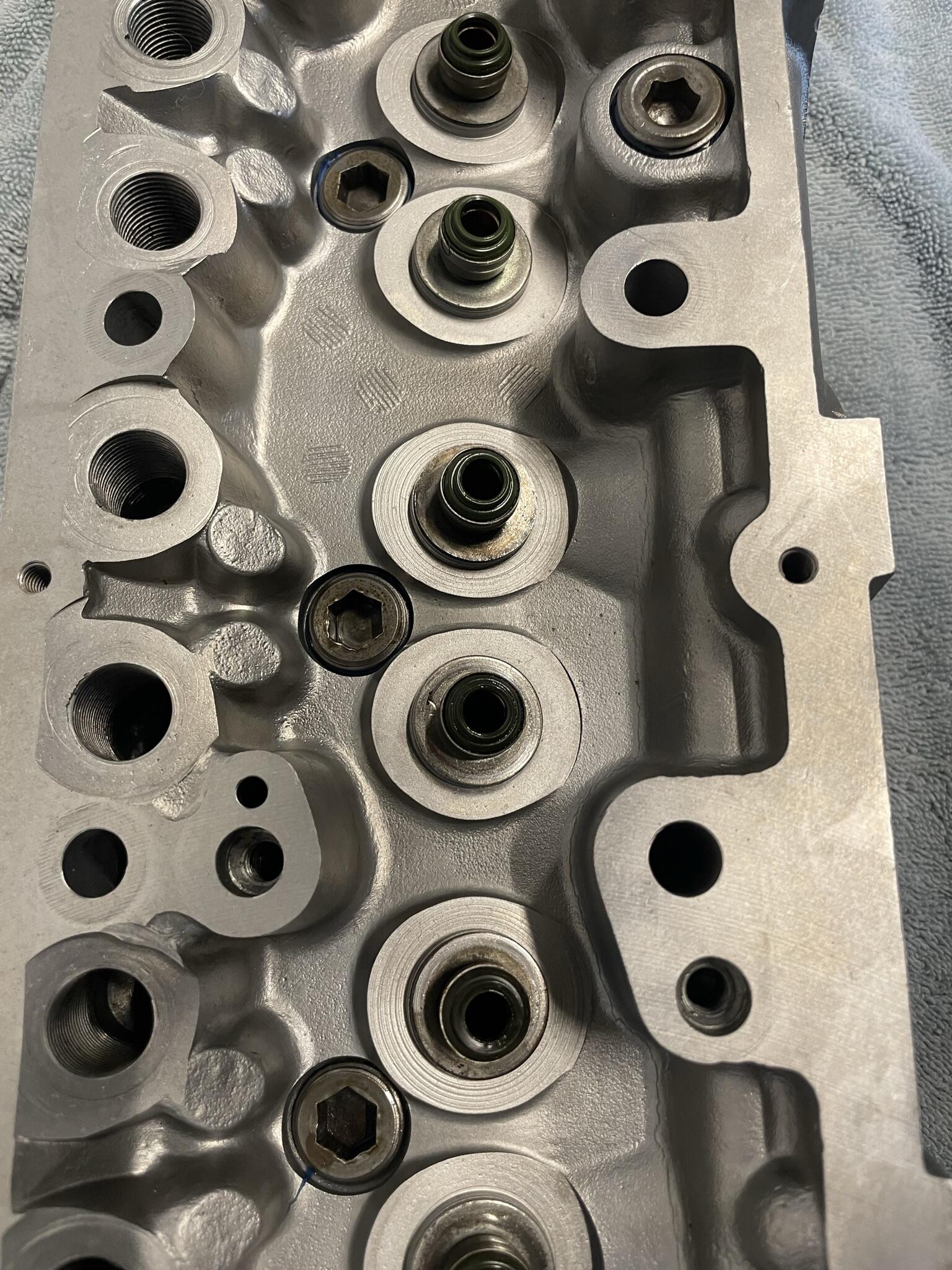

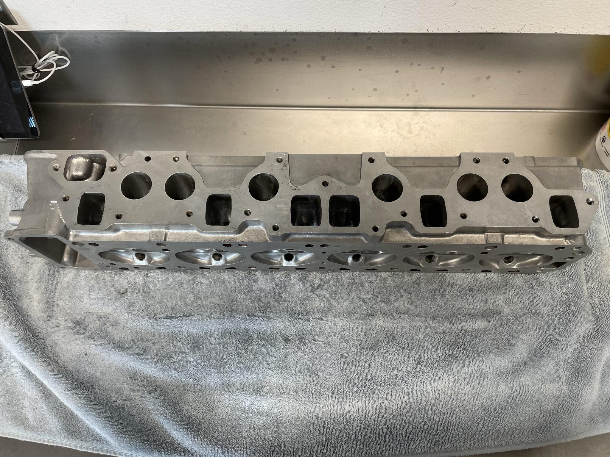

Well sadly my ported E31 head was in an engine shop fire. Luckily my 3.1L was pretty far away from the flames. Well lots of elbow grease and 4 hours in my vapor blasting cabinet and it looks as good as new!. Now time to have it put back together.
  • Wow 2
5 minutes ago, Patcon said:
Still straight and flat? I would think it got close to 230d F
It will get checked again. Fingers crossed. It will go back to the machine shop to get decked again and re lap the valve seats.
first it needs to go in a large ultra sonic tank.

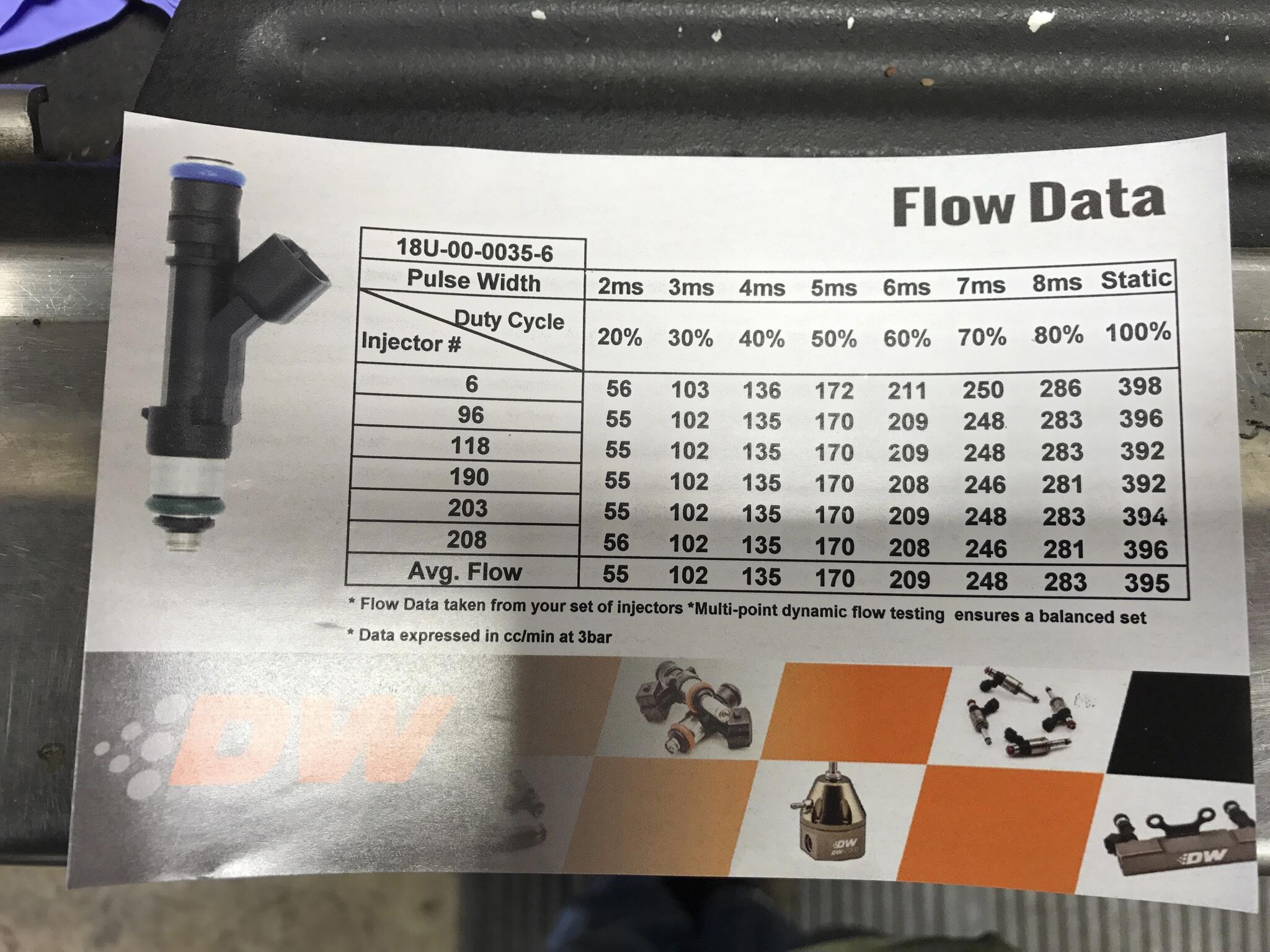

One of my issues so far with running is my injectors that fit nicely into the throttles are a V stream. So I believe they are just spraying on the walls.
I am going to switch out to DeatschWerks 18U-00-0035-6. Single cone spray. They use the same connector. Hopefully I can get the correct orings to deal well. Tiogatold me to do this in the start. I should have listened.

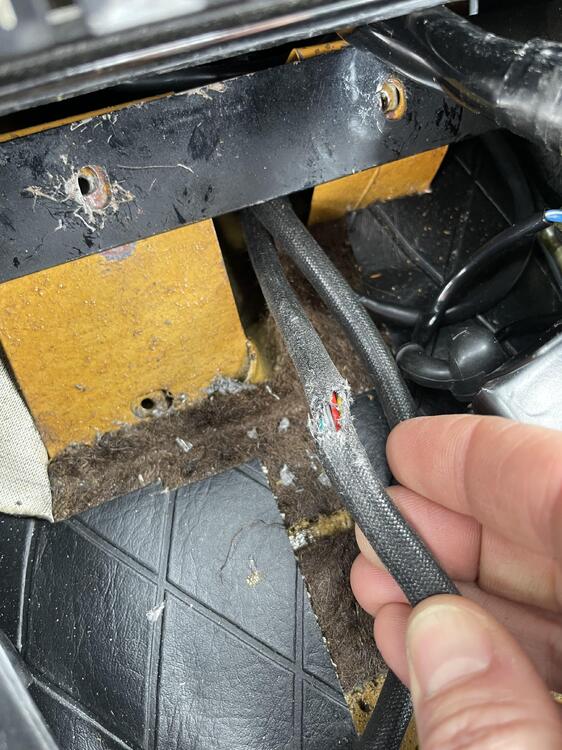

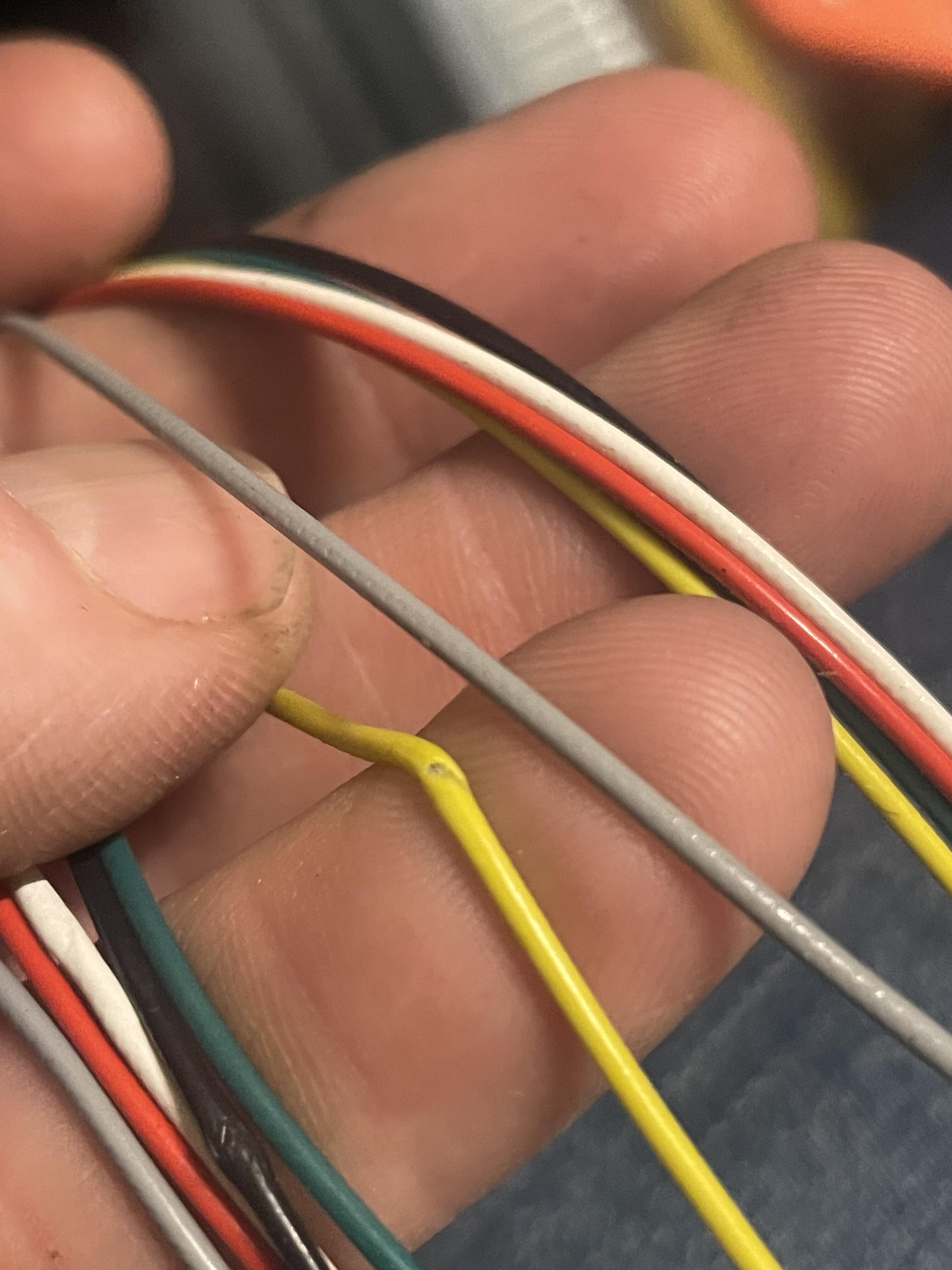

My friend swapped my clutch and fixed some bugs.
But putting my center console back in, he pinched a wire on the o2 sensor. Shorted and burnt my dual o2 can sensor up.
