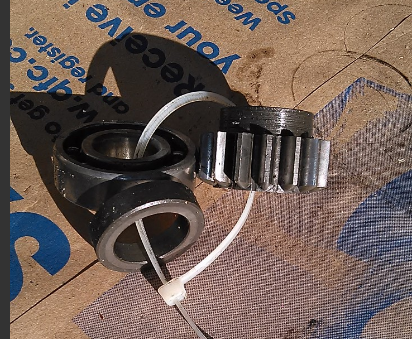

The bearing and spacer must have been in the vicinity when i took it apart  Maybe the spacer positions the small gear to match the other gear, and that's where the noise is coming from.  You might need the spacer too.

spinning the correct direction results in the tick, reverse the direction and no tick. I used the mechanic stethoscope to trace the sound back to the back side of the bearing plate, then down to the reverse idler shaft. Confirmation was done by removing the idler gear, no more ticking. For those that may not recall I had a chewed up idler gear, Zed Head was kind enough to supply a replacement (NLA 23t gear). I used that idler for the rebuild. It would seem that best practices would be to always replace gears as a set, it seems the counter shaft (small gear pictured above) needs to go with the orig gear. I temp replaced the old chewed up gear and no more ticking. To further test the directional sensitivity of the noise I remounted the mis matched gear but did it backwards, resulting in the ticking now happening when the input shaft was rotated backwards. There must be some odd wear patterns that result in the tick with the mis matched set, hopefully the gear above will resolve. in case anyone wondering the reverse idler will not work when mounted backwards, at least not without some machine work and or thrust washer changes and then you still have to grind the teeth so they will engage the slider gear.
I just examined the two idler gears under bright light and a magnifying glass. the old chipped up but no ticking idler gear shows noticeably more wear by looking at the back side where the gear teeth are cut flat (the front side is rounded more to help engage the non syncro reverse gear on both gears by design, so looking a the back side make for easier comparison). I assume the countershaft gear has a like amount of wear. I therefore would guess the uneven wear is setting up some kind of impact that is resulting in the ticking.
Do you think it will tick when it's covered in oil?
I can send the little gear out.  Should fit a $6.45 USPS flat rate box, I think.  That way it will end up in your mail box instead of porch.  Do you want the spacer?
don't need the spacer or bearing just the gear. I don't know as I did not try it with oil, but I did tick even when flooded with oil during the assembly (I literally poured gear oil on it while I was testing). It was actually louder when the assy all back together (before I took apart to start searching for the source of the tick), I guess with the bearing plate bolted to the alum it just acted like a sounding board. After the noise sidelined me on the 1st try I did not want to put it all back in with any known problems. That being said I do not recall ticking but more a loud grumbling noise which I assumed was bearing noise. it was so loud it prob would have drowned out the ticking if it was there thru the oil. when I 1st got it and did not do anything but seals and the gear, I did not do an extensive bench test for noise. It was not quiet and I assumed that was normal, much better now, but for the tick (that's all I hear, before there were other noises as well, part of my lack of experience as to what "normal" is.
