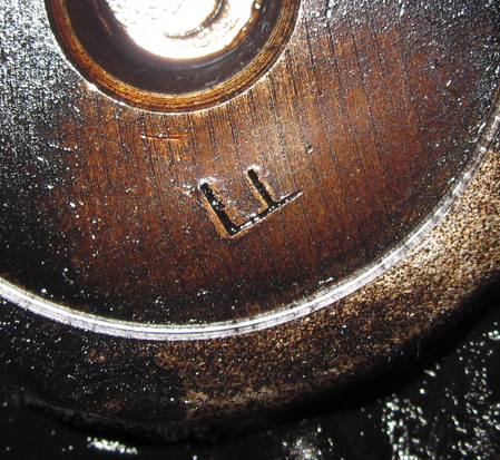

Is there a letter stamped in to the back?  Nissan ID'ed the cam profiles with a letter.  Turbo profiles are generally different from NA, but the early turbo engines were pretty primitive.  Nissan may not have used a unique cam profile.

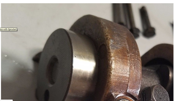

If you have the link to the eBay page we can inspect the pictures.  It would be a straight swap, and would work even if the profile is different.

Check out the link below, it has everything Im missing.. Wondering if this would be a straight swap....
What do you guys think?
Many thanks
JD
http://www.ebay.co.uk/itm/1983-Datsun-280ZX-Turbo-Camshaft-Clean-Nice-with-Sprocket-/222640225402?hash=item33d6643c7a:g:fL4AAOSwa4FZtH
atlanticz's site (where's formerly Blue been anyway?...) has cam specs listed.  That eBay cam might be an M.  Or a W.  Doesn't like Nissan really spec'ed a top or bottom when stamping them.  Mine's an F.  But, either way, the specs are not radically different.  Probably the way they are mainly for emissions.
It will certainly work, but you might be leaving a few horsepower behind.  Might not even notice.
