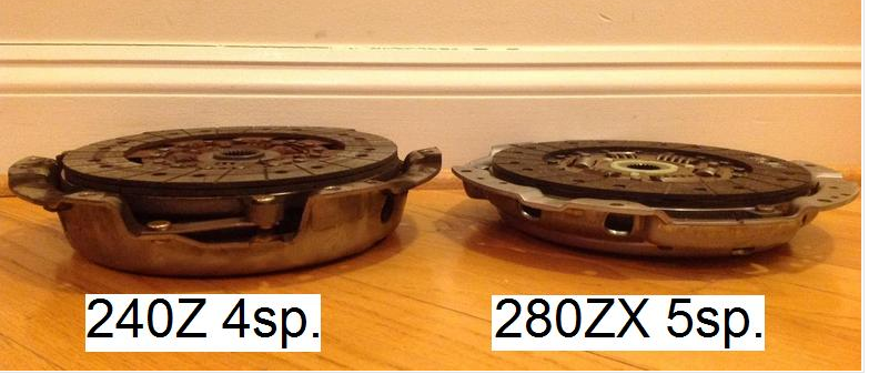

Is that dimension supposed to be measured with the pressure plate bolted to a flywheel and a clutch disk in place? Or is it sitting free on the table (like the yellow one in TimZ's pic)?
The reason I ask is...That dimension would be different if the pressure plate springs are compressed squeezing the clutch disk, right? I think that measurement would be greater laying loose as opposed to bolted in place.
Not sure how much different it would be, but Diseazd's pic shows a measurement "as installed on a flywheel with a clutch in place."

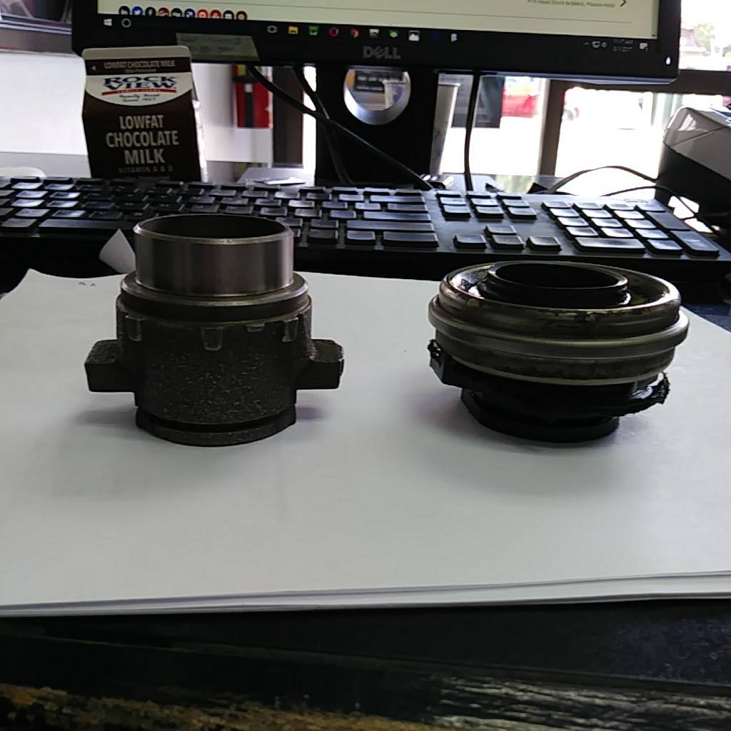

Ok since i just went thru a similar issue i can tell you if it only shifts when off (when your flywheel isnt spinning) then your collar/ sleeve is too short...its not reaching the pressure plate to disengage the clutch to allow you to shift freely.
There are several lengths of collars...it looks like you have the shorter 240z collar which works with the 4 speed and adjustable slave cyl. But you have a late model ZX 5 speed...so you need a longer collar to reach your pressure plate.
Look at what the previous ower had in my Z . the correct metal collar is on the left..the incorrect plastic one was what i found in my car when it melted...20170801_111704.jpg

It doesn't matter which tranny you have.....early 4 speed, early 5 speed or 280ZX tranny. They all have the exact same dimensions. The only thing you have to be concerned with is the clutch pressure plate that you use. If you use a 240Z pressure plate, use the 240Z collar.....If you use the 280Z or ZX pressure plate, use the 280Z or ZX collar. If you have a 240 mm flywheel, you'll have to use the 2+2 (turbo) collar. It's that simple.....tranny doesn't matter....clutch pressure plate determines the collar you use.
I don't understand what the diameter has to do with it. My flywheel is 12 inches total diameter, counting gear ring. Now what ? Should I use the turbo collar ? The turbo collar is shorter ( 34.55mm ) than the ZX collar. Is that right ? Should the collar be shorter or longer ? Thank you
