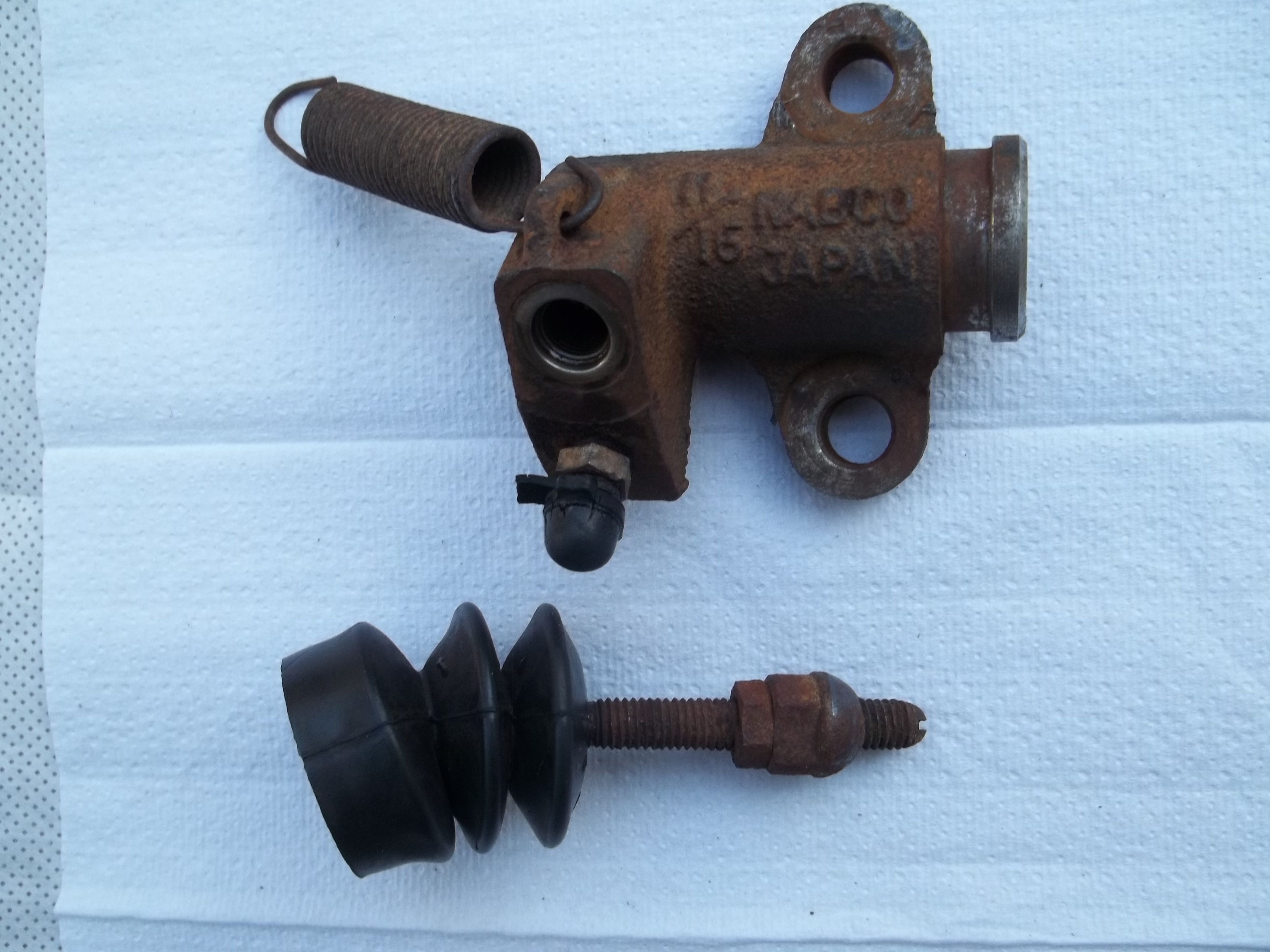

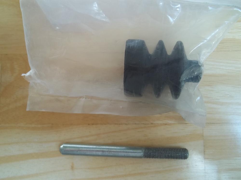

Second point, I just took a clutch pack/throwout sleeve out of a 72Z that was a good 10mm too short than the ideal 92mm. The clutch was working. PO's had kept the original shorty sleeve the 4 speed came with the last clutch change. How can this be?
The way it was made to work, was by a crazy long clutch slave rod. It was also the early style that have the pass-through-the-fork ball tipped end so you adjust the effective rod length.

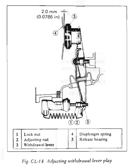

Hope I wasn't too blunt earlier.  The clutch control is actually very simple once you dig in to it.  The reason that the same measurement works for all combinations of engine, clutch and transmission is because the slave cylinder bolts to the tranmssion in the smae spot on all transmissions, and the fork pivot is the same height, and the flywheel surface is usually the same distance from the mating surface of engine and transmission.
Here's a diagram from the 1972 FSM showing the relationship of all of the parts, with the adjustable rod.  You can see how the angle of the fork needs to be the same (edit - unless you have the adjustable rod.  But Nissan got rid of that, probably to hold the best angle for the slave cylinder travel) because the slave cylinder and fork pivot can't move.  They're fixed.  So the fork at the collar is always starting in the same spot.  so you have to adjust the collar to make everything work right.  It's all about where the end of the fork starts its movement.
