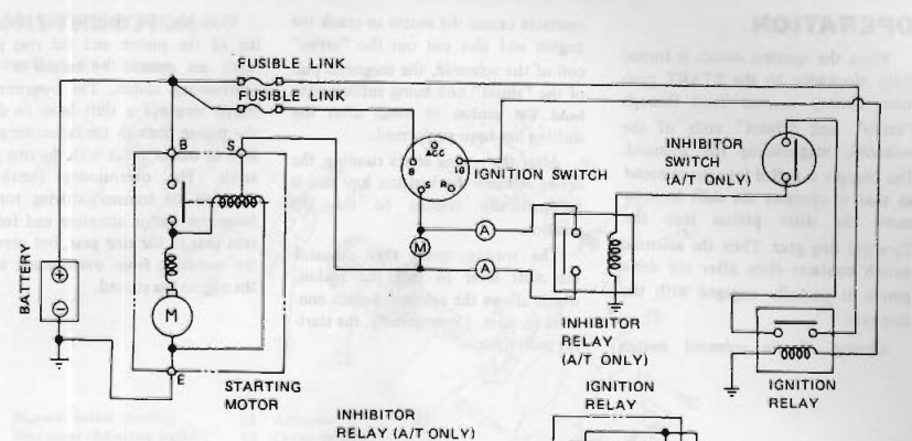

Agree with Dave that more testing would have made things more clear.  Still not really clear why the "slow turn" worked, and why you saw spark, but it wouldn't start.  There's only the ignition relay and the starter motor involved, unless somebody modified your wiring.  Won't be surprised if the problem reappears.
