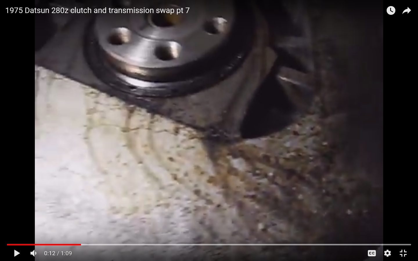

If this stops it then I can be sure the rear main is ok after my initial fix, if that is the case then when I finsh the 5sp rebuild I will NOT have to pull the clutch and flyhwheel again to look and see, as per seen in the video. IIRC the leak shows up pretty fast from a clean start so one good trip should be the test. if there is a hint of oil, I will pull the clutch/flywheel next time just to see if I can figure out what I am doing wrong. The oil leak  presented as oil right at the back of the engine on the side where the starte is, consistent with what appears to be a leak in the snip of the video.
