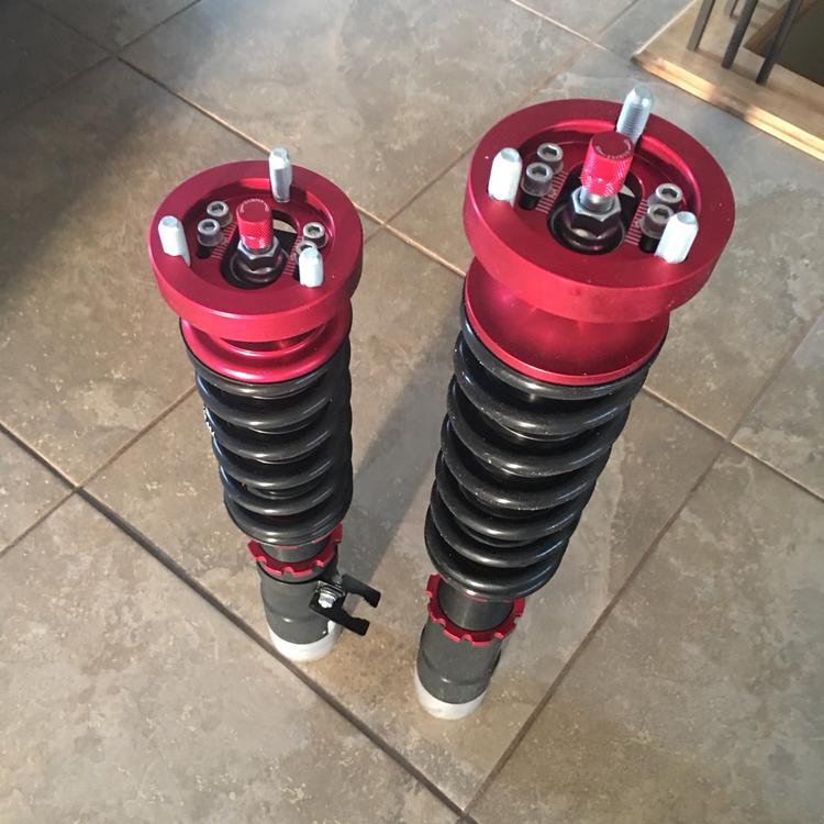

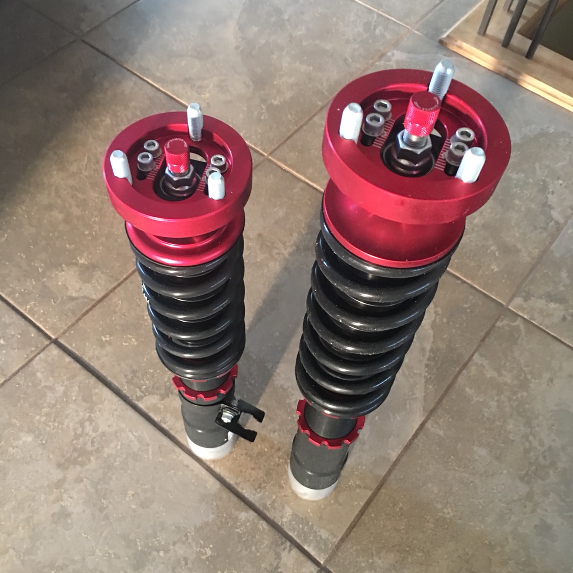

FINALLY got my Stance coilovers from Sakura Garage in the mail. After an original ETA of 2-3 weeks, they showed after 3.5 months BUT turned out to have the wrong adapter sleeve (2" for the 240z as opposed to 2 1/8" for the 280z) so I have to send the sleeves back to get re-machined. This is a can o' worms that I don't really feel like typing out, but I'll shorten it up and say that it has been nothing but a huge hassle so far.
At least the coilover quality looks very good. I can't wait to get them installed!

Have to send these back to get machined out! >:(
