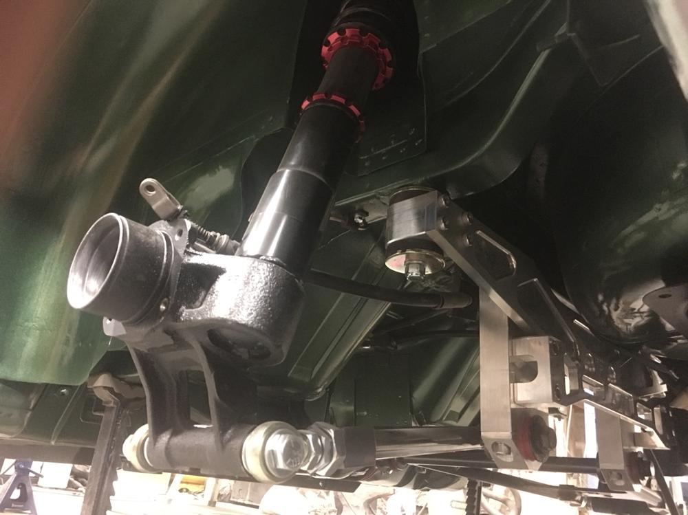

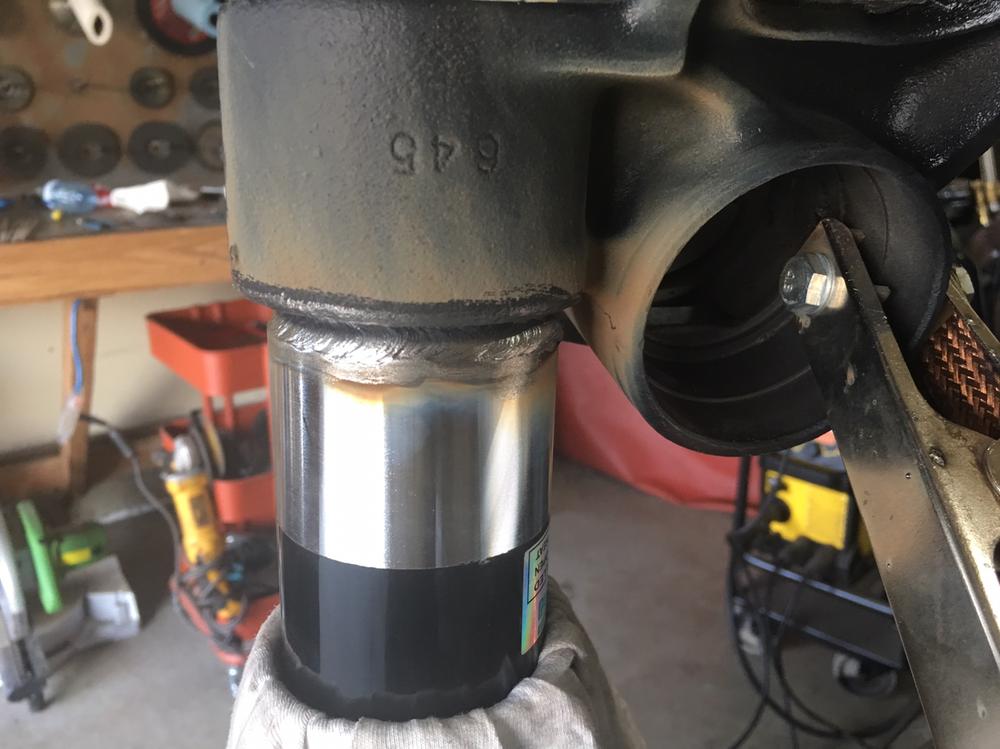

HOT DAMN!! I'm finally getting near the end (I'm probably gonna say this on 3 more posts - everything takes longer than I expect).
I took my struts to 425 Motorsports along with my new coilover adapter sleeves. They disassembled the struts, tossed the old stuff, cut them (1" above hub in front, 4" up from hub in the back) and slid the adapter sleeves on so they fit 1" over the old strut tube. These guys may not be the cheapest, but they are well renowned in our area and definitely do great work. You can tell by the quality of the welds alone.

Any reason that they cut the rears at 4" above the rear strut tube? Mine were cut and welded 2" above the stock tube. But then again, my rear coilovers were significantly taller than the the fronts. Were yours the same height front and rear and the stock tube is needed for the height offset?
For my car, the rear struts were right at 3" taller than the fronts, both on the car and off the car (as measured with a tape measure).
Not sure what coilovers you have, but my STANCE coilovers came with four 6" adapter sleeves, which means I had to cut the rear a bit higher compared to the front to keep the offset/rake similar to stock. I plan to keep it at stock height or lower it maybe 1" - 2" at the most, so I didn't need them to be cut super low.
Mine are CX Racing coil overs and the picture of them are in the thread a few posts back. I think mine were manufactured to stock heights so I could flush mount and weld them at the collars for the most support.
