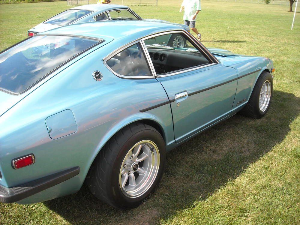

3 hours ago, esmit208 said:
If they stick out you can count on them touching, normally at speed over an abrupt depression. Could be enough to take the paint off to the metal or cut through the sidewall. Trust me I've been there.
This car was at ZCON a couple of years ago when it was held in Toronto, I mentioned to the owner that I loved the look of the tires sticking out a bit but was leary of doing it myself for fear of bending the fenders or cutting the tires, he said he didn't have that problem. I checked, no paint removed, no cuts in the rubber, he got the suspension just right. His tires were 1.5 -2" out side of the fender, wish I could remember his name, maybe someone will recognize his car.
Well I hope between my coilovers and fully adjustable TTT control arms I will be able to figure something out. The last thing I want to do is tear up the fenders of this car! I'll post my results after some experimentation.
