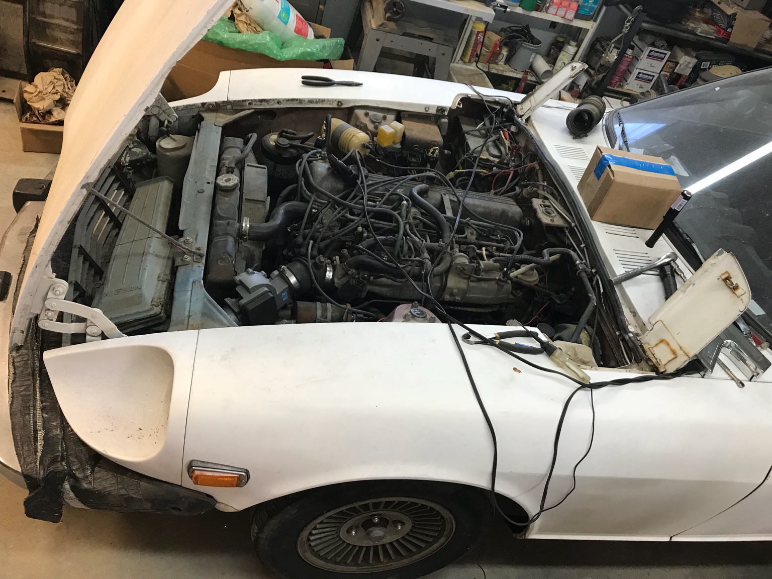

Bought this car for $600 for parts thinking the body was hammered. It sat as a yard ornament while I worked on another project. Pulled it into the garage yesterday and started fiddling.
First, went to drain the tank and found it was empty (just a few drips). Then the fuel pump wouldn't turn. A whack with a rubber mallet solved that.
Then, it turned over, but the injectors weren't triggering. Opened up the 280-Z Fuel Injection book and went though every circuit (why not, save the frustration for later). Traced it down to the distributor trigger and went through that circuit. Not sure which wire was the issue, just cleaned them all.
Then it started!
I assume the engine was replaced with a Japan import cause it has a crank trigger assembly (I already had one of those).
This was a great find that will take some time to fix up. There's bizarre wiring bypasses. For instance the headlights and parking lamps are run by a toggle in the side of the console. PO also ran a wire from the battery, along side the hood cowling and under the dash to bypass a dead power wire.
Otherwise, the car's in better condition than my daily driver. Very little rust, decent carpet, heck the AC works! Then there's the 79-83 five speed.

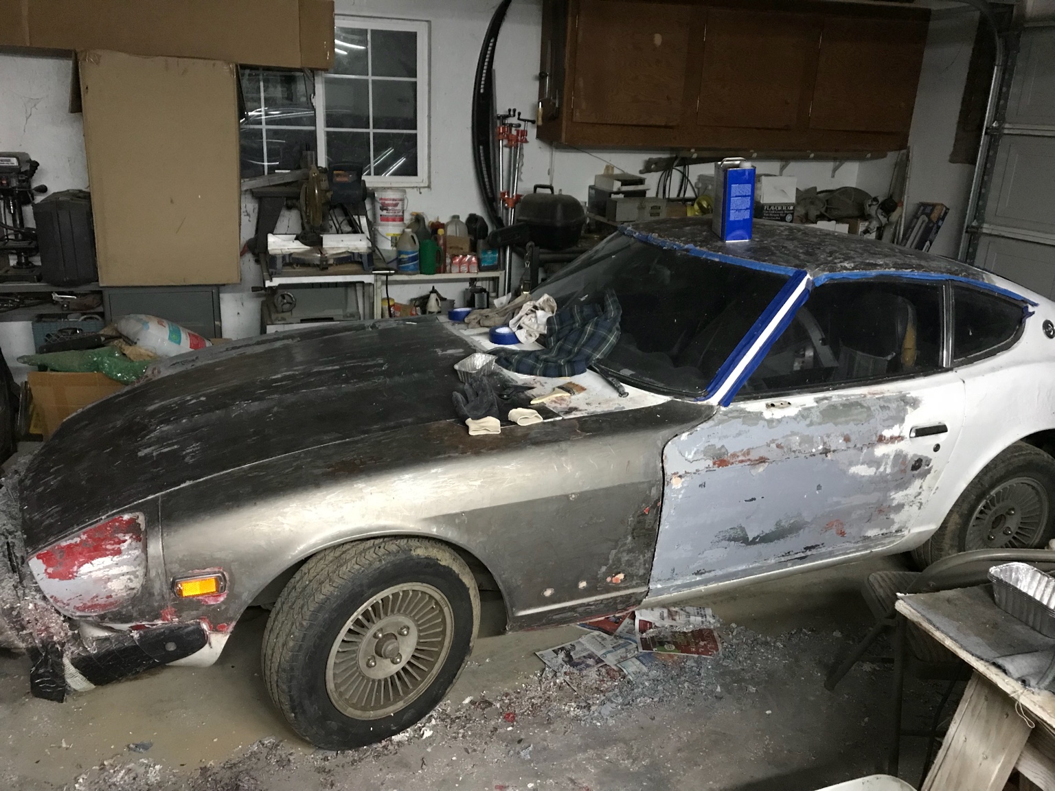

Making progress removing the multiple layers of paint. The original color was gold found in the interior underside of storage lids. At some point the car was stripped and painted fire engine red, then painted white. Kleen Strip Aircraft Paint remover works well, I have a can of Eastwood coming soon, we'll see if that makes a difference.

More progress, more history uncovered. The car has been at least four colors, originally gold, teal, red, and then white. I’m planning metallic wine. There’s bondo in places it didn’t belong and not done right in others. Amazingly very little rust!IMG_1961.JPGIMG_1959.JPGIMG_1958.JPGIMG_1957.JPG
