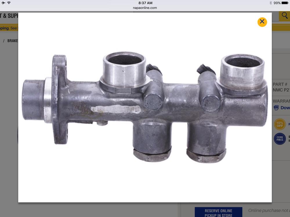

Does anyone have any experience with the remanufactured master cylinder available from Napa? From the photo it looks just like the OEM with the name scratched off.

Have them bring it to the store, if it's a stock reman then you are good, most likely it will be a knock off.
