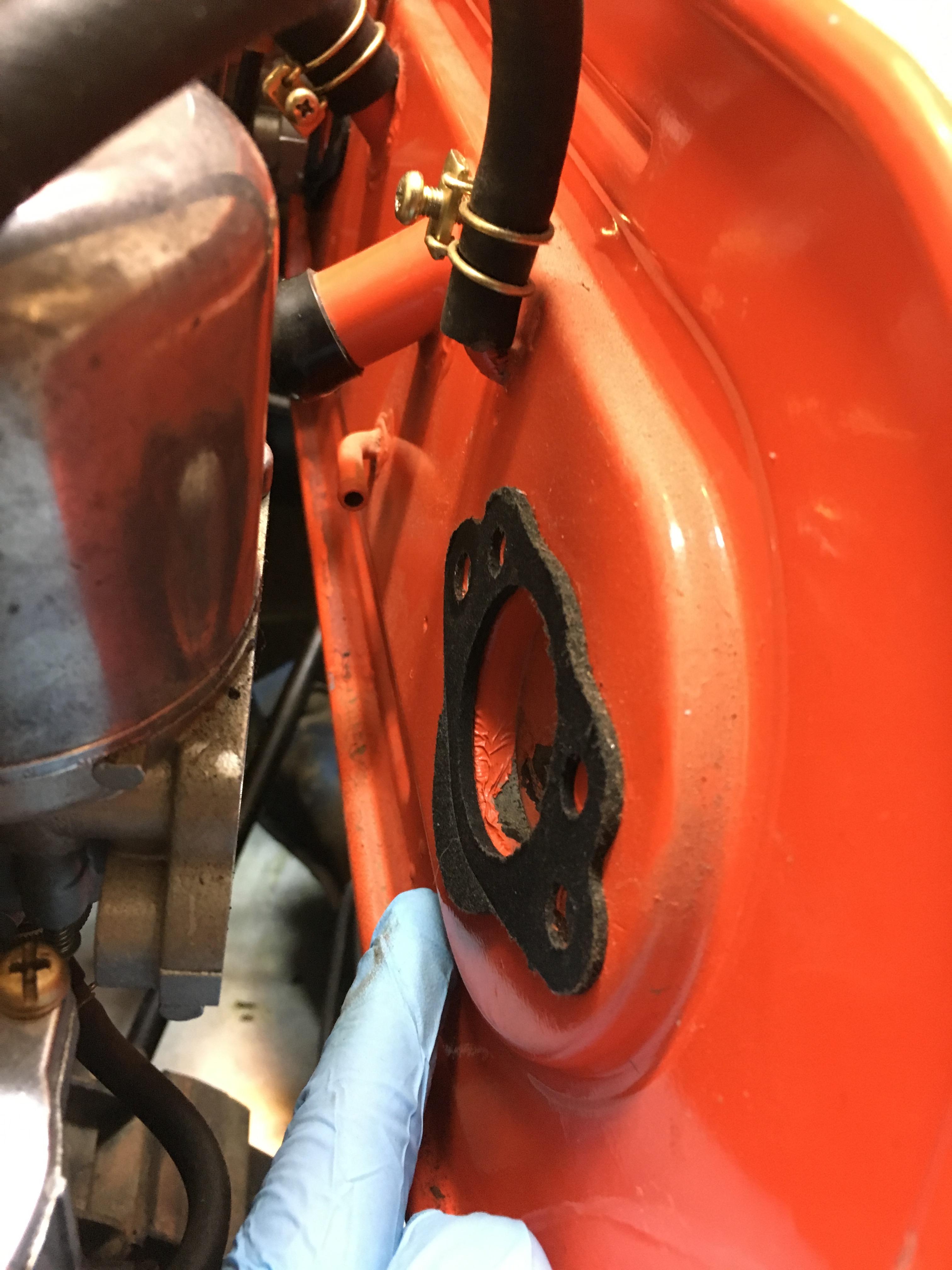

I got the exhaust finally installed and started the car up for the first time in a year. I removed the air filter so it was easier to work and I noticed that both air intakes were dripping gasoline.
 Upon closer inspection the backside of the orange air filter housing also had gasoline being deposited on it. Where you see my finger touching is the location the gasoline was dripping down on both from both carbs. I’m guessing the gasoline could be penetrating the gasket on the intake to the orange housing?

I would guess you've got at least one, maybe two stuck float valves. When a float valve is stuck open, it feeds gas into the air cleaner housing.....just like your picture:wacko:  It's normal for the float chambers to move.

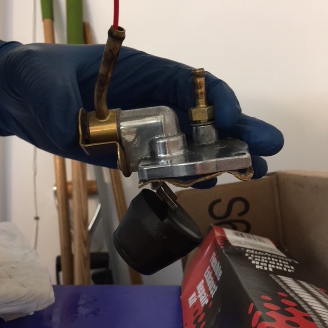

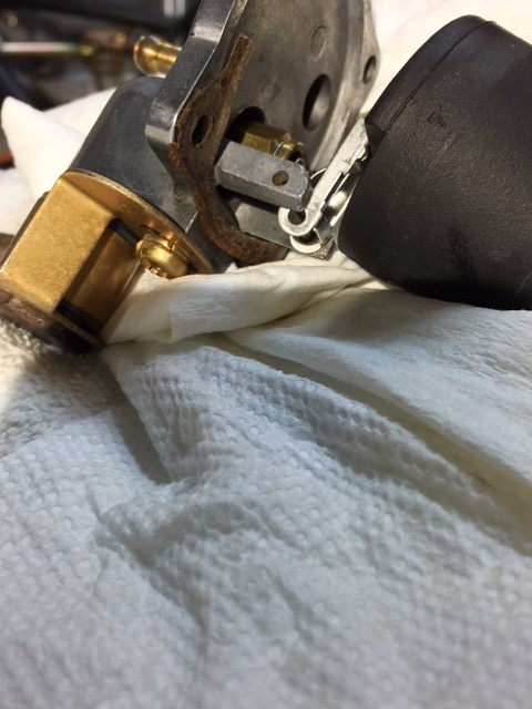

I removed the float bowl covers and drained and cleaned the bowls and flow control valves with B-12 Chemtool. I sprayed into the fuel feed tube and turned it over to drain. I did that several times and hopefully that removed any possible sediment in the control valves. I have to replace the cork gaskets as they are falling apart.
I did notice that the pin that secures the float bowl slides without any sort of stop or tension. I don't know if the sides of the bowl prevent the pin from sliding,  or if this is an incorrect pin.

I think that the pins are held in place by the sides of the bowl.  Once assembled they can't get out.
Have you examined the valve itself?  As I recall, they're typically a rubber coated pointy piece that sits in a precision ground hole.  The float presses it in to the hole as it rises.  The rubber can get hard or take a set or have a groove worn in it over time, and not seat properly anymore.

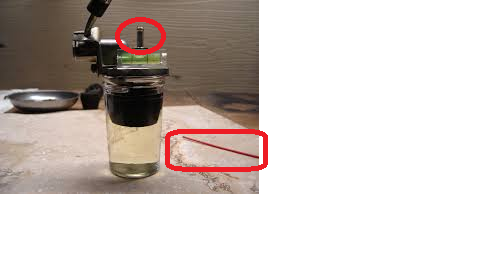

You put the straw in the wrong hole.  If you'll look, it's too late now though but, the straw in the other bung would hit the top of the float and push it down unsticking a stuck float.  Those pins cannot slide out when the lids are mounted on the float bowls, there's not enough room on either side to slide out.  They will hit the float bowl housing.
