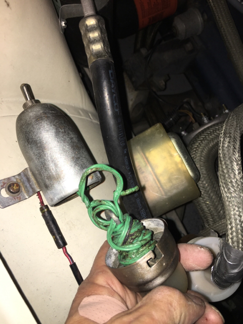

  Some of my own troubleshooting techniques are done as much for entertainment and learning as they are for fixing things.  Some of my techniques I would not want to publicly disclose!  (no I don't use a ouija board)  Anyway how about hooking up a test light across the fuse, maybe at night and then gently feel around under the dash and push the wires around looking for a brief change in the test light brilliance.  Just an idea.  The FSM seems to show that 12V for the lights goes two places, from the fuse to the combo switch and also to the inspection light under the hood.

....The FSM seems to show that 12V for the lights goes two places, from the fuse to the combo switch and also to the inspection light under the hood.
 Voila!!! That was it.. the inspection and probably due to melted wiring. Totally forgot recalling reconnecting it and I guess this was the reason why it was purposely disconnected in the first place. Feel a little embarrassed with all that diagnosis. I was getting frustrated but sat down and reread the replies.
Thanks so much EVERYBODY [emoji4]
