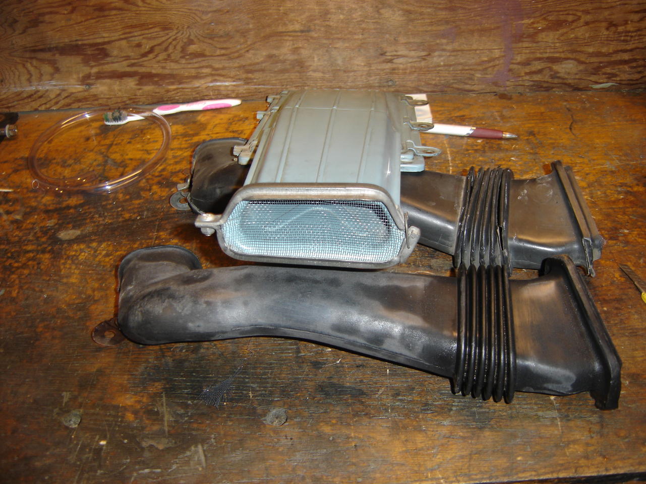

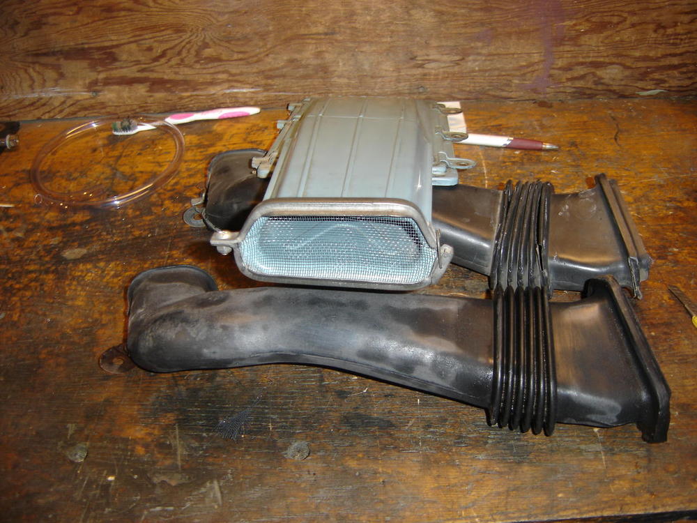

Where can I find the connecting rubber that goes from the air box
That piece on the left in your picture is made of hard plastic.  Is that what you're looking for?
