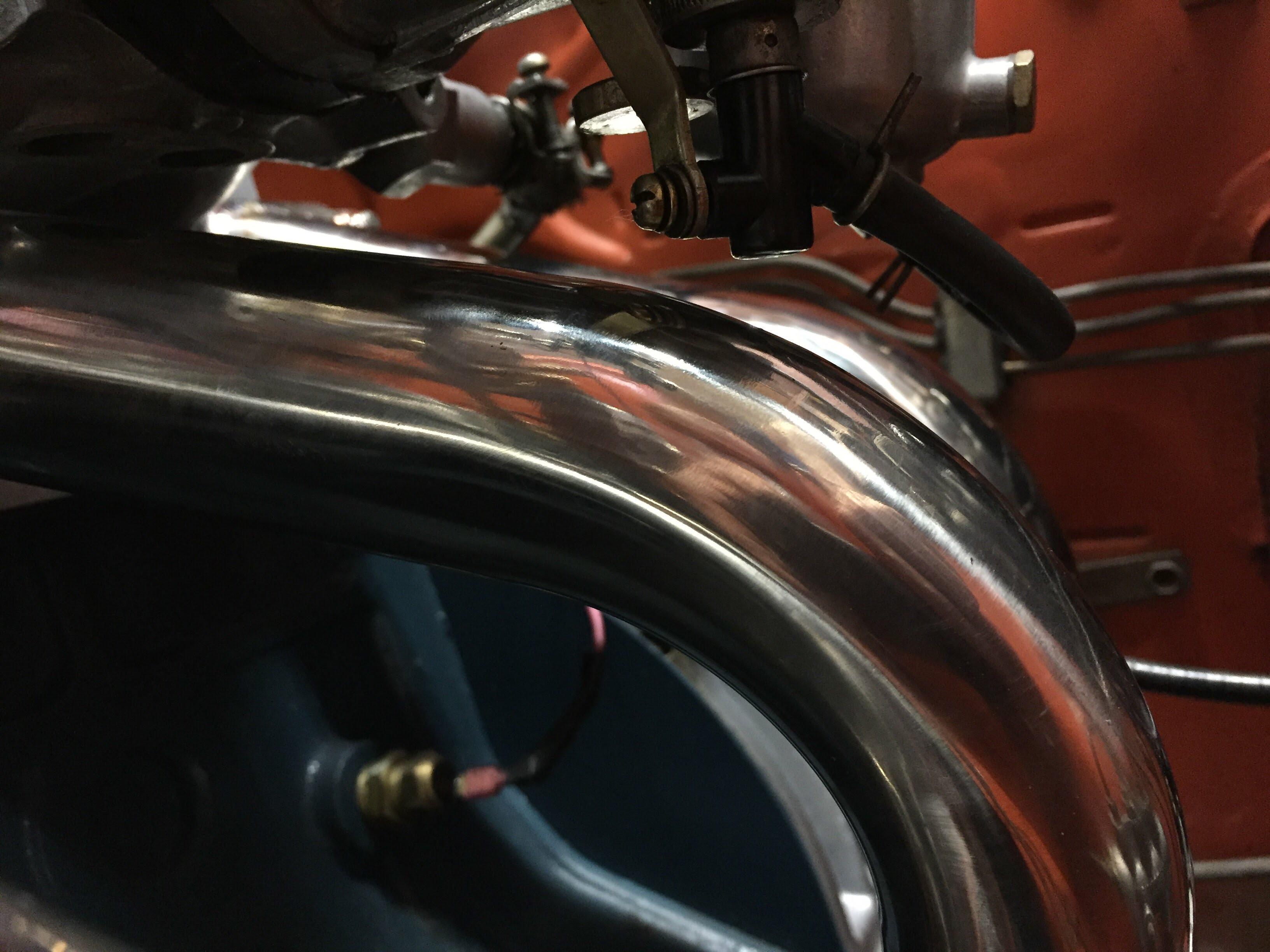

my short story is I purchased the full system with the JDM muffler. installed with no issues except the number six tube is so close to the Lower SU hose I never felt comfortable. Sean then sent me a Race header where the six tube is away from the SU. seemed okay until I installed it. The lower tube contacted the driver side frame. Tried everything I could to move things but nothing worked. Someone else here had the same issue. So I abandoned the header idea. Too much trouble for a basically stock engine.

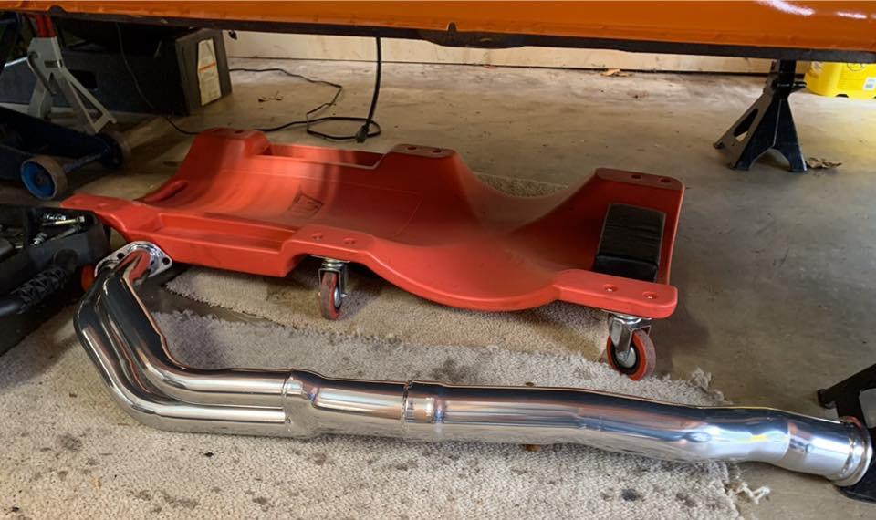

@S30Driver During my process I discovered my original down pipe flange was bad. I had a new one that had already been converted to 2 into 1,  2.5” Pipe. I bought clamps that matched Sean’s clamps installed it then had a local shop match the two together. They did all of the welding (very tidy). Here is photo after ceramic coating.
