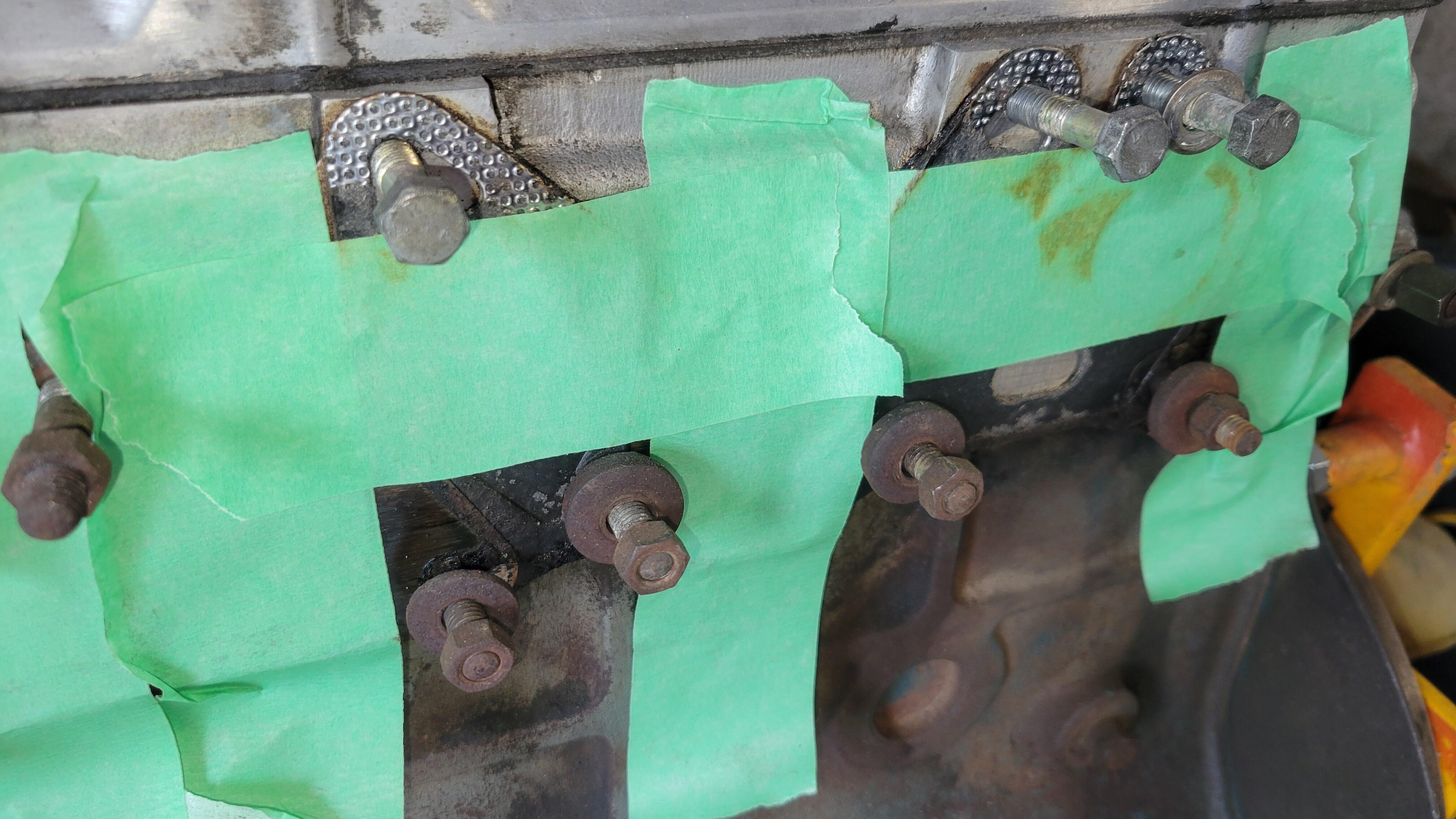

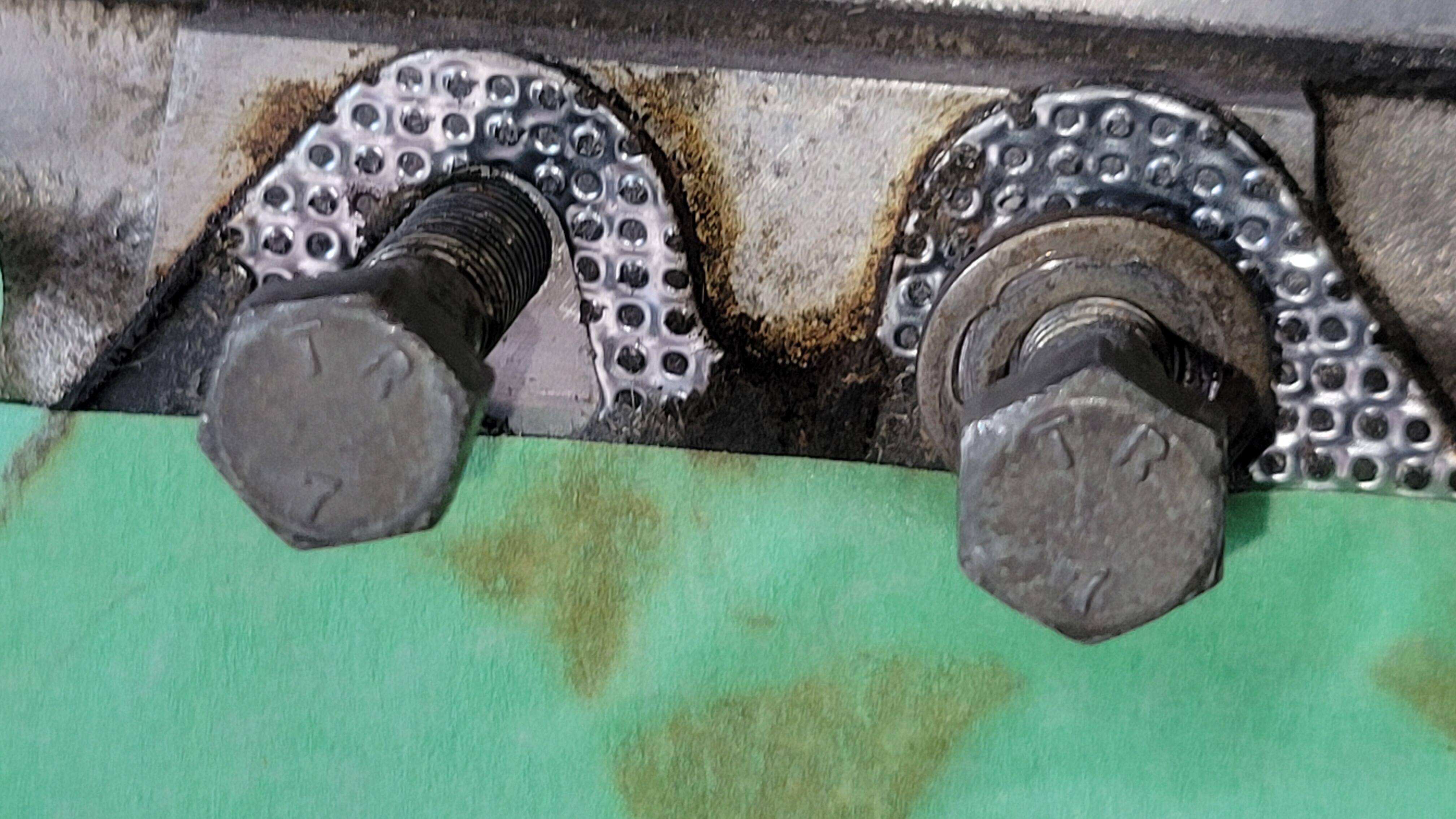

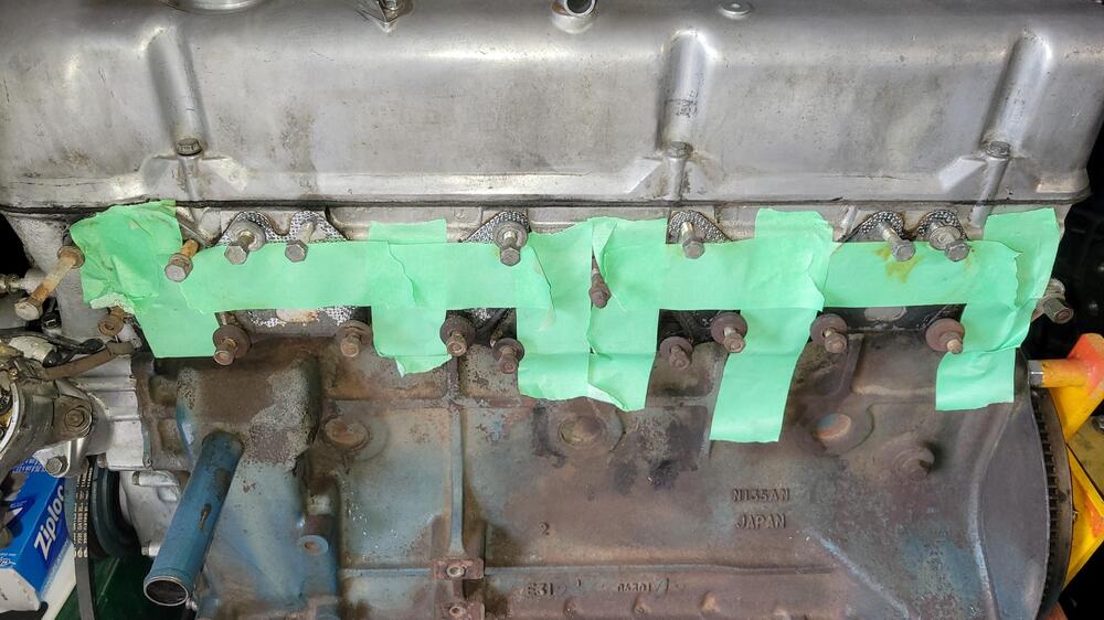

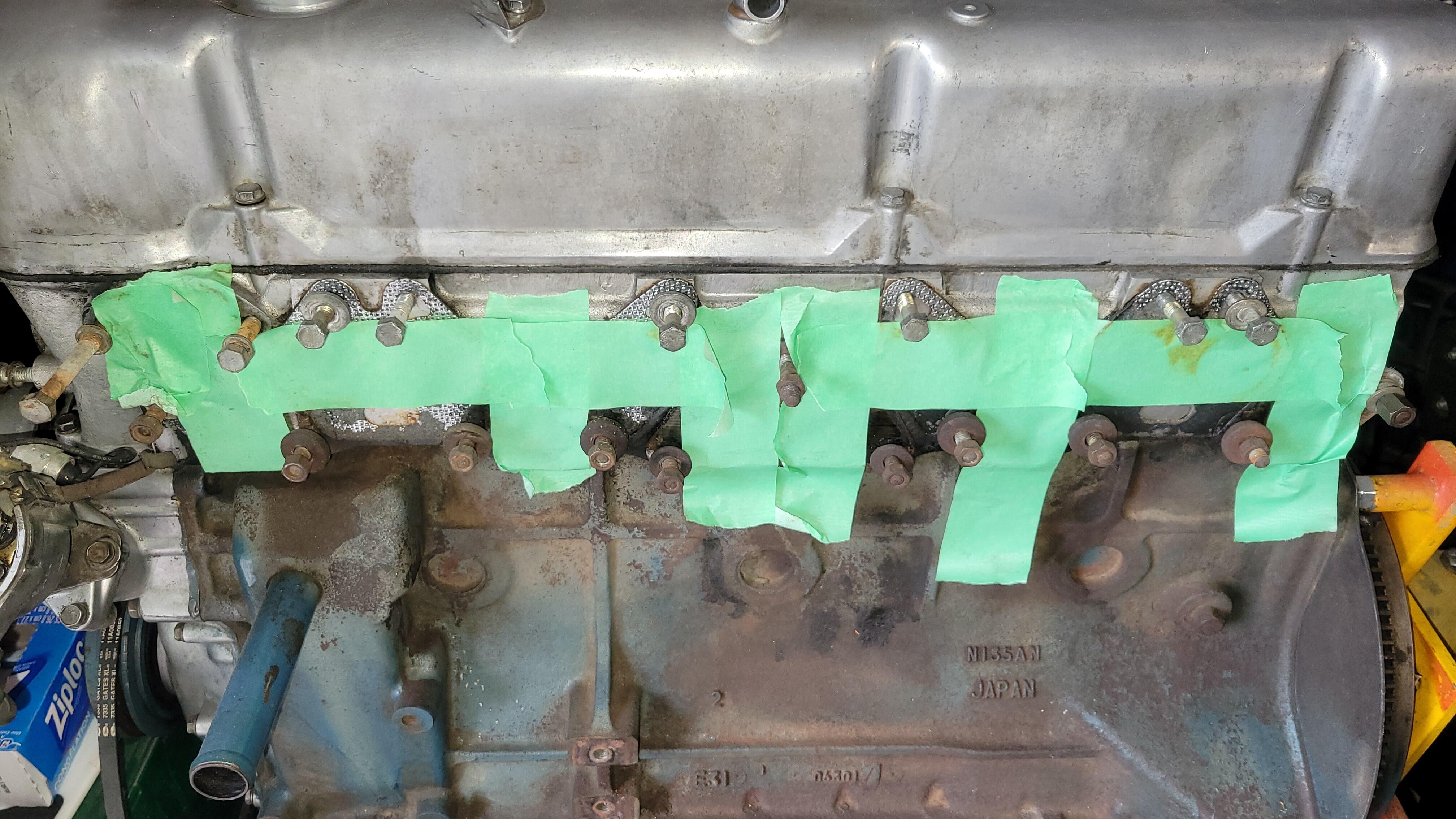

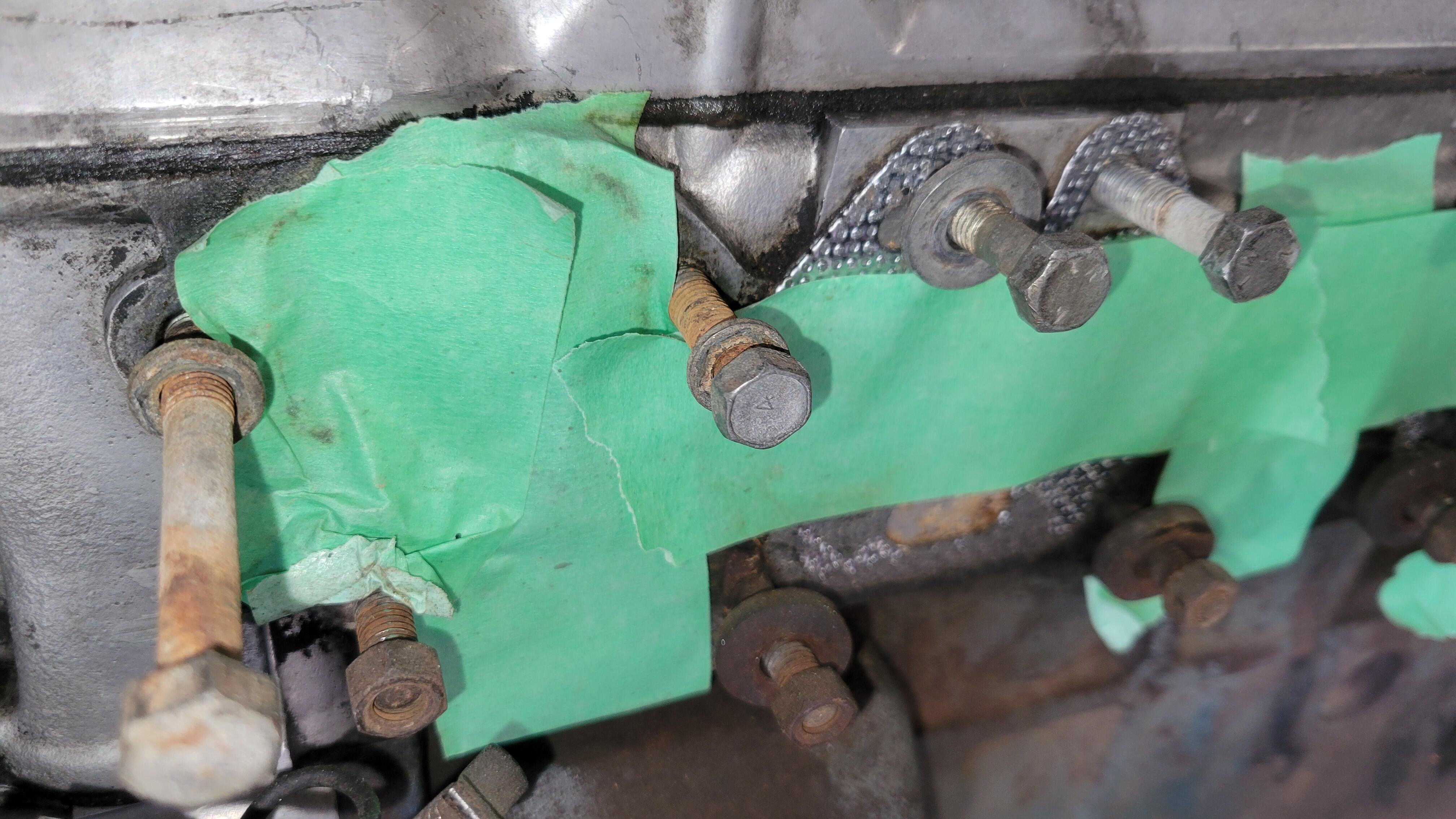

Here are some pics from my 7/70, after removing the intake and exhaust manifolds, I replaced the hardware in the locations that I found them. No lockwashers are used, except for the two capscrews that attach the thermostat housing. The thick exhaust manifold washers are 23.6mm OD x 9.0mm ID x 6.1mm thick on mine. The intake capscrews have "7" and "T" and "R" marks. Hope this helps.
13 minutes ago, inline6 said:
Yes, that is helpful. What is the diameter and thickness of the flat washers used on the exhaust manifold only? Looks like 5 total - 1 front and 1 rear and 3 in the middle.
The thin ones are 21.5mm OD x 8.5mm ID x 2.5mm thick. Over the next couple of days I will mark up a picture with the occurrence of each type and post it here.

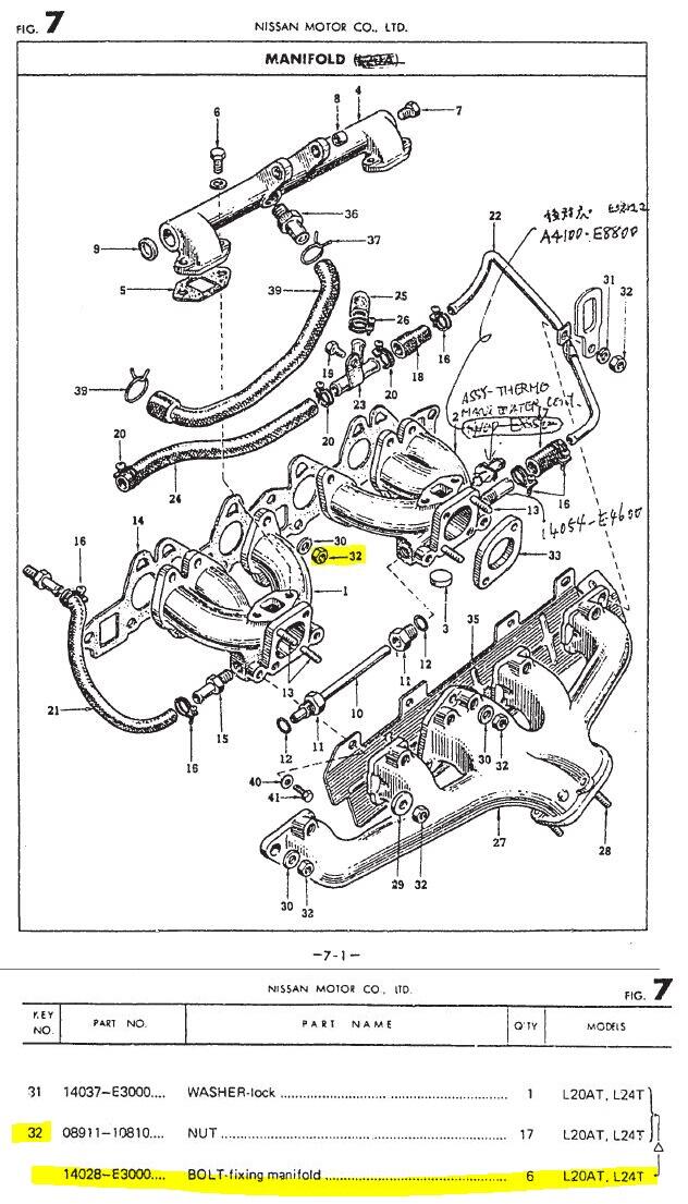

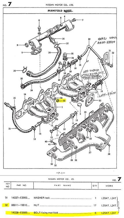

@Namerowregarding your original post about studs vs bolts for the upper six intake manifold fasteners, I found something interesting in the 1973 JDM S30 parts fiche. The nut (item 32) is described by two options, one a nut and the other "BOLT - fixing manifold". These pages are for up to 1973-2. Not exactly clear but interesting none the less.

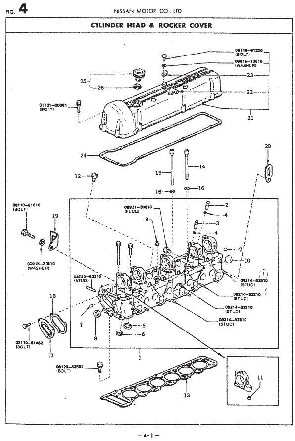

The studs are shown on a different page for the cylinder head,
The JDM parts book has great illustrations and in a lot of cases more detail than the N.A. parts book.  It can be found here:
From you picture, I see that of the 6 T R 7 bolts, only numbers 1, 3, and 6 have flat washers.  The other three didn't have a washer... of any kind?  Do you know if your intake manifold has been taken off at any point?
