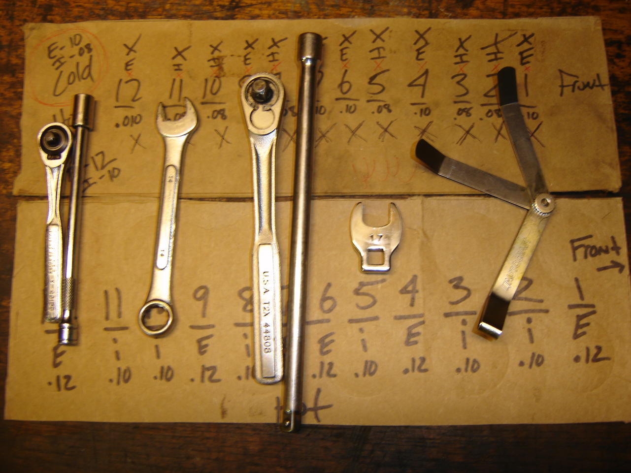

Here's a picture that shows something that helped me when I first started doing them.  Write it all down on a piece of stiff paper, I use beer boxes, and mark them off as you go.  They come up almost identical two at a time, so you can do those two and rotate again for two more.  Speeds it up some but after trying the hot way I've gone to just setting them cold, lazier in my old age. :D
