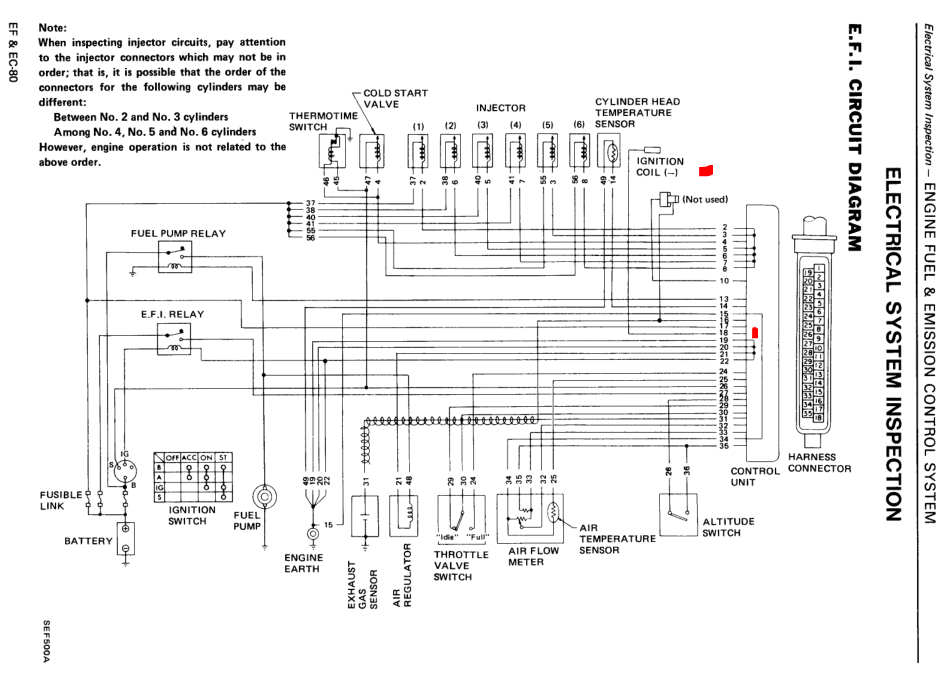

Hi, so it was a late one last night again and the car still won't start.
Me and my friend followed the  Engine Fuel and Emissions chapter of the FSM.
The first thing we tried were the #18 pin to the negative post on the coil as Zed Head recocmended and  that path is clean and useful..
So I colored that pin with a pink marker, and kept on going.
As you can see on the img that I uploaded:
1. Engine earth is great.
2. Throttle valve switch works
3. The EFI relay works (the green relay under the plastic cover next to the battery)
4. Air flow meter seems to work
So I really don't get it. Today I think I might leave the rails with injectors hanging loose just to confirm with my eyes that the injectors wont fire, now I'm desperate. I'm almost 100% sure that they don't but I have to see it. After ofcourse I try with a lamp connected to the injector clips, if the lamp wont work then ofcourse the injector hemselfs wont fire.
Any other tips?
Thanks,
/ Jimmy
Ps. I tried with another ECU last night, didn't do any good. This was a ECU from a -78 so the ground from ECU to the coil are on the #1 pin ( I think), so I cant exclude that there might be something wrong with my ECU just yet. Also my ECU connector is wierd, there's a cable that goes from yellow to blue, the same blue as the cable that later goes to the negative post on the coil, but that path is wotking so.. And there's a cable tie there so someone has probebly messed with this before. In Sweden a cable tie is called "Kattstrypare" wich directly translated means "Cat strangler", that won't help anyone out at all, but I thought I let you know anyway.

We've done a continuity test and measured resistence between coil negative and pin #18 (0,1 ohm) AND we also applied signal with a cable fault locater/circuit tracer detector and resived the signal at pin #18, and yes it is the lonely cable beside the wiring connector.
Also finally got a nod light and just as we figured, the injectors don't get any power. The nod light works but not when put into the injector connector.
As far as the fuel pressure goes, there is a return line so how much pressure can it be? We have a good flow coming from the return line rail. The fuel pump have no voltage on the connector so the pump is connected directly to a battery.
I dont think its loosing spark but no its not getting enough fuel because the injector wont open. But it should still run on starter fluid even if the injector dont work right? Its only in the air and doesent the fluid burn up straight away?
