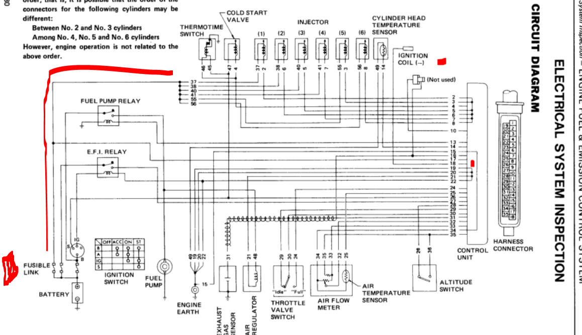

1. The noid light was put into the injector connector because it should blink while I crank the engine right? It didn't.
2. We have measured battery voltage after after after all fusible links, and they are OK.
3. We recently tried grounding each injector with a wire from battery - to respective pin on the ECU wiring connector and all injectors opened. (For the first time while in the car i believe)
4. We also applied battery voltage to pin #13 and the fuel pump started. That's the first time the fuel pump started without direct voltage from a separate battery .
That tells me that the wiring + relays for the EFI and Fuel pump are OK? Am I wrong?
feels to me like we have ruled out the basics and there has to be the ECU or a grounding problem, if there's a grounding problem then it's NOT pin #18 or any of the pins to the injectors of the ECU.

A test that might show you something would be to run a hot wire from the battery to the coil's positive terminal.  If it stays running when you use a hot wire then you can focus on losing the ignition system power.
You might also check for power on Pin 27 with the key on.  That's the power from the EFI relay to the ECU.  If you have power there you'll know the EFI relay is working. You mentioned the click, and the injectors opening but if you look at the diagram is shows that the injector power doesn't come through the relay, it has its own fusible link.  And the relay can click but still not pass power.  I'm not sure that the diagram is correct but it's worth a check of Pin 27.  The ECU needs power too.
Study the diagram and you'll find many small tests you can run for power and ground.  Once you don't find the big easy source of the problem you almost always have to work through the tedious small tests.  But when you find the one thing that's wrong it will be worth it.
Forgot to say also, check the ground circuit for the ECU and EFI system.  There is a separate ground for the connector, you can see it at 19, 20 and 22.  People often get so focused on the power that they forget about the ground.
Edit - the tests I described are all written up in the pages following the EFEC-80 diagram.  Your fuel pump power test above, usng Pin 13, kind of indicates that you're not going through the tests in the FSM.  There's a simpler fuel pump power test on page EFEC-94, using the starter solenoid wire.  The test we often recommend.

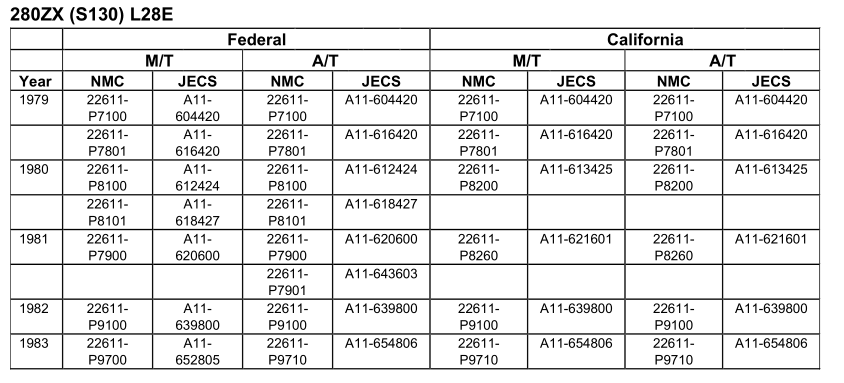

I just noticed what you said earlier about trying a 1978 ECU.  1982 is completely different.  Nissan actually wrote some notes when they changed the ECU's saying "Do not try early ECU's on these cars!!!!"  So that was a bad idea.  Anyway, you need an ECU that's right for the car.  Here's a link to a guide with ECU numbers.  Maybe yours is not even right for the car.  Post up the number.

What does the P-Part stands for? 22611 matches but not the latter.
