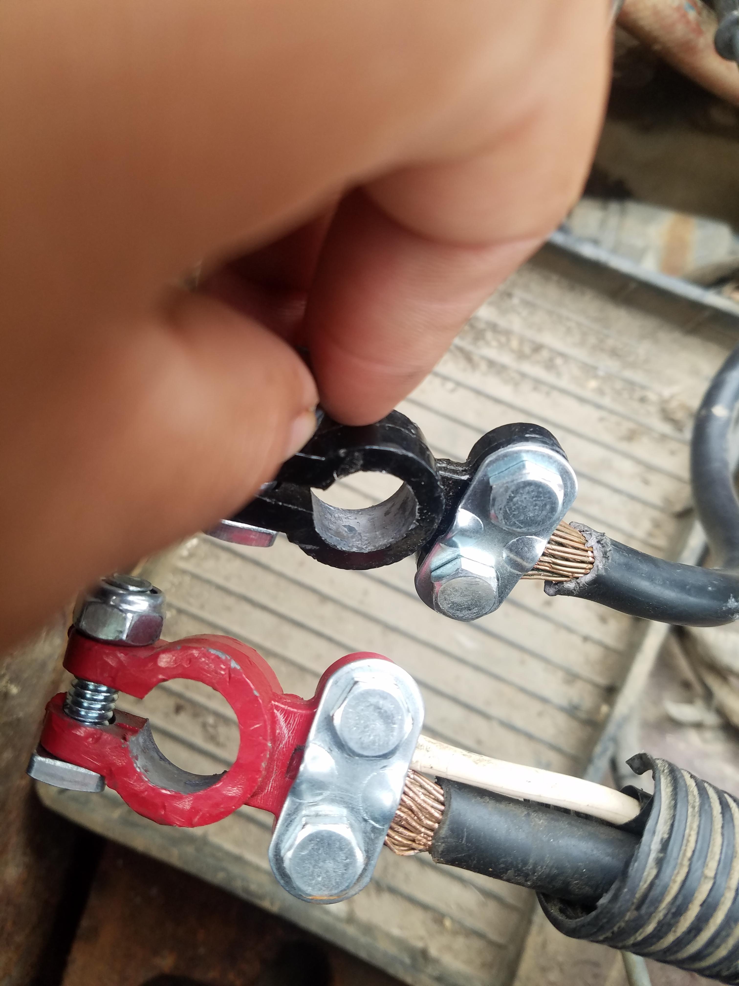

Hey guys thanks so much so i moved the ground also i exhanged my battery for a 650CCA i tried to turn it on nothing second time i tried i heard the grinding noise again people are telling me its a bad starter and also fuel pump probably needs to be replaced and hoses as well add on a fuel filter
Also are my cables messed up?
I usually push the copper wires all the way through the clamp so you can see it on both sides, leaving none exposed.
Take the starter to an auto parts store and have it tested, it's free around here.
EDIT:  leaving very little exposed. ;)
