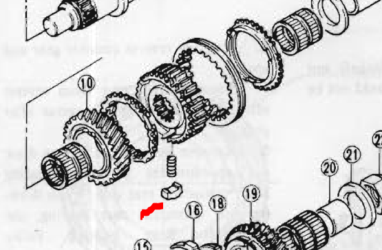

The very small rectangular metal piece with the spring under it.  It does its work under the coupling sleeve, popping up and stopping its travel.  It just looks exposed, to where it might be popping up when it's not supposed to.

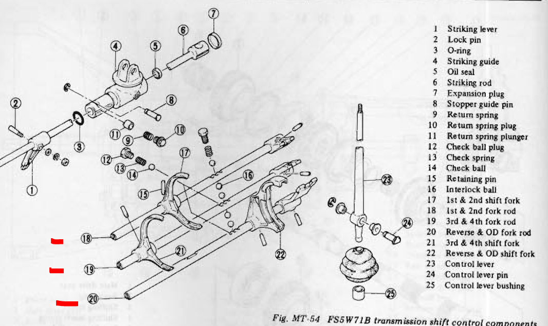

Here's an illustration of the ends of the three shift rods  that are stopped by the front cover.  When you move the lever for reverse the rod is stopped in its travel by the front cover.  If the front cover is not installed you might be getting some overtravel, causing the gear to stick.
Ohhh okay yeah sorry I knew them as dogs. Glad we are talking about the same thing. I agree they do slide around a little bit, but unlike 1-4 gears the config is different and there is no syncro on the Reverse side of the dog holding as close. So I assume the play is a little bit normal?
And yeah your might be right on the front cover aspect I plan to test that here this weekend if I catch up to some free time.

are all the balls and springs installed on the shift fork rods? that should provide a pretty good stop as well. I was trying to use the FSM description of the dogs, that is what I called them as well, but did want to use the FSM terms if you were looking at it.

if you look closely here you can see the dog as the long end towards the back. this is how I have it installed. The key is the dog spring should be directly under the pad (thick part) of the dog.
the exploded drawing is confusing since it looks like its the other way around. I have found problems with the exploded drawing, like the 1st gear thrust washer is shown on the wrong side of the gear, so I trust this image which is also in the FSM for dog setup on the 5th/reverse slider hub.
on yours it seems like the shift dogs on 5 were installed backwards which is why I wondered if it had been worked on. Do the stakes on the shaft nuts look factory (one punch mark) or do they seem like punched more than once (re used). I don't think the dogs on the other gears have a direction but the 5/rev def do.
