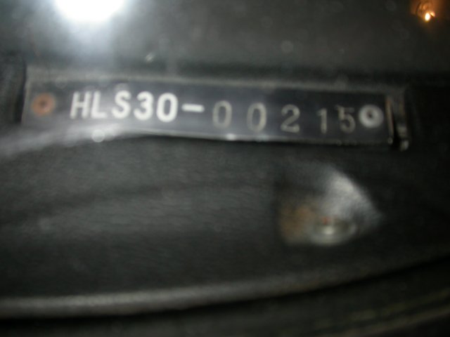

I've got a very early production 240Z, and I was just looking at the seats today. They are in quite good condition (probably been recovered). In my readings about the early Z's, I've come across mention of "rewebbing" seats, and seen pictures of early seats with webbing under the seat cushion that sometimes has to be reaplaced. What year(s) was this done in? I ask due to the fact that my seats do not have the webbing - they have metal springs (see pics). They are 240Z seats - no tilting lever, just the knob to change the angle a few degrees. I know that the PO had access to a parted out 1971 240Z (I have several boxes of parts he collected from it). Could these seats be from the 71, or would an 11/69 production car possibly have the metal springs? Ultimately it won't matter to me, since I don't intend to bring the car back to stock in every nut and bolt, but I'd like to be as close as I can.
Thanks.

It appears to me that your seats used to have the webbing but I'm sure that someone with more experience will have the definative answer.

MikeW noticed in the picture I posted at the beginning of this thread that you can see impressions of what looks like webbing in the cushion in the bottom of my seats. So, either someone took the springs from a later seat and used them in the originals, or took the seat cushion from the early seat and put it in a later seat. Did the '73 have the lever that let the seat come forward more, or did that wait until the 260Z? These seats still have the big dial that tilts the back a few degrees. I'll ask the PO if he knows the pedigree of the seats.
