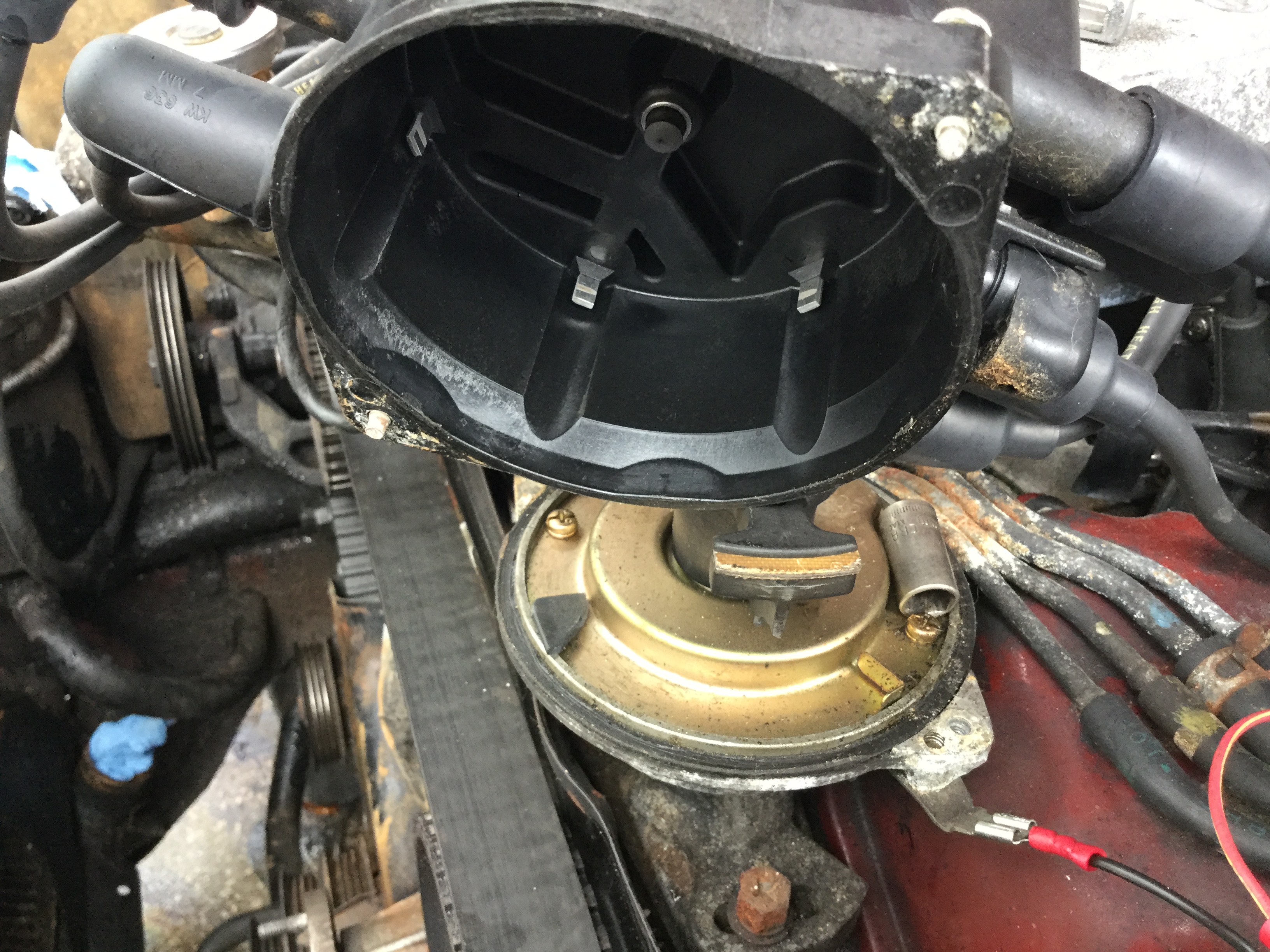

Guess what I found under my distributor cap...

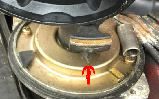

... a socket as I'm doing the timing belt, water pump service on my new $400 Z31 Turbo.  I still can't believe it didn't cause any damage to the rotor. Car did have a miss once in awhile.
The hacks that were working on her before did all kinds of wacky things so I guess I shouldn't be to surprised.
Yeah it was in there.  It look like that piece came off the cap. All new cap and rotor on the way.

I was thinking here, like it hit the socket once -

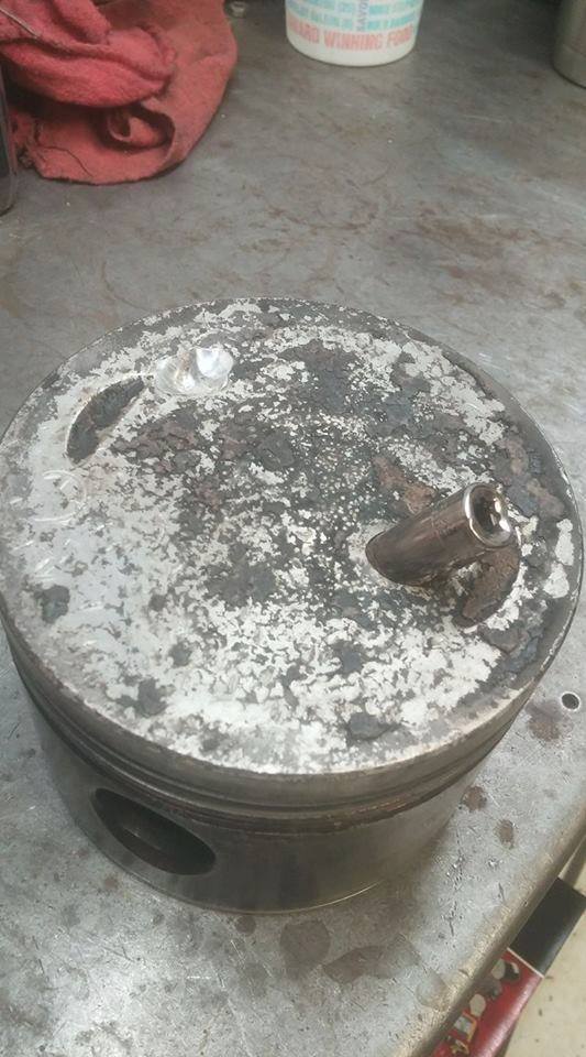

Count your blessings that you found it there and not like this.

Yeah I was nervous about the spring falling in the cyclinder. Luckily after the plug came out I was able to get it out with a magnet.
I think your right.
