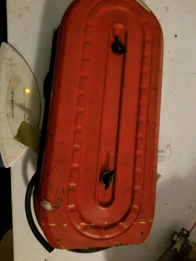

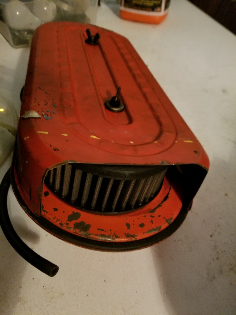

I picked up a Series 1 Blue/blue that the original owner had raced back in the day.  He was an SCCA guy and was preparing it to vintage race when he passed away.  The car came with a modified air cleaner.  Can anyone tell me the purpose?  More air flow?

You are correct! The ITS racers are very creative with modifications to gain performance. I have what is left of one in my shed that only left enough metal to cover the air filter and hold the filter.

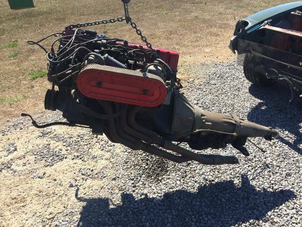

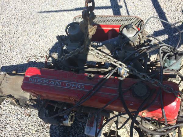

I have one that has all the horizontal housing cut out.  With a Nissan metal filter it looks like a good idea.  I can't imagine that much more air flow for my road car so I run the OEM with the summet/winter flap.

Rebello suggested a series of holes on the top of the stock housing to increase air flow. Not on the bottom where the air was hotter and perhaps dirtier. I sold that housing and the K&N filter after I moved up to triples. Those get an ITG foam filter, not an airbox because that lost me 10+ HP.
