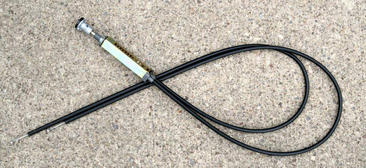

This is what the choke cable looks like, similar to Z and Roadster styles but without the swedged cable ends shown. Nissan #18410-H2302 is NLA, but cables can be found on ebay, google and elsewhere as well as discussions for adapting other cables, like here:
https://groups.google.com/forum/#!searchin/bluebird510/choke$20cable|sort:date/bluebird510/DwdAB7Wvg8M/oRTXQHs1WXkJ

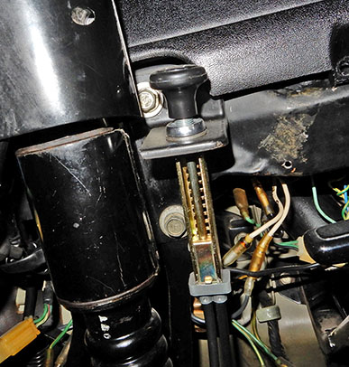

You are correct and the links are great! I already put some possibilities in my watch list. May actually go with the TR6 choke cable because it's reasonably priced. As a side note where exactly is the choke cable supposed to mount?

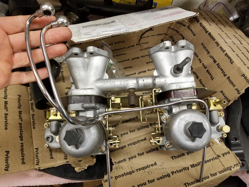

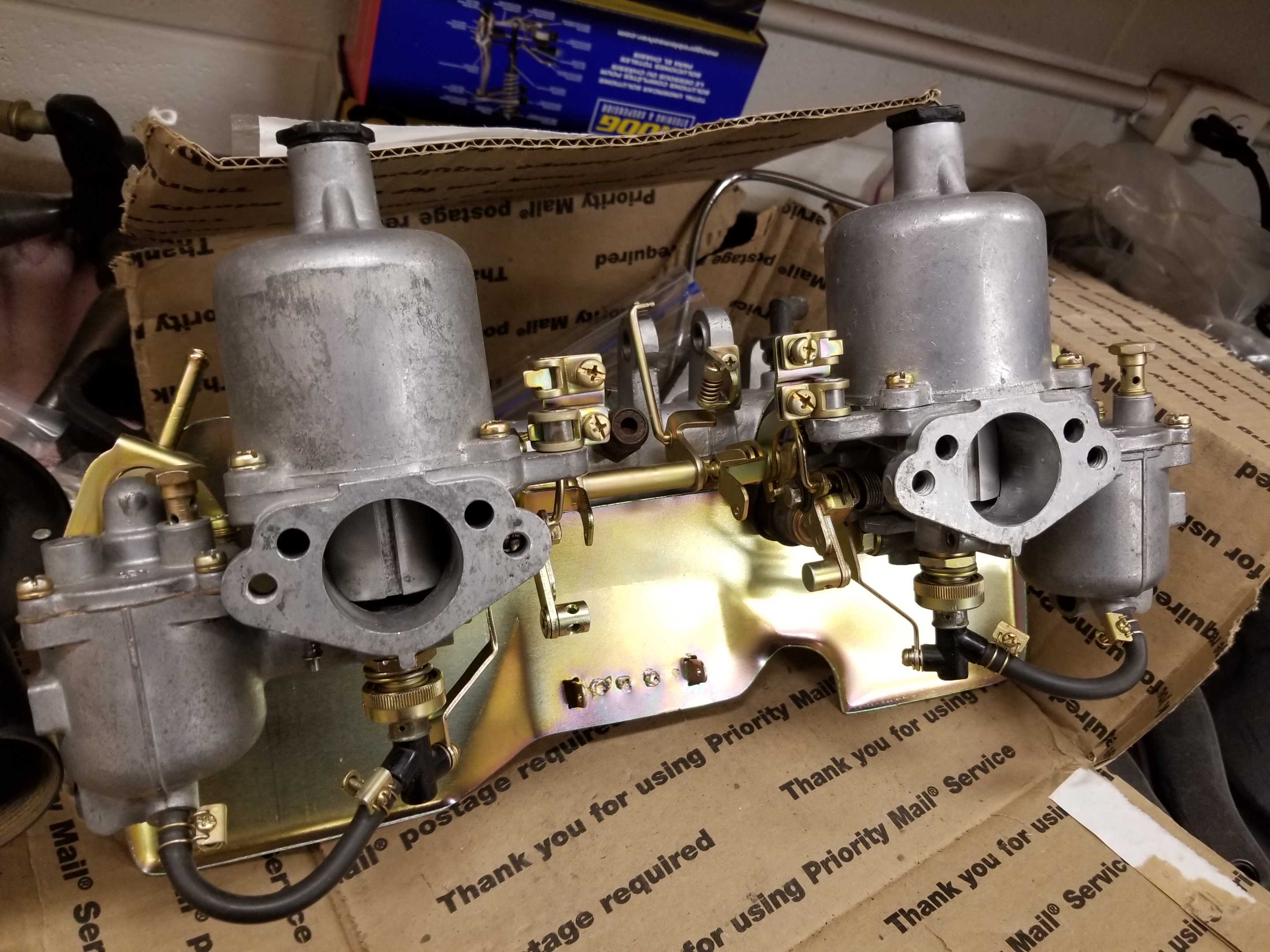

This is how they sit at the moment. Plated all the hardware and polished the overflow tubes. They will need some straightening. The buffer took them away from me  a couple of times. :blush:
Sourced the heat shield from Z therapy and a few other parts. I am still missing a few things. Throttle return springs and the hex head screws for the choke cable ends...
If I set the float heights, I think they would be ready to go on. Don't know if I have what I need for linkage...
