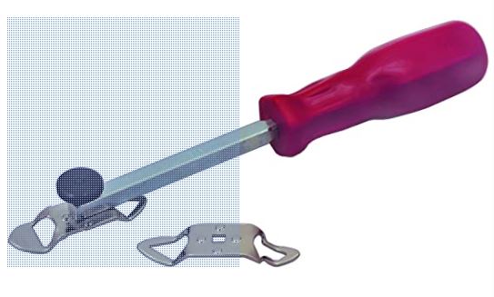

S30Driver Posted April 19, 2021 Share #199 Posted April 19, 2021 Did you start the string at the bottom and work around to the top? Did you have thee Lisle tool to put the trim in? Looks great, by the way! Link to comment https://www.classiczcars.com/topic/59089-codys-goon/?page=17#findComment-620063 Share on other sites More sharing options...
Patcon Posted April 19, 2021 Author Share #200 Posted April 19, 2021 Yes, we started in the middle bottom and finished on top near my hands in those pics. We just did the trim by hand before we set the glass. Wasn't really a problem Link to comment https://www.classiczcars.com/topic/59089-codys-goon/?page=17#findComment-620072 Share on other sites More sharing options...
S30Driver Posted April 19, 2021 Share #201 Posted April 19, 2021 Definitely the way to go with the trim installed before setting the glass in the body. That little trim tool is a great investment for under 10 bucks. Eliminates the chance of nicking or tearing the rubber seal. Glad you had no issues. Will be a big hit in Colo at Zcon if you and Cody bring it .... 2 Link to comment https://www.classiczcars.com/topic/59089-codys-goon/?page=17#findComment-620074 Share on other sites More sharing options...

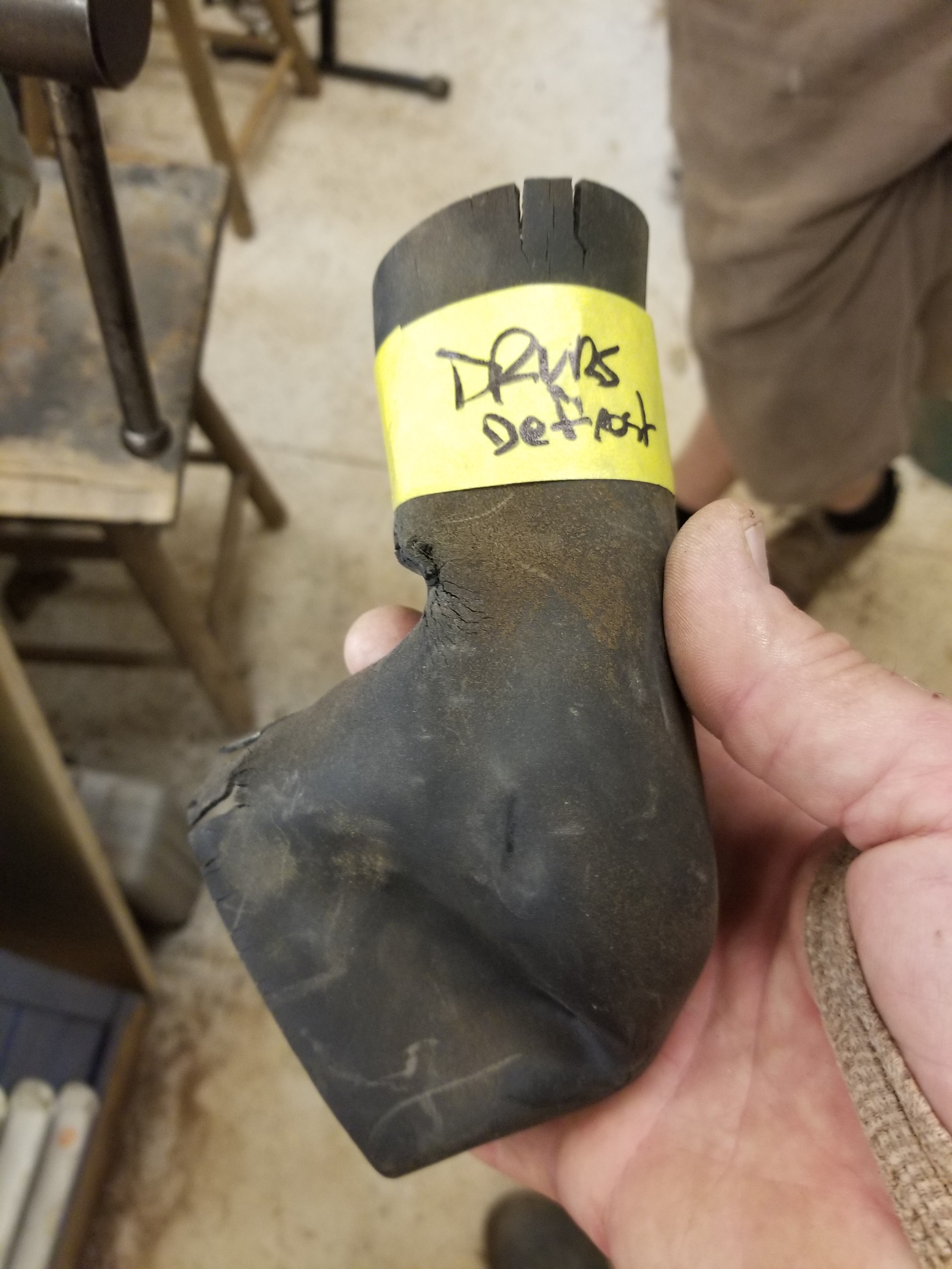

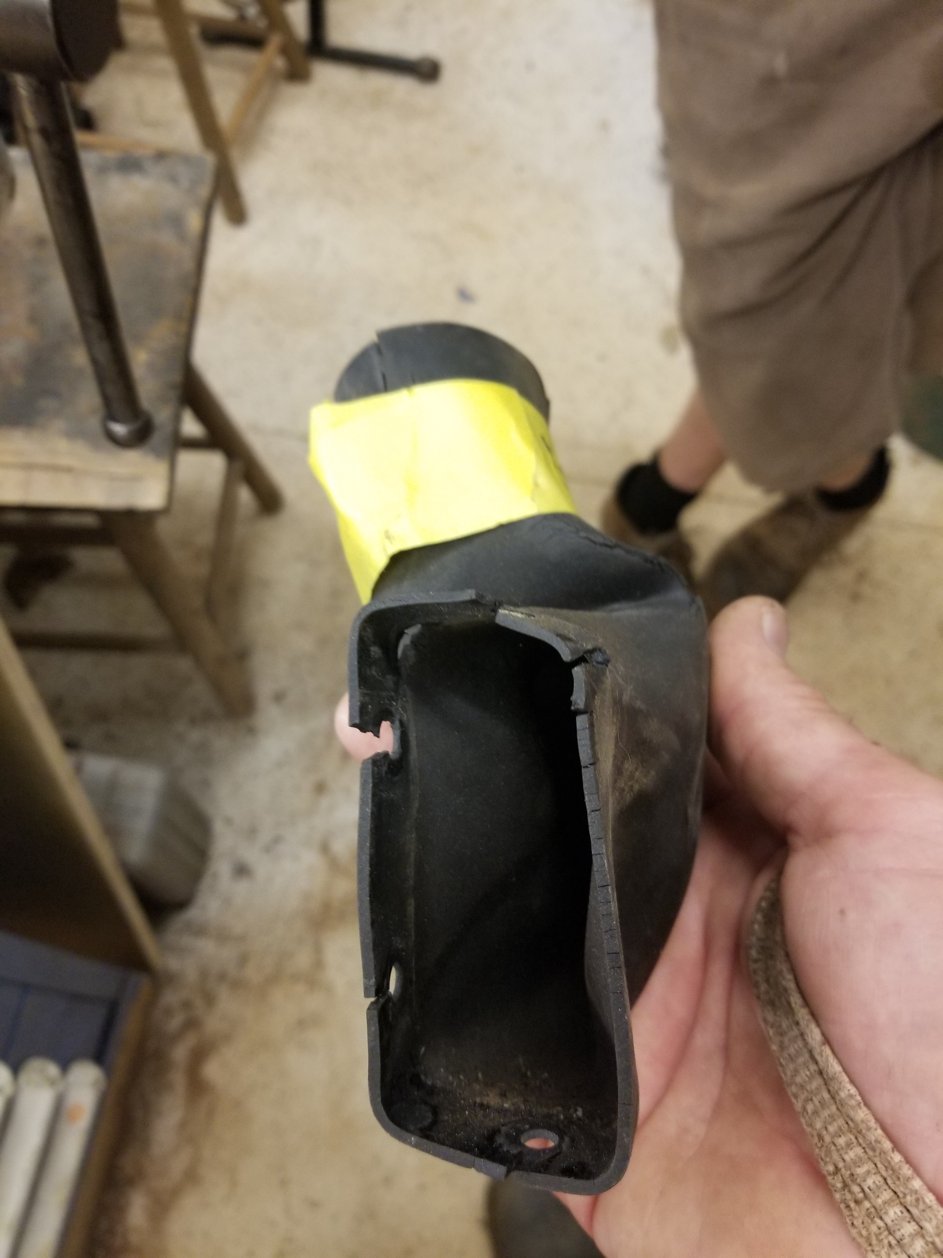

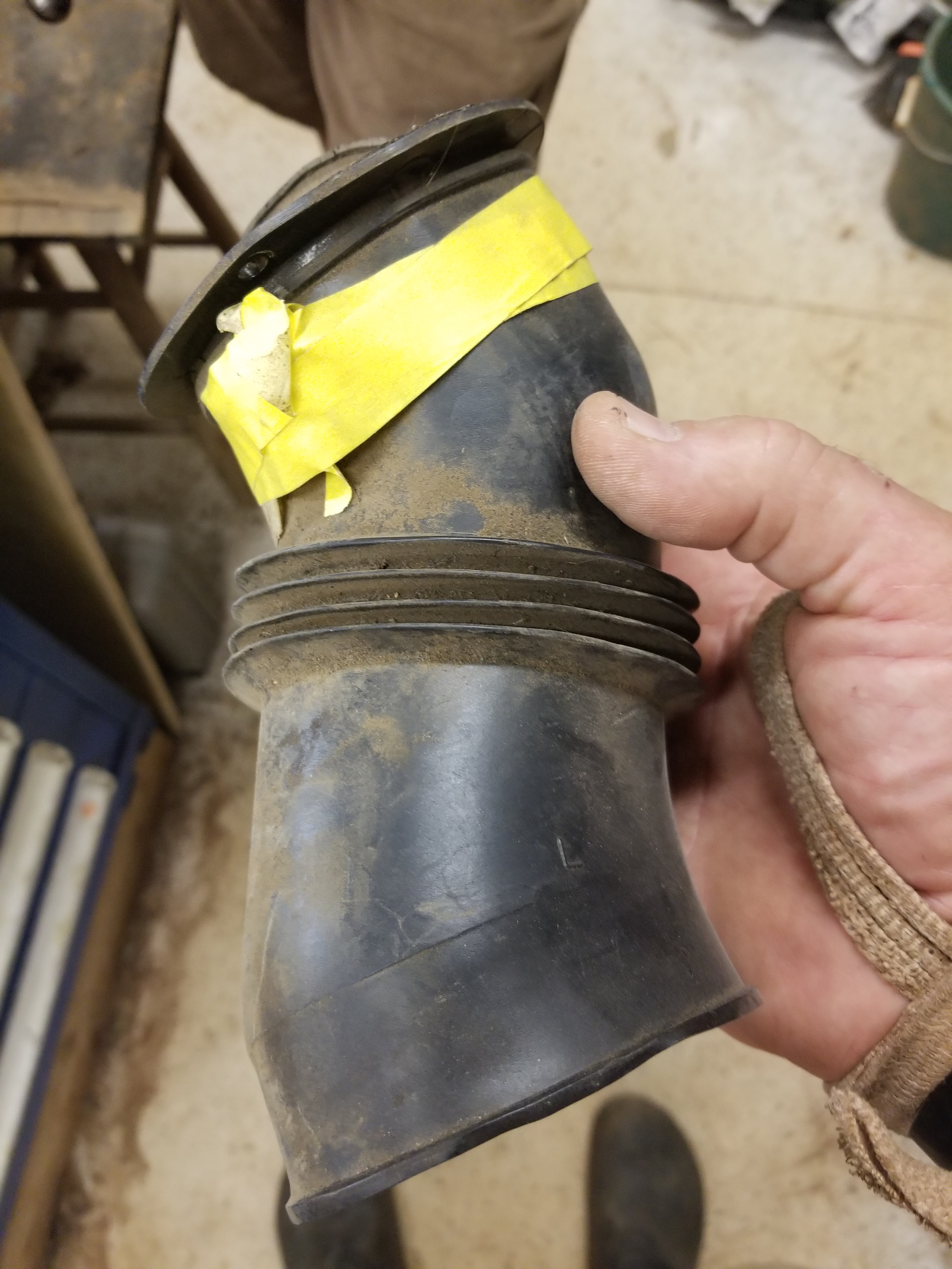

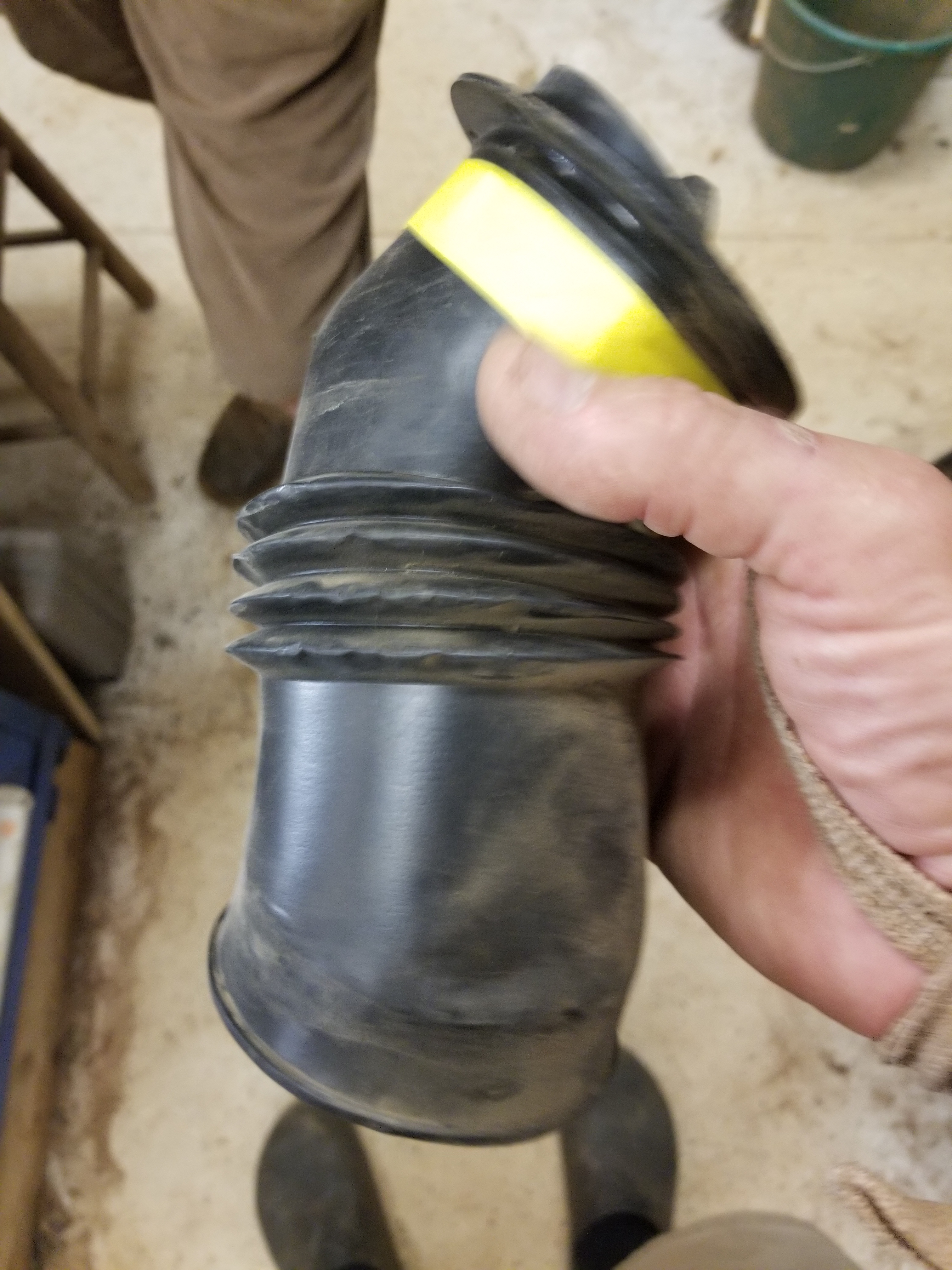

Patcon Posted July 25, 2021 Author Share #202 Posted July 25, 2021 I need to find some parts... Defrost boots Also need fresh air vents Need the inner glove box too Thanks, C Link to comment https://www.classiczcars.com/topic/59089-codys-goon/?page=17#findComment-625703 Share on other sites More sharing options...

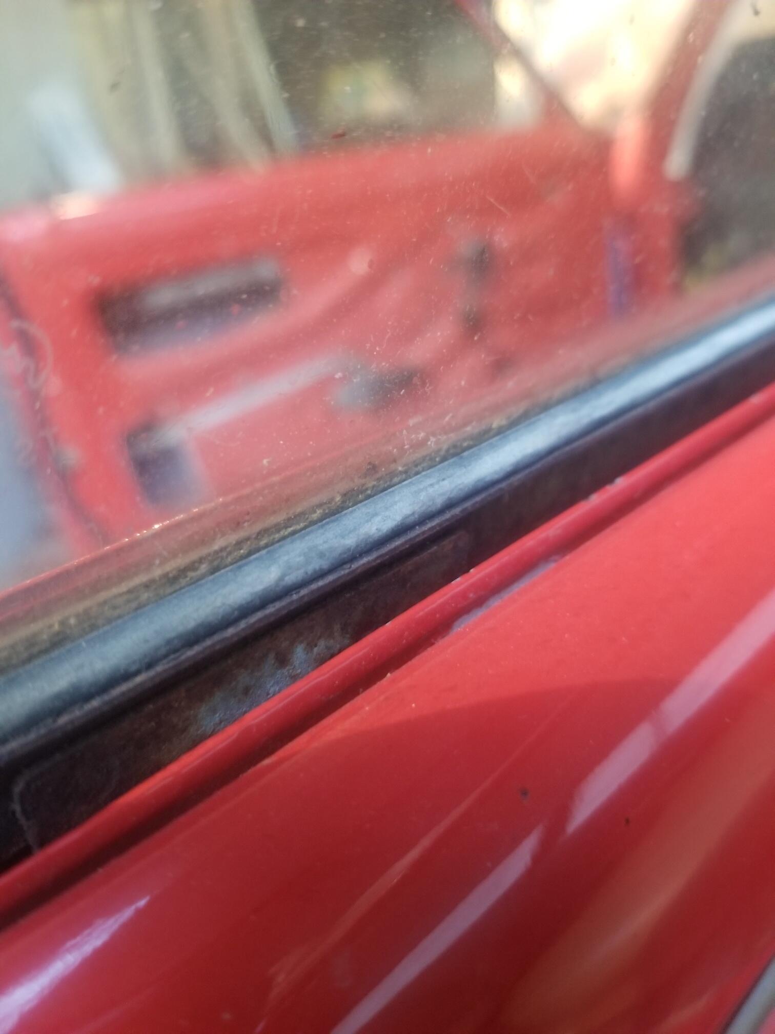

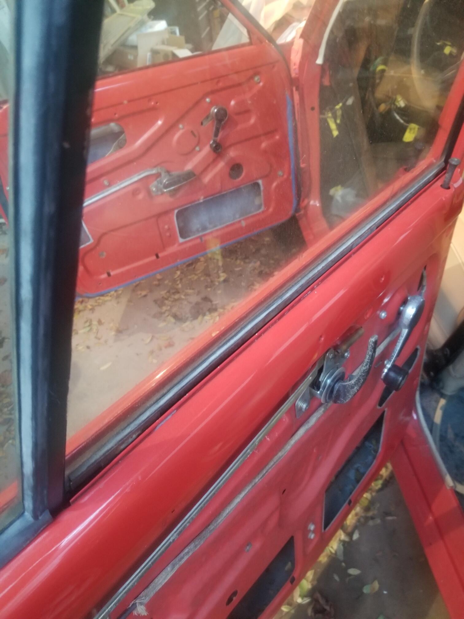

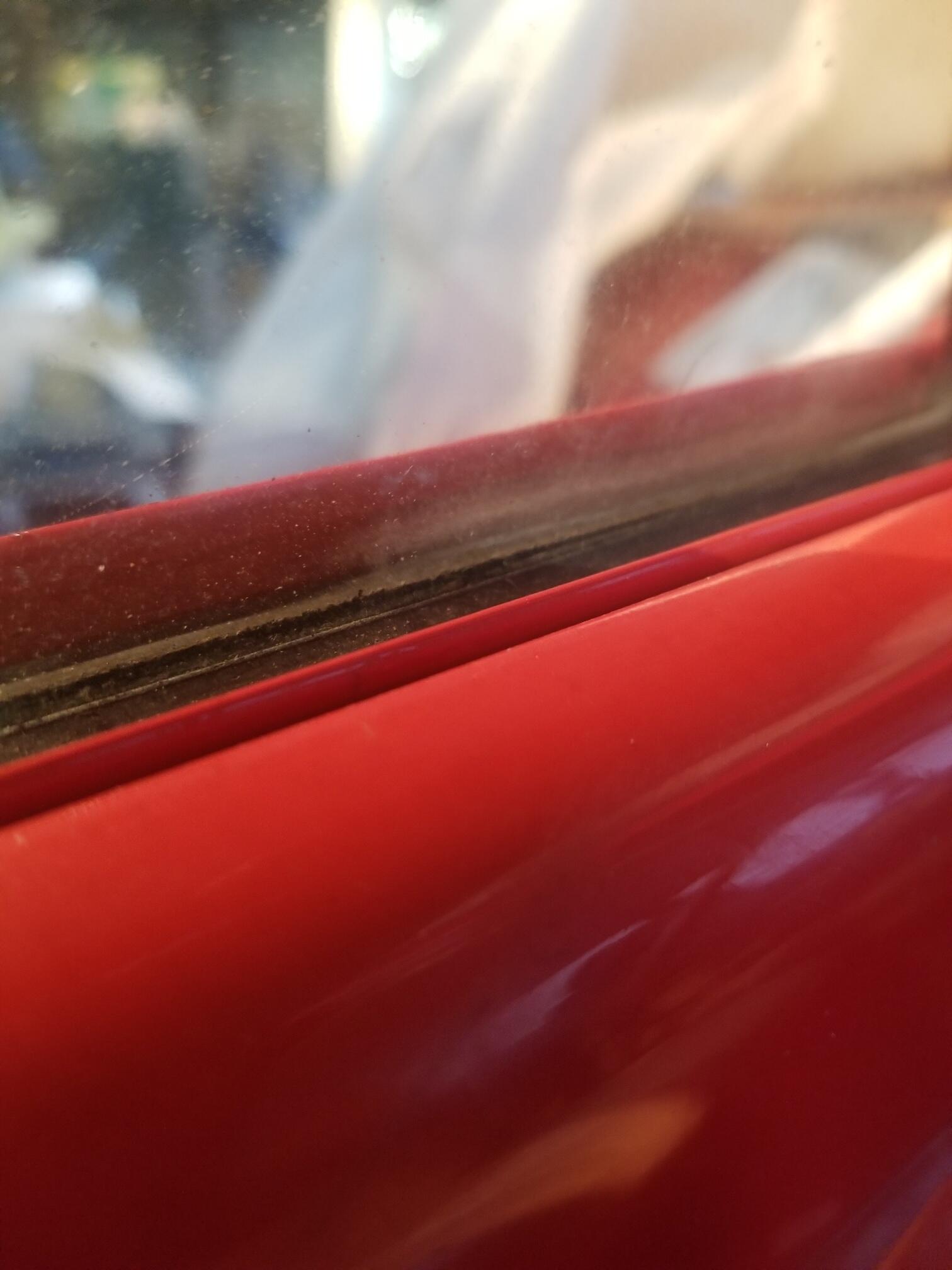

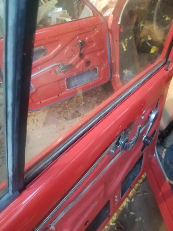

Patcon Posted November 26, 2021 Author Share #203 Posted November 26, 2021 So Cody was tinkering with his car some today. I have a question now. When the left rear window is rolled all the way up you can see the metal bracket that holds the glass. Is this correct? On the front drivers side it doesn't look like that. Left rear Front left Link to comment https://www.classiczcars.com/topic/59089-codys-goon/?page=17#findComment-632247 Share on other sites More sharing options...
grannyknot Posted November 27, 2021 Share #204 Posted November 27, 2021 Unfortunately, yes. The inside rubber wiper strip actually rides up on the window bracket when the window is rolled all the way up. You have to clean out the recess on the top of the inside door so the lip of the rubber wiper can seat in there but if you don't run a bead of cement in the recess the window bracket can lift the wiper completely out. Not great design but it was their lowest price car at the time. Link to comment https://www.classiczcars.com/topic/59089-codys-goon/?page=17#findComment-632277 Share on other sites More sharing options...
