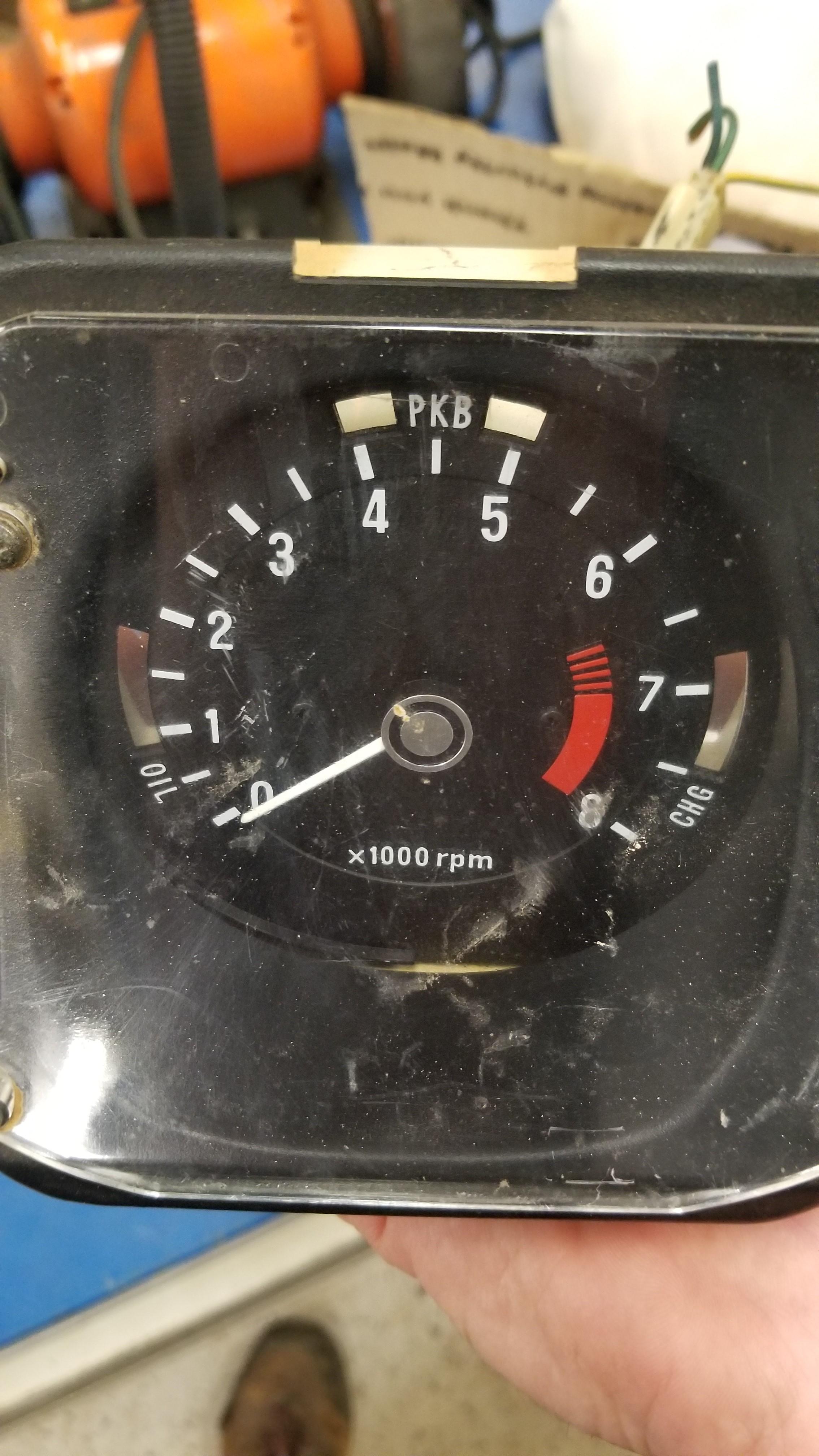

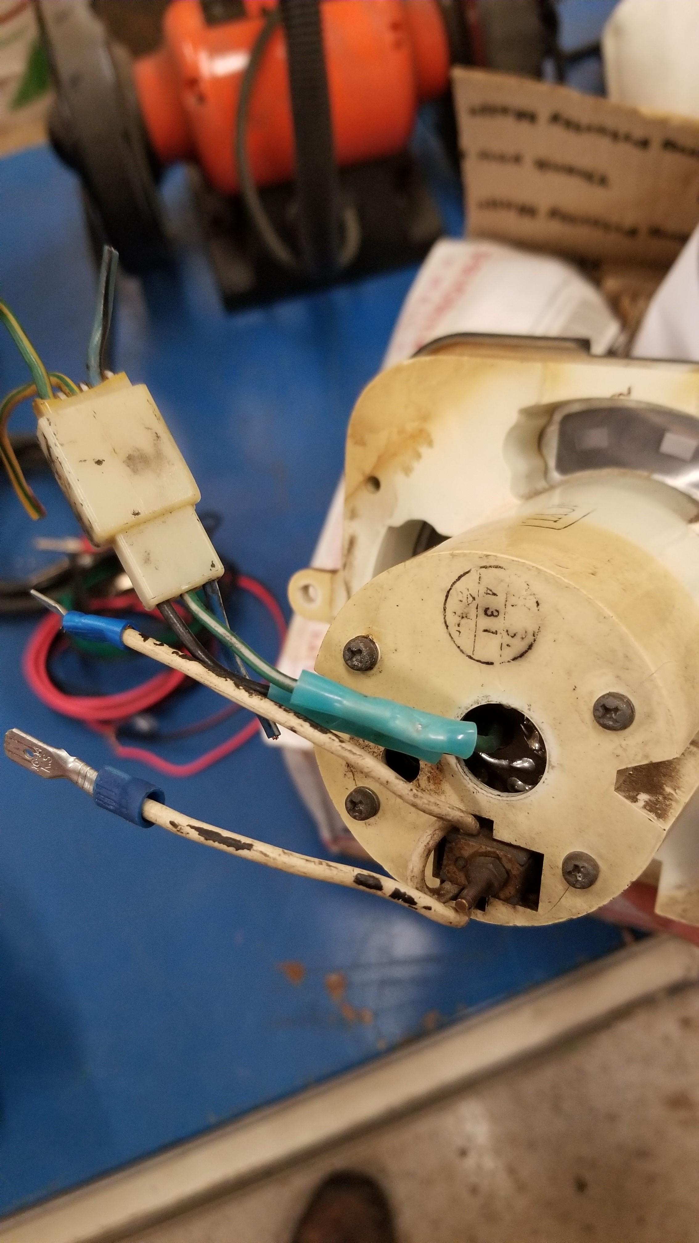

I also tried to install this tach.
I found an online article that gives a couple of ways to hook it up with a matchbox dizzy. One is inline with the coil power and the other is inline with the blue "C" wire to the match box. It also suggest reversing the connections because it is polarity sensitive. I tried all 4 ways and couldn't get any needle movement. I checked resistance on the inductive loop and got something like 0.3 Ohms and it also rings when tested for continuity. Any ideas on where to go from here? The black from the gauge was connected to the Neg on the battery and the green was touched to the Pos on the battery. I bought this off Craigslist so it has an unknown history.
That inductive loop is just that... A single loop of standard wire. It should read as a direct short on the meter.
Can you point me towards the on-line article you were using for connection wiring? I've never messed with one of those tachs, but I might be able to come up with something. Are the wire colors the same as the Z's that used the inductive style tach?  Nevermind that. I see they are different colors.
Do you know what the third (blue with stripe) wire is supposed to be for? Is that for illumination?
So that sounds like my loop measurements are correct. The crimps on the gauge make me wonder if they're good
Here is the link
http://elfecc.no-ip.info/510/Tachometer/Simplified_Tach_Hookup.htm
Yes, the loop measurements are correct.
So... Does the meter draw any current at all on the power lines? Try connecting it with an Ammeter in series with the meter. Like this:
Set your Ammeter for the 1A scale.
Battery positive to Ammeter positive.
Ammeter negative to gauge positive (gauge G/W).
Gauge negative (black) to battery negative.
If you don't see anything on the 1A scale, knock the scale down a click and see what happens?
If it's dead open, it won't draw anything at all. Like 0.0
Another thought would be to watch the needle when you first connect power to the tach. Does the needle bump at all? In similar devices, sometimes you'll see the needle bump a tiny bit when power is initially applied.
I will see if I can set up an ammeter measurement with what I have.
I watched the needle, it never moved in any of the 4 configurations

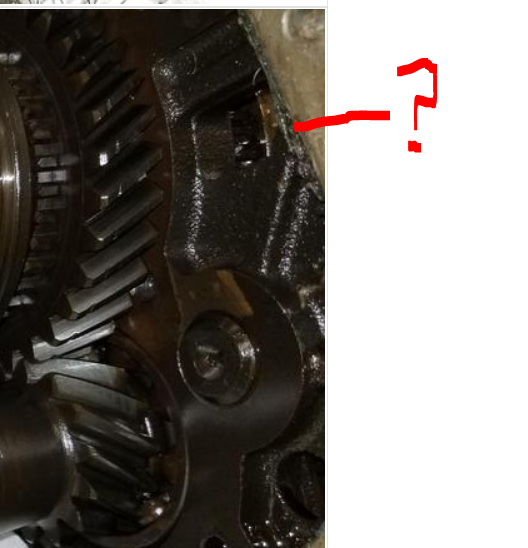

There is this long gutter in the rear case
Is there supposed to be a short gutter in the main mounting plate? This is a 280ZX transmission. I don't know the exact year. Is there supposed to be a gasket at either of the mating surfaces. There was only sealant at both transmission halves.

There should be a gutter sticking out of the adapter plate.  Might be broke off.  Is it stuck to the drain magnet?  Here's 1982.
