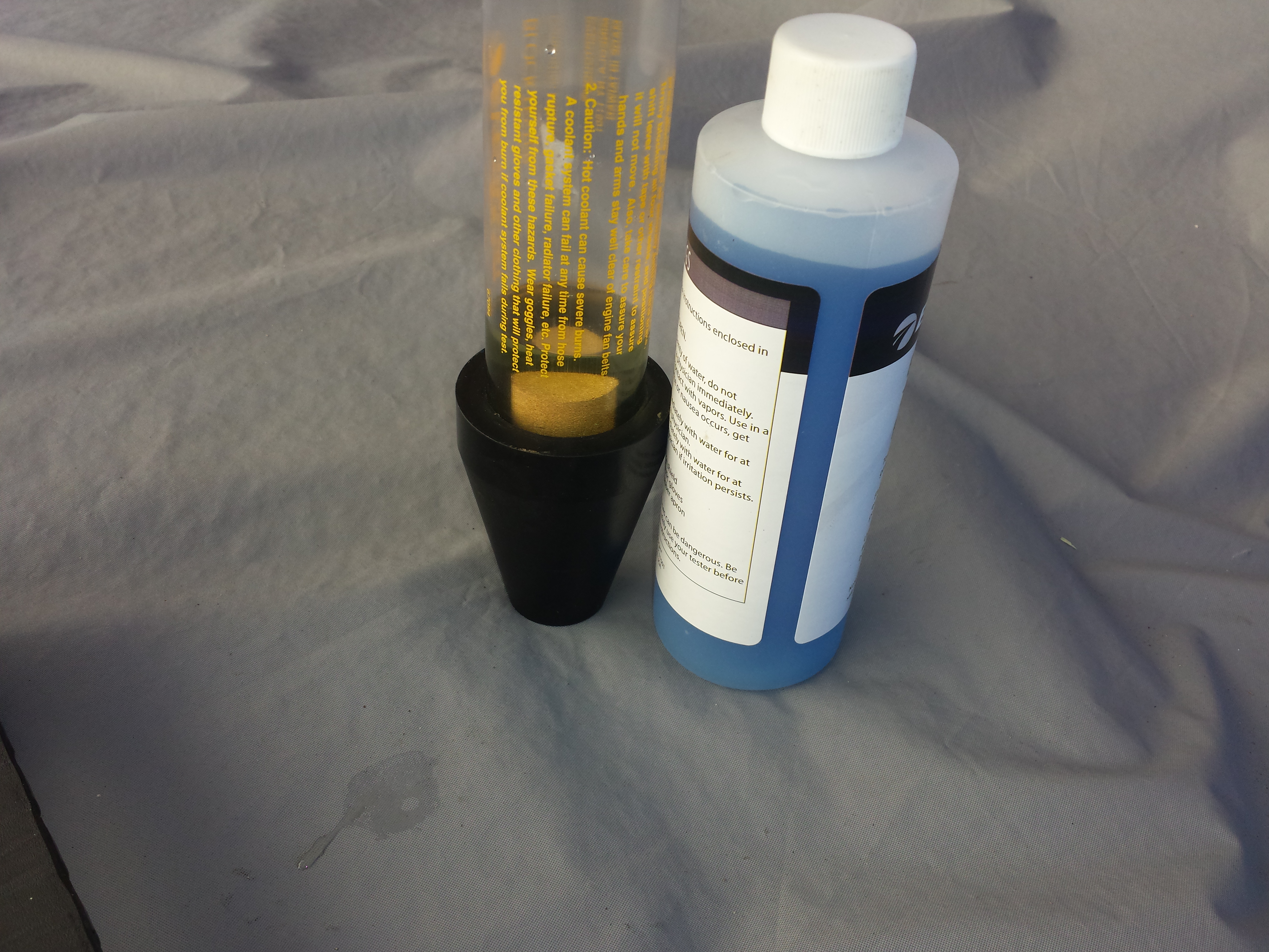

Radiator got checked by a local shop...get a clean bill of health, tried the block test...sure enough turned yellow in aprox 20 seconds of hot running.
I guess sitting for 20 years didnt do the hg any good.

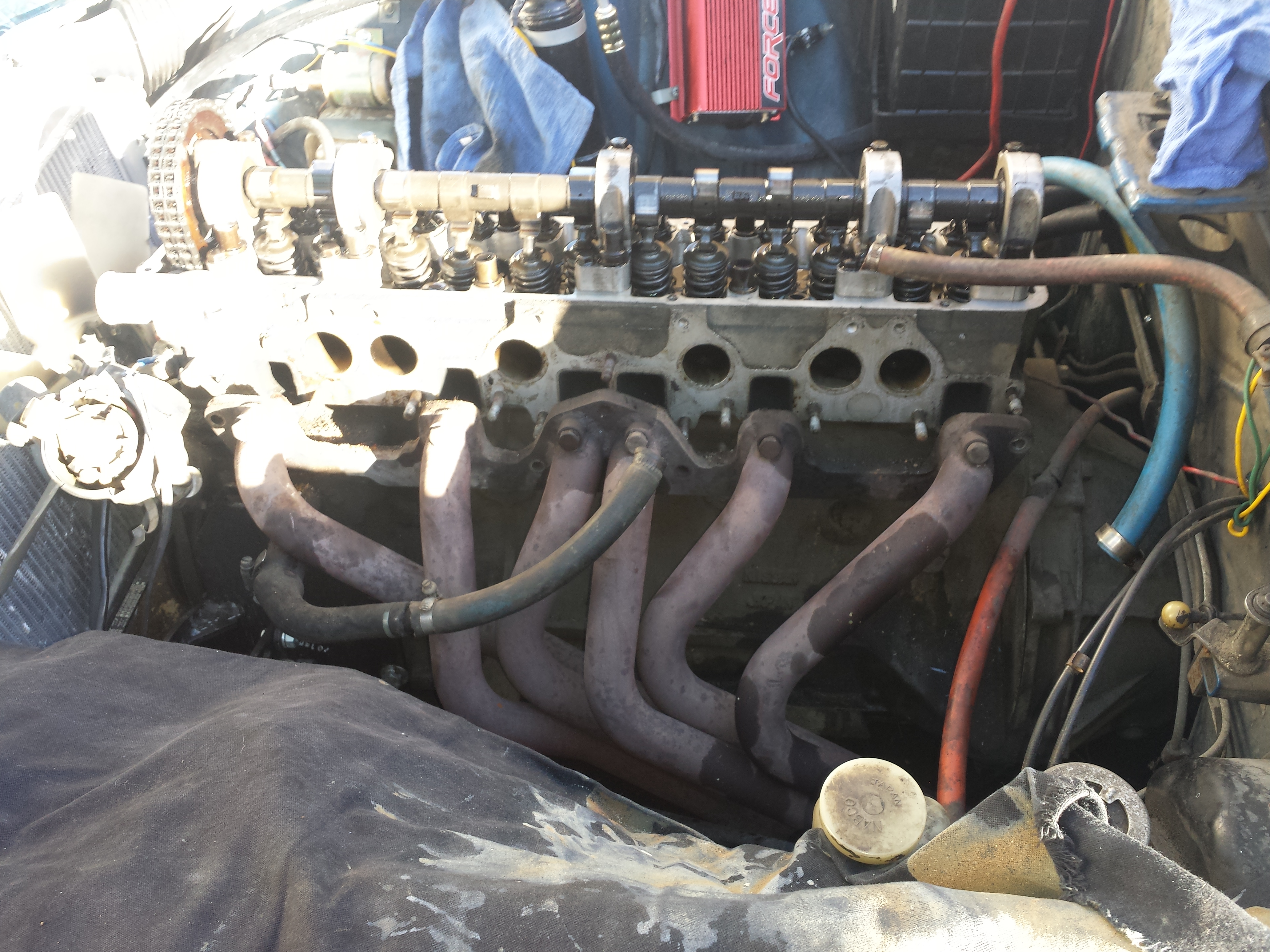

Update: pulled off the head, found the gasket to without flaw, took the head (E31 BTW) to the machine shop to be resurfaced, got it back and was told they had to take 8 thau off...question is do I need shims?, the history of the head is kinda unknown, I remember getting it at pick and pull (it was ported and polished already) but I don't know if it was resurfaced in the past.
If you don’t know how much them what shims would you use. You could measure the head thickness and figure from there- but I wouldn’t bother . I’m running .050 cut on my 31 with no shims , but cam gear advanced and chain guide adjusted .
