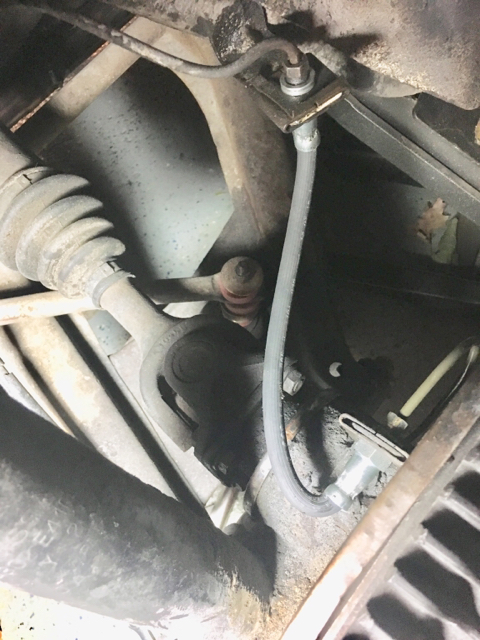

I replaced the rear line with oem but the new line is gonna get ruptured as well. After a short test drive I discovered the line is rubbing against the rotating drive shaft (hope I identified it correctly). Am I missing a part or a longer line is needed? Thanks

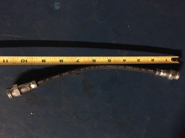

Just bought these off Motorsport (rears). I guess longer braided lines it is and orient them away from moving part if possible. Thanks

The stock rubber lines are longer on the rear than on the fronts, maybe you got a set of fronts by accident.
Maybe.. though measured about 11 inches

Looks to me like somebody put parts on the wrong sides.  Probably wheel cylinders, and/or hard lines.  The hydraulic hose should have only a smooth 90 degree curve, not a 90 then the 180 that your picture shows.  The hose is entering its second connection from the wrong direction.

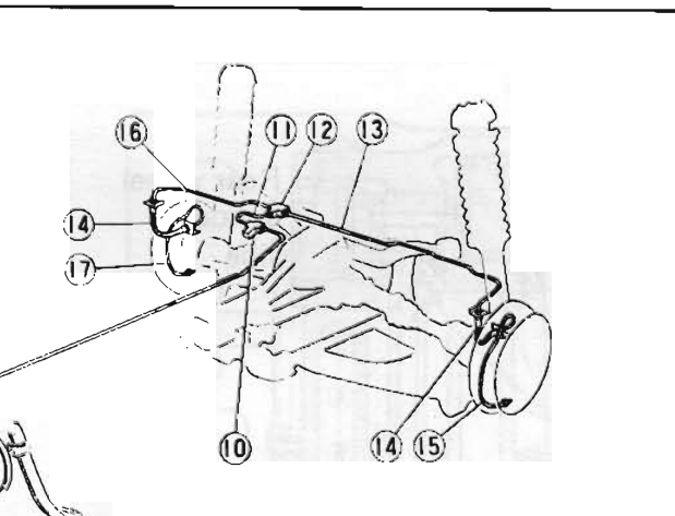

Just guessing, based on the FSM diagram and your problem.  11" is the long hose.  I remember your problem from the last time.

You are correct. I will try correcting it by reversing the hardline. Can it be twisted with no issue?
