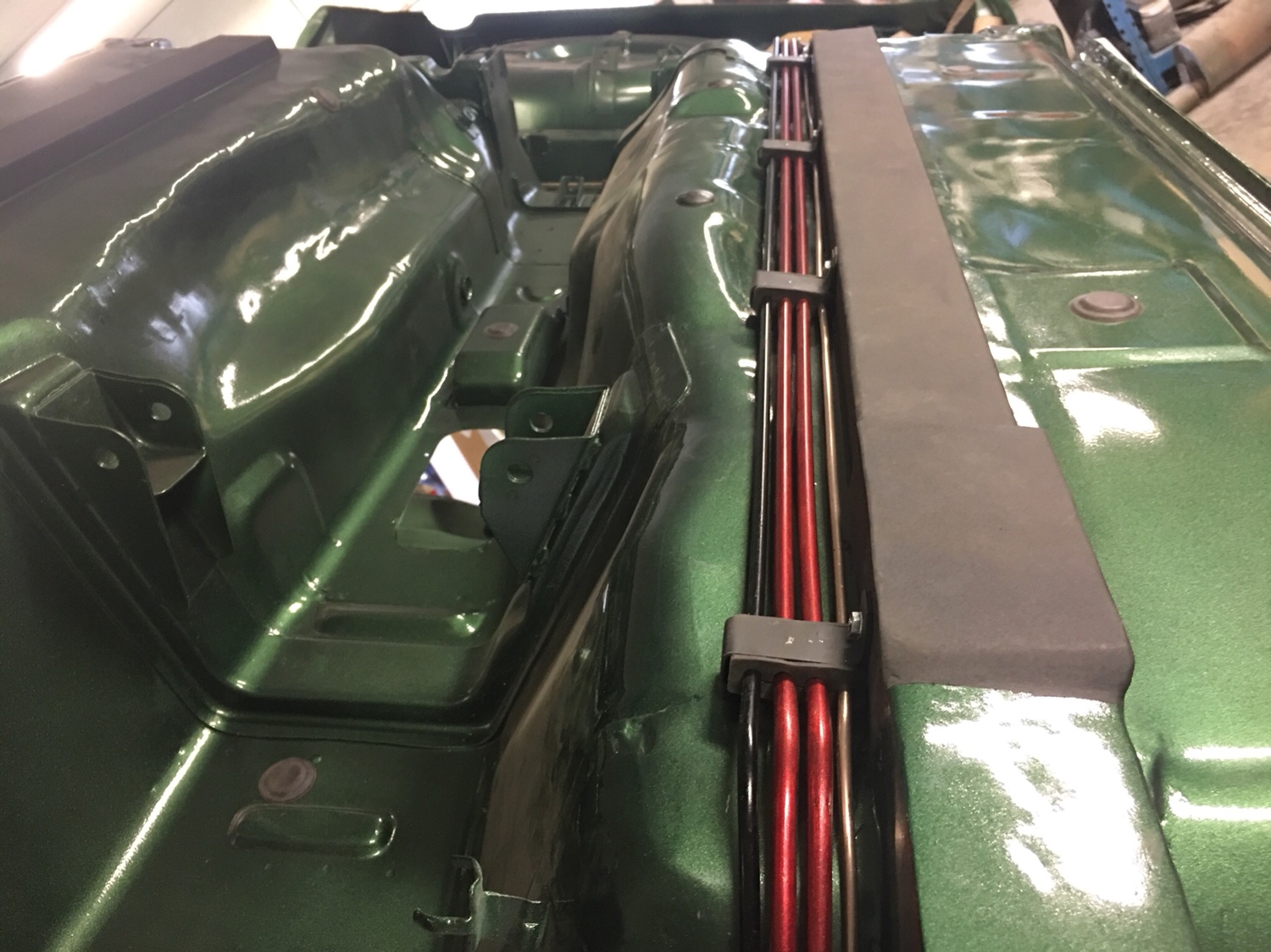

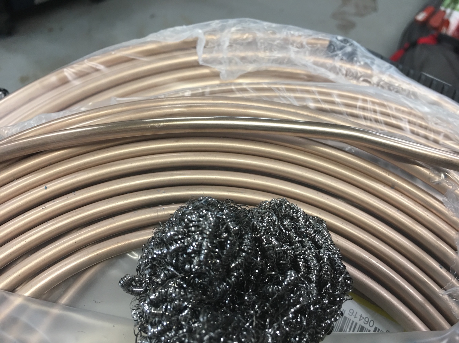

3 hours ago, wheee! said:
Cunifer lines. Make em yourself with the Eastwood flare tool and be done. No need for stainless lines. And flex lines would be awkward.
Painted finished lines.
+1
