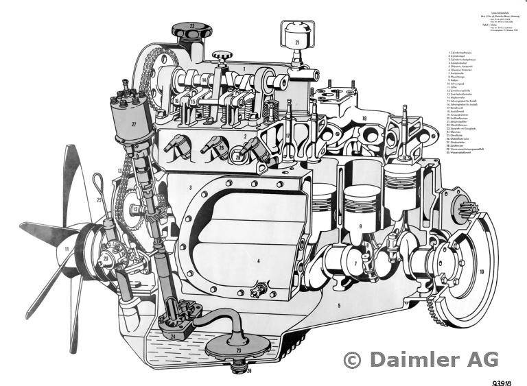

Guess what these are and from what engine?
There is enough evidence in the similarity of the parts alone to convince anyone of a strong relationship between the two.  It is not convergent evolution.
It also happened before the Prince merger so the design could not have been acquired via that path.
Finally the strong or loose interpretation of the Nostalgic Hero article seems to seal the matter.  If I had the magazine article I could get a friend in Osaka to translate it to get a clearer picture however,  I have faith in Carl's research.
Bottom line is that the L engines have a strong resemblance to the Mercedes M-180 engine. I think this is a good thing!

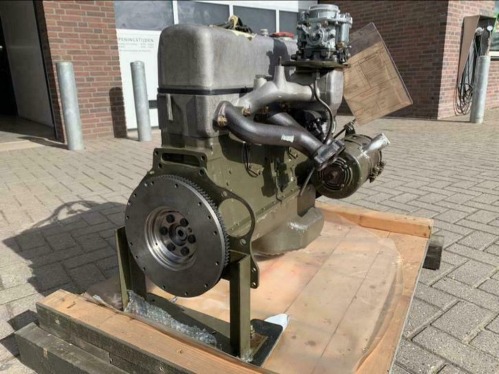

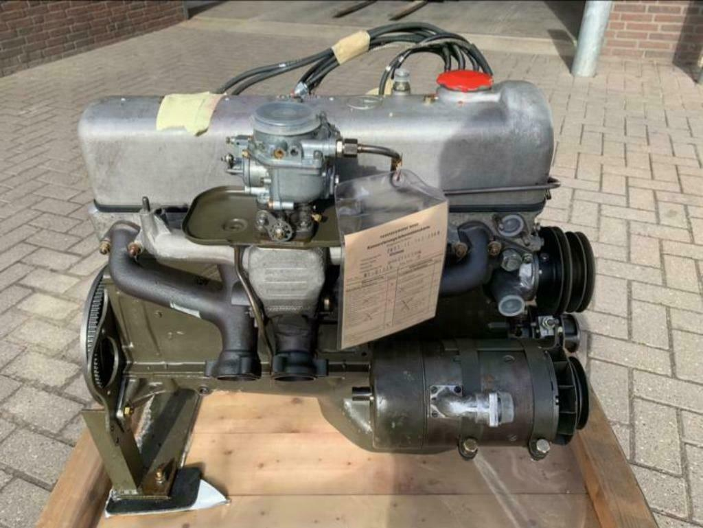

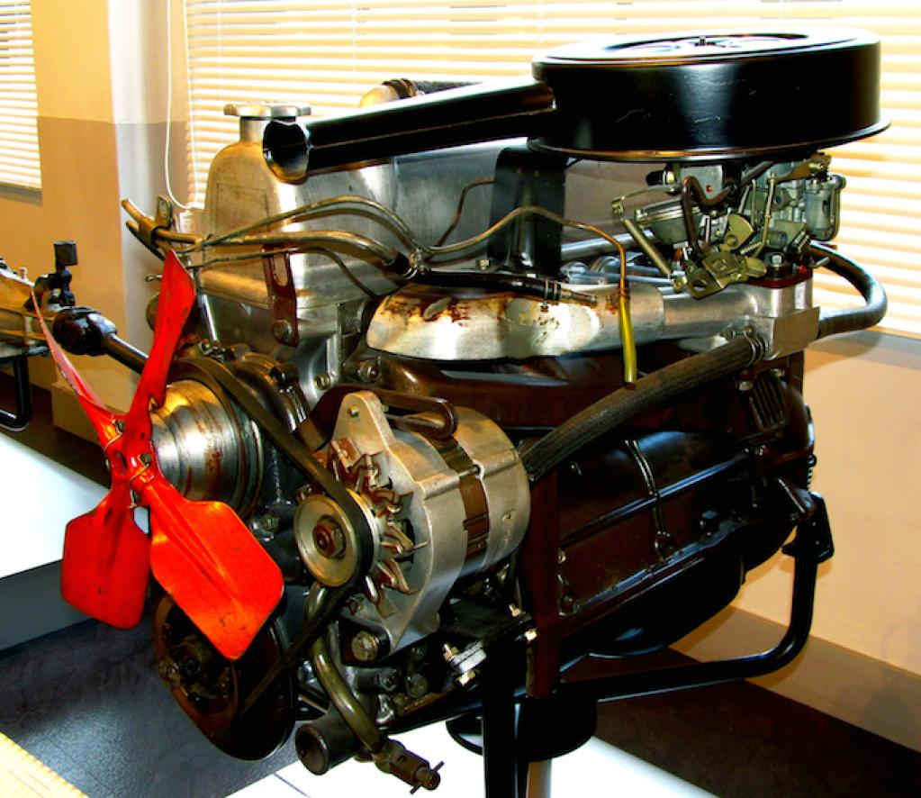

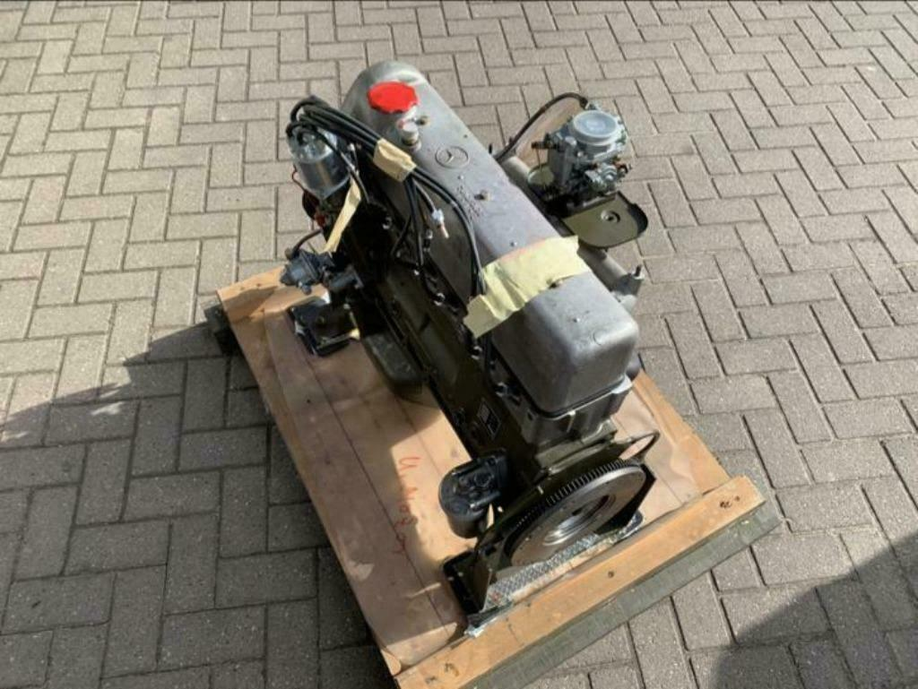

What's not being discussed here is the big layout difference. The Mercedes M180 engine was conceived and designed primarily for use in LHD vehicles, whilst the Nissan L-gata range was conceived and designed primarily for use in RHD vehicles.
Mercedes M-180 for LHD.  The L-gata head is same non-cross flow and basically mirrored. Not a big change.  The alternator and starter are even on the same side.
The M180 also has the shared intake/exhaust manifold fastener design and coolant entry location.
M180 distributor is in the same location. Oil filter location was flipped to other side on the L-gatta and moved forward as a starter was on the mirrored location.
Even the same inline Distributor, Spindle, Oil Pump configuration with worm gear drive.

Except that the starter position for the first L20 six was on the left side of the engine.
Except the thermostat housing/top radiator hose on the first L20 six, and even on the early L20A, was in the middle of the 'head on the left hand side.
Fuel pump location/drive is also different.
Except the drive for the distributor/oil pump jackshaft on the M180 is not taken direct from the crank snout as it was on the L-gata.
I think there's a certain amount of confirmatory bias at play here. Yes, the cam towers, finger cam followers, follower pivots & springs, oil spray bar etc are very similar and there are close cribs of details to do with the distributor/oil pump jackshaft, but there are also numerous differences both large and small. The Nissan L-gata is not a direct copy of the M180, is it?

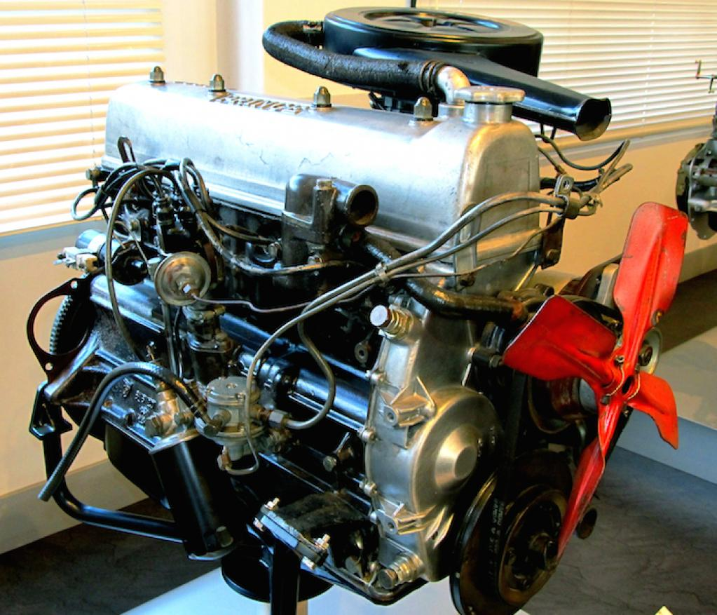

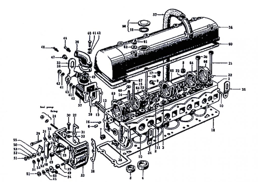

From a reputable Motorsports Magazine:
As an aside, Nissan's development team in the first half of the 1960s eagerly studied German engines. In the same way as for the Prince, the former preferred Mercedes and the latter preferred BMW. Of course, the L type uses the counter flow method learned from the Mercedes type. It can be said that the good productivity is reflected in the original design of Nissan. On the other hand, what I learned from BMW seems to have been reflected in the G engine.
L20 Head
Edited by 240260280

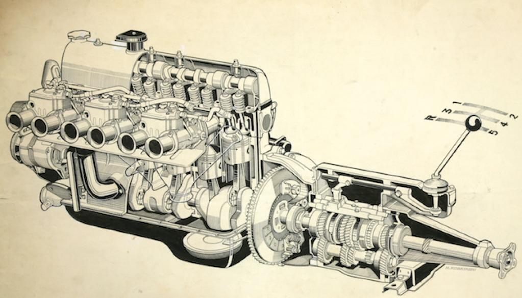

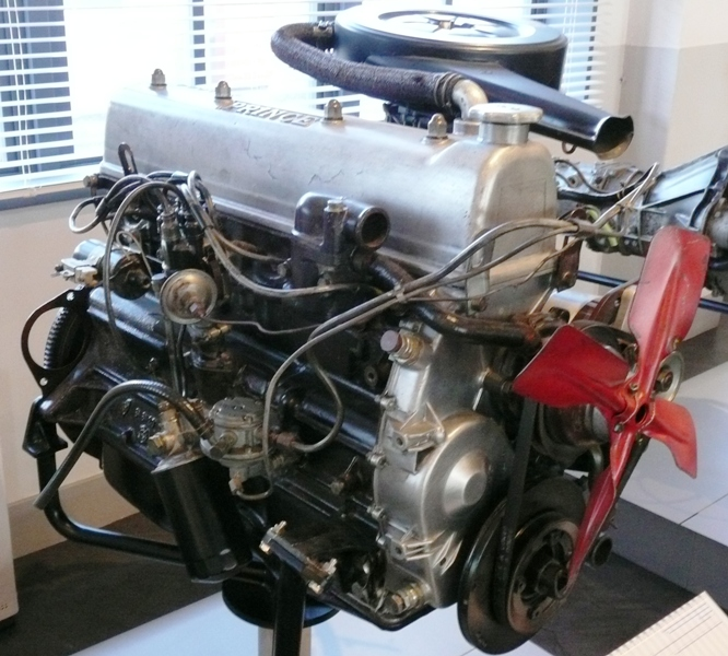

L20 A Head
That's an L20, not an L20A.
35 minutes ago, HS30-H said:
That's a 1965 G7B.
Thanks for the corrections.  I did some further checks and it seems the G7B has a crossflow head?
The drawing above only shows the outline of the "invisible" exhaust manifold (you really have to look for it)  on the left side of the head below the intake; so the above drawing seems to be the earlier G7 without crossflow?
