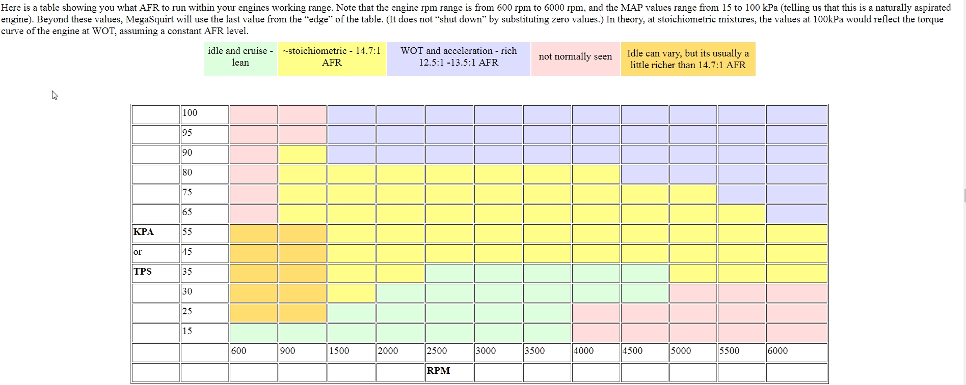

Chickenman Posted December 17, 2017 Share #10 Posted December 17, 2017 (edited) Batch fire requires a slightly richer idle than sequential. 13.8 to 14.0 for a stock Cam. Cams with more overlap require a richer Mixture yet 13.5 range usually works well. Bigger cams also require more ignition timing at idle. This is due to the EGR caused by the larger overlap. EGR contaminates the idle mixture with exhaust gases and the Air/Fuel mix burns slower. So more timing required. Cruise AFR's leaner than 15.0 can be difficult unless you have a very strong ignition system. ( Edit The stock 280Z Trignition Boxes are too weak to run that lean. You need big spark gaps and lots of current. The 280ZX matchbox distributor is very good on Normally Aspirated engines. With that and plugs gaps of around .042" to .045" you can run 15.0 or leaner at cruise. 16.0 to 1 at Cruise will normally require a CDI ignition Box such as Fast ( Crane Fireball H_6 ) or MSD digital 6. I do not like recommending MSD 6AL boxes ( Analog box ) due to reliability issues. MSD = My Spark Disappeared This chart from MS is not bad as a reference point. Obviously for Normally Apirated only. I like to run the 1500 rpm's a bit richer than Stoich, as it helps with light throttle transitions ( Tip-in ) Scott Clarke has a You Tube video on Tuning Acceleration Transitions . So does Andy Wyatt from Adaptronics and Andy Whittle at MS . Both Andy's have excellent Tuning channels on You Tube. Edited December 17, 2017 by Chickenman Link to comment https://www.classiczcars.com/topic/59177-af-ratio-for-l28/#findComment-537653 Share on other sites More sharing options...
