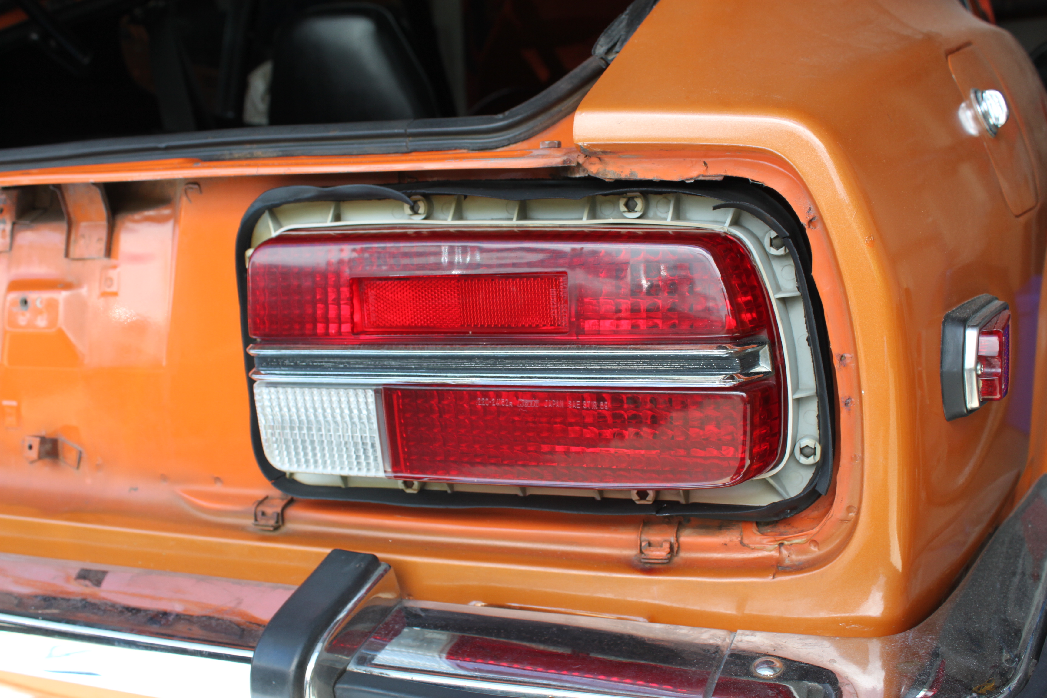

For reference here is a picture that shows the clips and brackets for the tail light finisher/surrounds from when I painted mine.  I think the clip (item 8 that @siteunseen mentioned) attaches to the bracket that is spot welded to the body if I remember correctly.

 Do you need all four clips? I have a late 71 that I can remove the clips from. Looks like there are two spot welds per clip to be drilled out for removal. Let me know.
