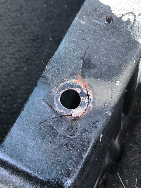

I took the seat out and found a couple of things. The seat frame is cracked on the right side of the seat bottom. Also, the mounting area on the car for the left rear mounting bolt is broken through, allowing the left rear of the seat to sag back. There maybe other issues I’ll find once I remove the upholstery completely. My mechanic is going to weld the seat frame and add some 1/8” plates on all four mounting brackets on the frame to make sure it’s all solid.IMG_6980.JPG

Wow.   Should be back to normal & solid when you get the welding completed.
I wonder what caused that floor mount to crack.

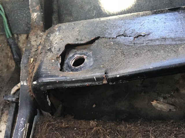

I don’t know. The left front mounting area is also cracked. Not as bad as the rear but still…IMG_6979.JPG

7 hours ago, Patcon said:
The front is likely cracked from the rear being broken. The flexing broke the front right around the washer. The back looks broken from heavy people dropping into the seat repeatedly.
Yeah, I probably qualify as "heavy people" and I probably haven't helped it the past couple of weeks. Will report back once we try reinforcing things. Looking forward to driving it with proper back support.
