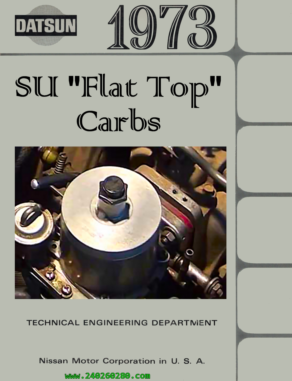

Thanks to @Lumens for providing the 1973 Nissan TSB's!
The TSB's include interesting flat top Carb info presented below.  The great Flat Top expert and car restorer @Zup may enjoy these!-image.png-
1973 Flat Top Carb Info from TSB.pdf

Thanks so much Philip @240260280 and @Lumens----but really, I still have so much to learn.
I've understood about half of the TSB. It is a loooooong step by step with no shortcuts allowed--quite different from the earlier Hitachi carbs.
The many adjustments required are probably responsible for the maligned reputation as " boat anchors"
As you know, I have gotten the flat tops running fairly well.
Now--- I know that the fuel nozzles are currently nowhere near the correct setting of .118---one is at .074 and the other at .051---just waiting to do a removal and adjustment as they are internal to the carb and cannot be adjusted while installed. I think once that is done they will really show some performance.
